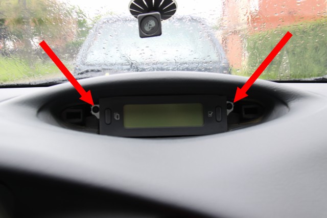

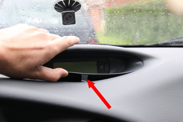

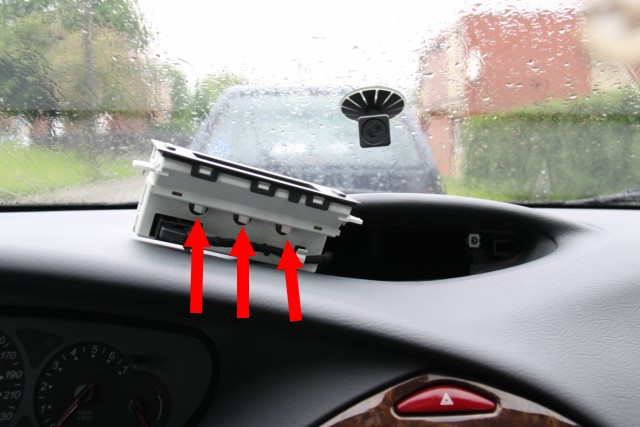

Re: C5 info screen lighting
Unread post by Clogzz »
2002 C5 2.0i AL4 240,000 km 76372389
Unread post by hirsty »
Thanks clogzz that's brilliant. :-D :-D Now let's see if I can do it without breaking anything. :shock: :shock:

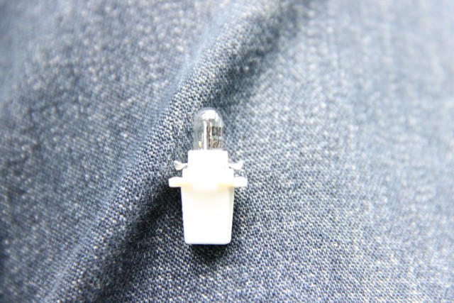

SaabC5
Posts: 765
Joined: 01 Aug 2011, 23:18
x 1
Unread post by SaabC5 »
Could be the track on the pcb has got a break in it. Mine failed one by one, when i got down to 1 one bulb i changed all 3.
Unread post by Peter.N. »
Those twist fit lamp holders are notorious for not making good contact, give the PCB tracks a good clean.
