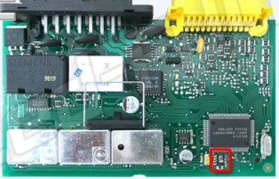

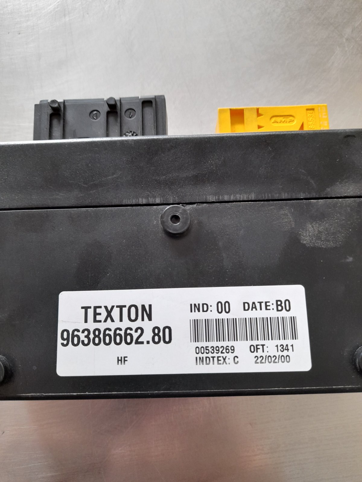

The box in the picture is the CPH unit they are coded & locked to one car, if you use a second hand one the car will not start. If you want to use second hand you would need a matching set of engine ECU, CPH & key transponder chip.

The make the replacement CPH to work you need to have a soldering skills and remove the chip that stores the code from the original CPH to the replacement one, I did it and it works. If you can send a picture of the CPH PCB ( component side ) I'll try to recall the chip and point out in the picture. It is a small chip ( as long as I remember ) 8 pins.
Hope this helps

Re: Xantia II -The interior door open light blinks
Yes this is the one
