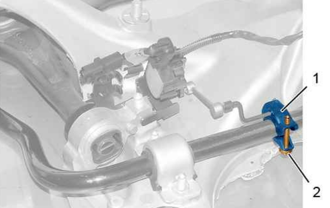

Re: C5 Mk3 58 plate Exclusive Hydractive Suspension height
Note: This is for the 4 Cylinder engine C5 X7s, not the V6 Engines
Procedure: As always, never get under the car when undertaking any work on the suspension system unless it is fully supported - especially so when adjusting height correctors (danger of crushing).
1 Tools A Diagnostic Tool (Diagbox)
CAUTION: Do not switch off the ignition during the checking and adjusting operations.
2 Preliminary operations
Wheel radiuses R:
"Z2" : Measuring zone under the rear axle crossmember.
3.1 Check: Front height
Measure:
Compare this calculated height with the reference height.
N.B.: Reference height (front) : 160 ± 6 mm.
Pre-adjust the front height if (K1 + K1')/2 is greater than 190 mm or less than 130 mm (Section 4).
3.2 Check: Rear height
Measure:
N.B. : Reference height (rear) : 106 ± 6 mm.
Pre-adjust the rear height if (K2 + K2')/2 is greater than 140 mm or less than 80 mm (Section 4)
4 Pre-setting the heights
4.1. Pre-adjusting the front height
Slacken the fixing bolt (2).
Slightly rotate the collar (1) on the anti-roll bar.
Wait for the correction of the vehicle’s height.
Re-tighten : The securing bolt (2) ; Tighten to 0,6 daN.m.
Do a new check of the front height :

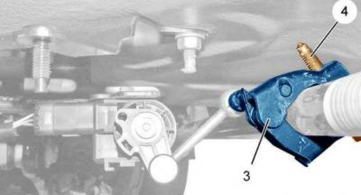

Slacken the fixing bolt (4).
Slightly rotate the collar (3) on the anti-roll bar.
Re-tighten: The securing bolt (4) ; Tighten to 0,6 daN.m.
- Verify the tyre pressure.
- Place the vehicle on a 4-post lift.
- Slacken the parking brake .
- Position the body height at the high position.
- Position the body height at the normal position (driving height).
- Switch on the ignition.
- Raise the vehicle.
Wheel radiuses R:
- R1: Front wheel radius (L.H. side)
- R1': Front wheel radius (right)
- R2: Rear wheel radius (L.H. side)
- R2: Rear wheel radius (right)
- H1: Height between the measuring zone under the front LH subframe and the ground
- H1': Height between the measuring zone under the front RH subframe and the ground
- H2: Height between the measuring zone under the rear LH axle crossmember and the ground
- H2: Height between the measuring zone under the rear RH axle crossmember and the ground
- K1: Height between the wheel centre line and the measuring zone under the subframe (left hand front)
- K1': Height between the wheel centre line and the measuring zone under the subframe (Front RH)
- K2: Height between the wheel centre line and the measuring zone under the axle crossmember (rear left hand side)
- K2': Height between the wheel centre line and the measuring zone under the axle crossmember (Rear right hand side)
Measure:
- The wheel radiuses R1 and R1 ; Using the tools [U701-0], [9801-T]
- The heights H1 and H1’ ; Using tool [U701-0]
- The height K = R1 - H1
- The height K1' = R1' - H1'
Measure:
- The radiuses R2 and R2’ ; Using the tools [U701-0], [9801-T]
- The heights H2 and H2’ ; Using tool [U701-0]
- The height K2 = R2 - H2
- The height K2' = R2' - H2'
- If (K1 + K1')/2 is greater than 190 mm
- If (K1 + K1')/2 is less than 130 mm
Do a new check of the rear height:
- If (K2 + K2')/2 is greater than 140 mm
- If (K2 + K2')/ 2 is less than 80 mm
Connect the diagnostic equipment to the vehicle’s diagnostic socket.
Carry out an global test.
Select the corresponding "suspension" menu.
Select: "SUSPENSION".
Select: "Adjustment of the vehicle reference heights".
Follow the instructions on the screen.
Calculate:
- 320 - (K1 + K1')/2 (for the front)
- 212 - (K2 + K2')/2 (for the rear)
Enter these values into the diagnostic tool.
Check the reference heights.
