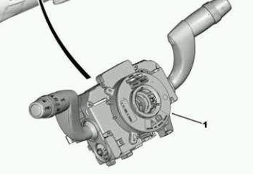

Ok, I've just emailed you the 3 diagrams for the wiper circuit. BCM5 is the Multi Function Control Unit under the Steering Wheel as shown below:
This is linked to the BSI and from there to the Windscreen wiper motor (5015). Anyway I hope these help you.
If you do decide to investigate the under steering wheel unit - there may be a cable tie behind there that is designed to maintain the position of the rotary switch (this may only be for ESP enabled vehicles, which yours isn't, but just in case!).

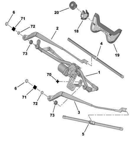

Assuming this is a Relay III:
The windscreen washers are unrelated to the wipers. Sounds like it is electrical - so is either probably something similar to the problem 'pogo001' had, or the Control Unit under the steering wheel may be playing up. A diagnosis with Lexia may rule in or out the Comms Unit, but I suggest having a look at the motor internals may be the quickest and easiest first step.
