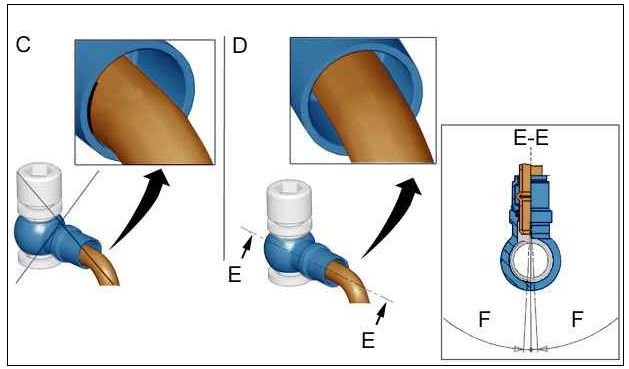

Does anyone know how this "flexible" banjo fitting works, or rather how it can fail?
I can flex the pipe inside the banjo fitting by pushing sideways on it (as per diagram C) which is how the mech says it leaks.
According to Citroen fitting instructions, the pipe is centrally aligned to the banjo fitted with a 3 degree tolerance! Fitting it outside this tolerance may result in a leak and the fix is simply to re-align it properly. This makes me think a replacement maybe wasn't needed at all?

The theory I believe is oil starvation and the resultant excess spindle play allows the vanes to contact the housing, causing a stall. Over time, this loosens the nut and it comes off, free to wreck the compressor wheel. I'd imagine there were plenty of warning signs before it can get that bad.
But getting back to this oil feed pipe, the circlip (difficult buggers at the best of times) securing the actuator arm sits just behind the pipe with narrow access either side.
There's potential for straining this pipe when trying to remove or refit the circlip. Perhaps that was when the mech noticed oil seepage?

Garaged phoned to confirm turbo solenoid, diaphragm and oil pipe have all been replaced as asked, so popped round to settle up with them and enquire how the work went.
Aside from the bottom oil pipe bolt being a pig to get to causing them to stay overtime on Saturday, it all went well (and my pocket is much lighter for it).
He showed me the old oil pipe and the top connector (where the pipe floats inside the banjo fitting) where I could see it certainly had far more freeplay movement than the bottom one. He also told me he had initially tried to reset/straighten the original banjo/pipe position (as per the diagram posted above) and it instantly leaked. Interestingly, he also told me there was no filter gauze in the old pipe, both suggesting someone's been there before and perhaps not refitted the pipe correctly?
