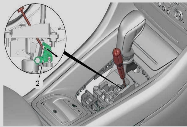

In the interim, in case it gets stuck - here's the release procedure for when it goes toes up:
Edit: See Link here as images have been re-uploaded since this was posted:
viewtopic.php?f=3&t=55599&p=496805#p576767

I'd seen the diagram, and in fact printed it off, and left it in the glovebox along with a plastic knife for removing the trim, and a bent screwdriver for accessing the interlock !
The bit of plastic that is pushed by screwdriver looks to be very easy to remove, thus solving the issue for ever....but losing the safety of the interlock, so I'd rather try and sort it.

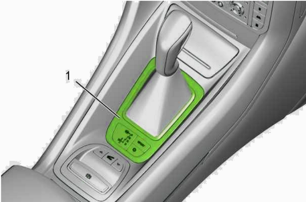

The interlock is becoming intermittent on my 09 Tourer, and I need to look at it. I can hear the relay working every time I touch the brake pedal but sometimes the interlock release is a tad slow and sometimes it needs several attempts to unlock. Trouble is I can't see how to get the bezel surrounding the shift off - the first operation listed above ie the bezel (1).
I can get a knife down the side of it but cannot see for the life of me how to, quote 'unclip and move aside' There must be some knack which I have yet to find - any one help please??

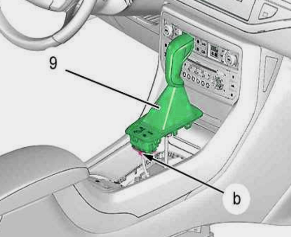

Does this help?
Causes:
Here's a little more detail of the bezel showing the clips:
Causes:
- The causes of malfunction can arise from the following elements :
- The battery voltage
- The "shift lock"
- The selector lever position switch
- The automatic gearbox ECU
- The wiring harness
| Unclip and move aside: The bezel (1) - Note, just use a trim removal tool - plastic with a thin edge and gently lever in at the sides to release the clips. | (a) Unlock the "shift lock" with the aid of a screwdriver - Press on (2) (In the direction of the arrow). (b) Move the selector lever to disengage it from the "P" position. |
