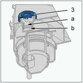

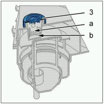

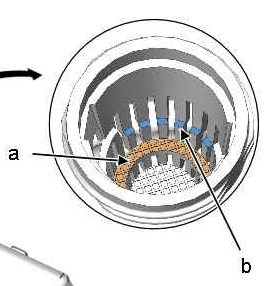

When you say 'jacked up' how did you do this - if you raised the vehicle off the ground with wheels hanging, you should of first raised the car to the highest suspension setting before doing so and then removed the LDS cap before lifting it. When the car is then lowered to the ground, you can replace the cap and then lower the suspension back to normal.
The weight of the wheels hanging freely can cause pressure issues in the system that can cause leaks or even a burst LDS tank if not careful.
As for suspension fluid. This should be checked with the car suspension on the lowest setting, wait for 2-3 minutes and then check the level which should be between the points a & b shown:
As you haven't stated what C5 model you have the top one is for a C5 X7. This one is fot the C5 MK I and MK II: It is common for there to be a little oil on the strut near the top - like a damp patch - but it should not be leaking.
Unless there is a specific service operation / reason not to, the suspension should be raised to maximum before lifting or jacking the car, but as said, always raise to high and remove the LDS cap when any more than one wheel will be left hanging unsupported.

GiveMeABreak wrote: 11 Sep 2017, 10:21 When you say 'jacked up' how did you do this - if you raised the vehicle off the ground with wheels hanging, you should of first raised the car to the highest suspension setting before doing so and then removed the LDS cap before lifting it. When the car is then lowered to the ground, you can replace the cap and then lower the suspension back to normal.
