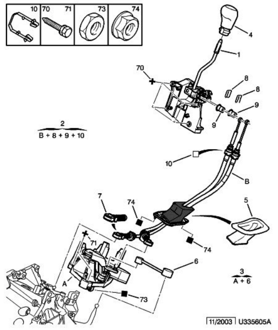

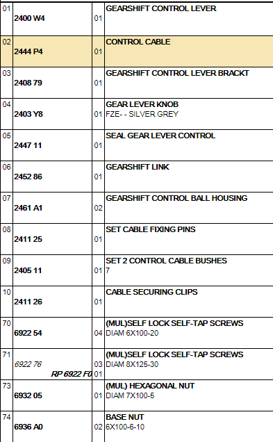

Here is the adjustment procedure first of all - in case you can adjust the cable. I will follow up with the replacement after.
Parts

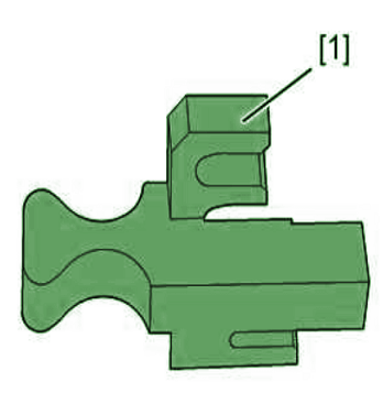

Positioning tool for the gear lever 9607-T

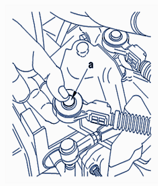

Adjustment (Inside the Vehicle)Under The Bonnet

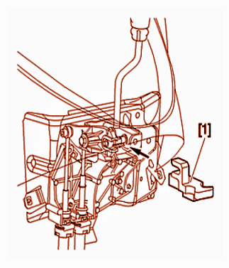

  • Remove the trim from under the gear selection lever.

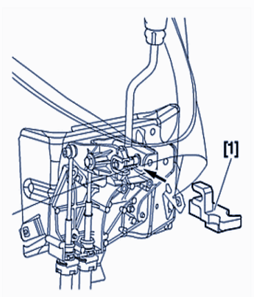

  • Immobilise the gear lever in the neutral position using tool (1).
  • Remove the air filter assembly.
  • Place the gear selectors and the gear lever in neutral.

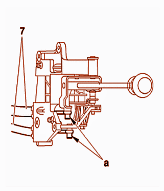

  • Unlock the ball-joint keys at " a".
  • Lock the cable lengths with the ball-joint locking keys.

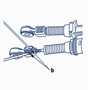

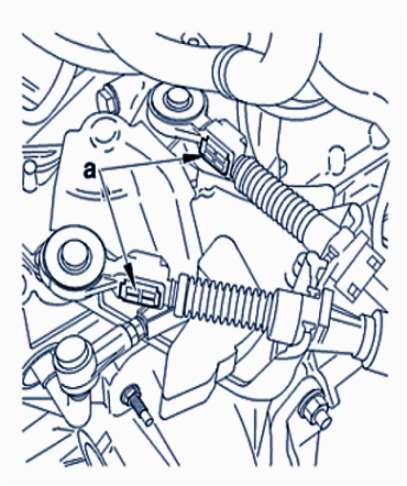

  • Do not use a tool to unclip the ball-joints.
  • To unlock the ball-joint, press at the centre " a" then pull the ball-joint upwards.
  • The ball-joints alone can be replaced provided that the locking key is removed.
  • Using two thin screwdrivers, unclip at " b".

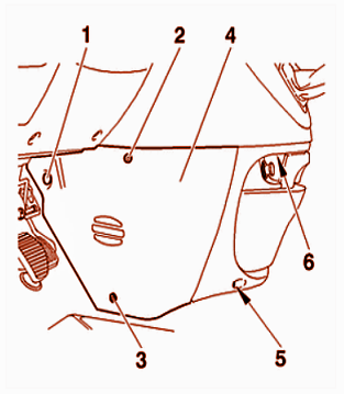

Here's the removal / refitting guide. Raise and support the vehicle on a 2 post lift.
Inside the Vehicle
Disconnect the battery negative terminal.
Remove (on each side):
  • The screws (2), (3), (5) and (6)
  • The plastic peg (1) using the tool [2]
Unplug:
  • The cigar lighter
  • The ash try lighting
Remove the air conditioning cover (4).

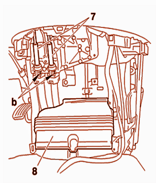

Unclip the control cables (7) from the gear lever at "a".
Remove the ventilation duct (8).
Unclip the sleeves of the control cables (7) from the control support at "b" Using circlip pliers.

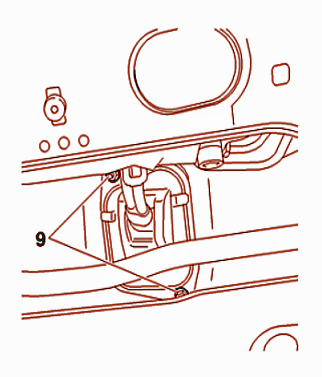

Remove:
  • The torque reaction rod mounting (sub-frame side)
  • The catalytic converter
  • The exhaust heat shield
Remove the nuts (9).

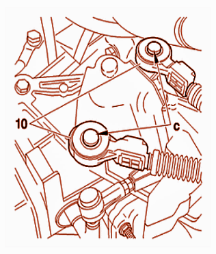

CAUTION : Do not use a tool to unclip the ball-joints.
Unlock the ball-joints (10) by pressing in the centre "c" and pulling them upwards.

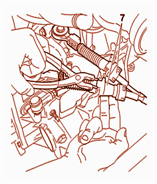

Unclip the sleeves of the control cables (7) on the gearbox Using circlip pliers.
Remove the control cables (7).

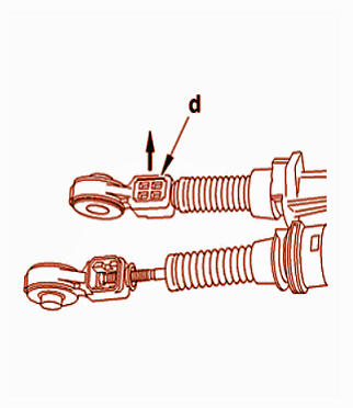

N.B. : Unlock the ball-joint keys at "d", before clipping the ball-joints onto the gear selection levers.Conditions required before adjusting:
  • Immobilise the gear lever in the neutral position Using tool [1]
    Put the gearbox in neutral
