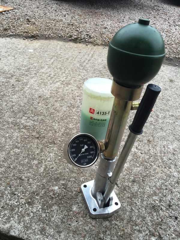

Well, last week I finally managed to find the holy grail!!
I was talking to LCS in Louth about the sphere recharging valves they were selling. I said to him "I don't suppose you've got a pressure tester do you?" When I was speaking to him he said that they didn't. 5 minutes later the phone rang and he said he'd got one. It was brand new and had never even had a drop of oil in it!
It turned up last week but I didn't have a chance to get near it until today. They're very simple really, but it's great to finally have one. I almost felt bad filling it with oil really :lol:
The sphere I've got on it at the moment is just one of many that was in a pile I had. The tester stops reading at 45 bar, I've no idea what it should be on that sphere, however, it's got 45 stamped onto the side of the sphere so I can only assume that this one is very good.
Paired with the sphere recharger that I won on eBay for a tenner last year, I'm all geared up and ready to go now!! :D
Well, now that I've got 38 valves for it I'm all geared up and ready to go :D
Is there a chart available that shows what pressure should be in each sphere by any chance?

DHallworth wrote:Well, last week I finally managed to find the holy grail!!
Well jealous David! That is a very tidy little unit indeed. :-D
The normal way to measure sphere pressure is to pump the oil pressure up past the expected reading by about 10 bars or so, then open the bleed screw on the tester slightly so that the pressure only drops slowly. When the indicated oil pressure reaches the gas pressure in the sphere the diaphragm will touch the bottom of the sphere and the pressure will instantly drop to zero as there is no more compliance left in the sphere. The pressure reading just before it dropped to zero is the gas pressure. If you bleed it too quickly or try to take the reading during the pumping up phase there will be some degree of error in the reading.
