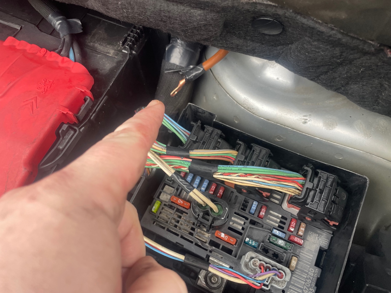

I’ve been told these BSM things can be finicky, and the garage took great pride in telling me the engine was steam cleaned. Looks great which is just as well as it’s an ornament now. As I took the BSM out I noticed two things.

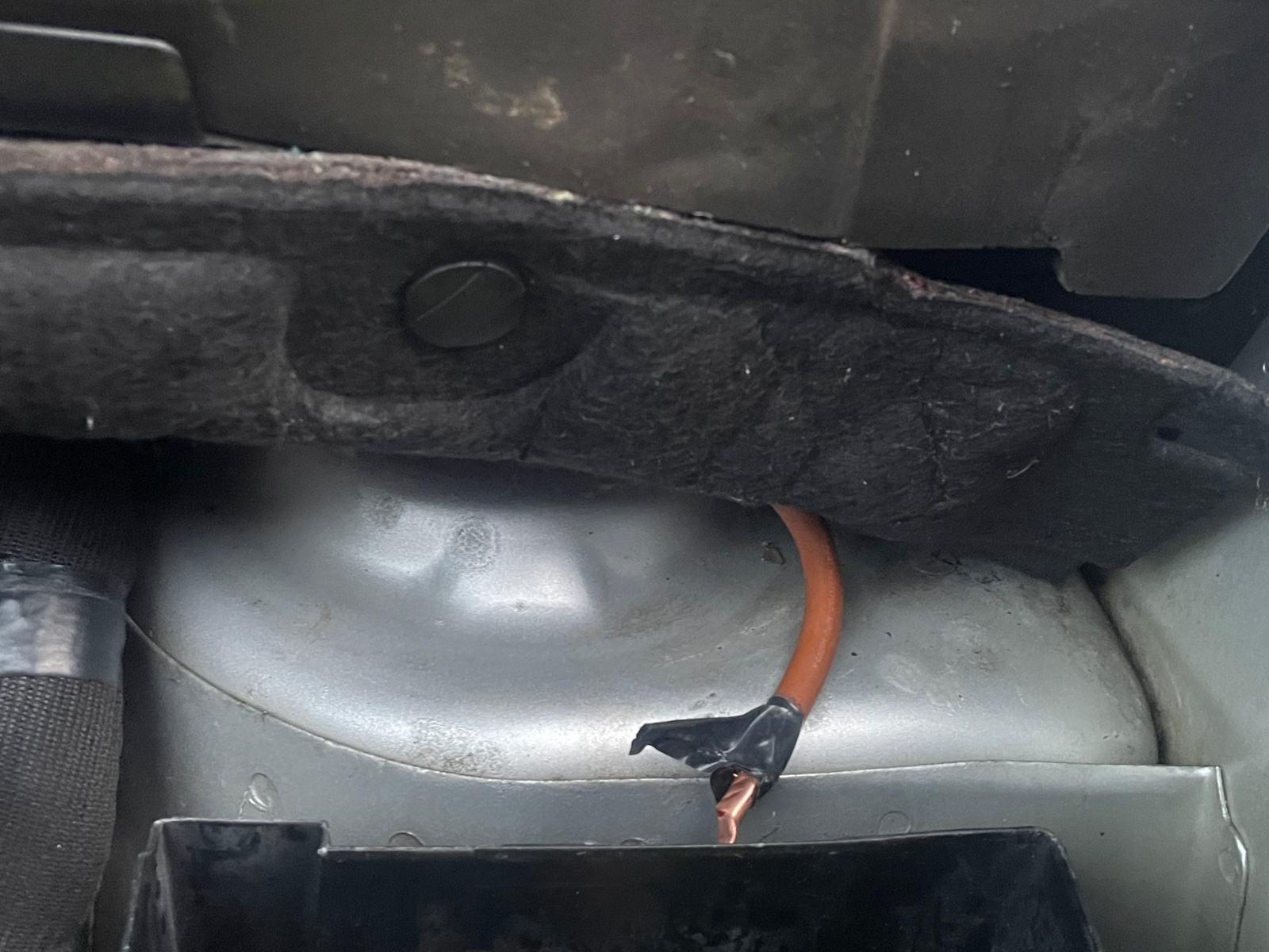

First was this brown stout cable. Looks like it should go somewhere, it goes round the back of the battery, but can’t really work out what it’s for. It’s been taped up by me now though.
Second was the sound demanding stuff above the BSM is sodden. It’s really damp. I only found two spots of water in the pot the BSM sits in.
The BSM is second hand so it’s been replaced before. When? Who knows. But doesn’t look damp. I’ve got it in a bag of rice and it’ll stay there for tomorrow. If it doesn’t resolve it then I will drive the car back to the garage and ask them to look.

If it had a tow bar the brown wire might have been used to provide 12 volts to it so it might go to the back of the van. A rear wiper doing its own thing could be a sign it needs replacing.
Some of the problems could be water in the electrics from the steam cleaning.
