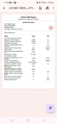

Hi, looking for some advice, I have a peugot 207cc 2010 that has an engine warning light and some error codes that I'm struggling to troubleshoot.
P2178 - mixture adjustment
P1336 - combustion misfiring
P1337 - misfire on cylinder 2
P1338 - misfire on cylinder 3
The car is juddering, pulling back and losing power. I replaced all sparks and coils, cleaned the maf, used odb to clear all errors but it all came back. Any advice would be appreciated, I did a live diagnostic while idling which is attached

How many miles has it done, engine size ?
The timing chains wear on the vti engines but it does not look as if you have a timing error code.
If you look at live data when the engine has fully warmed up are the values any different to these cold engine ones ?

Hi, it's a 1.6 it's done 57k miles. I'll do another live diag tomorrow and try do a second one with the errors, since the one I've uploaded I'd already cleared them.
My thoughts are injectors or lamda but the oxygen readings seem in the normal range and I don't want to be unnecessarily replacing parts if I don't need to, since I'll be selling it come march. (Providing I can get it running right).

When a code is stored freeze frame data will also be stored showing values when the code was given - take a note of these before deleting anything since it may help.
