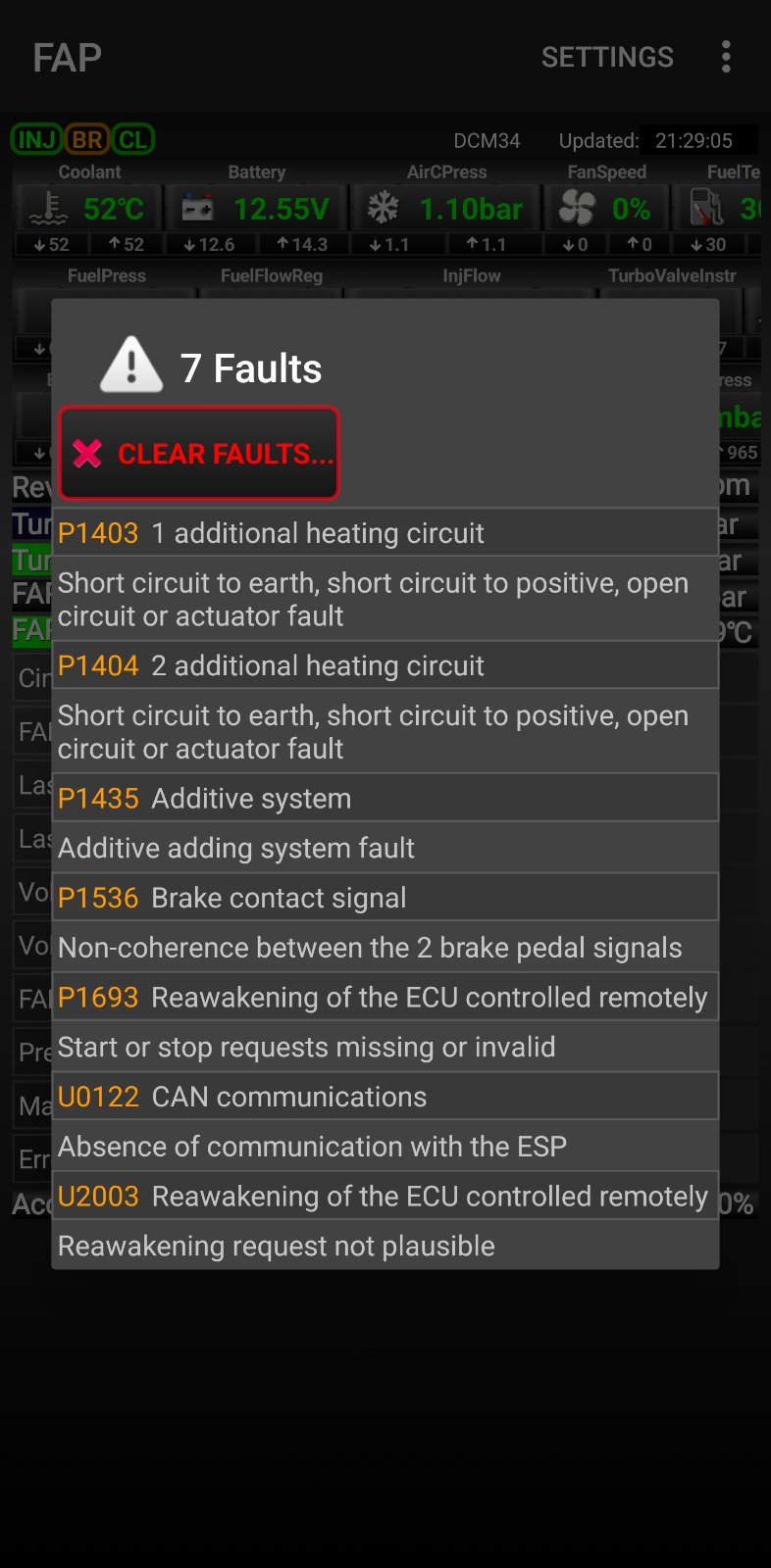

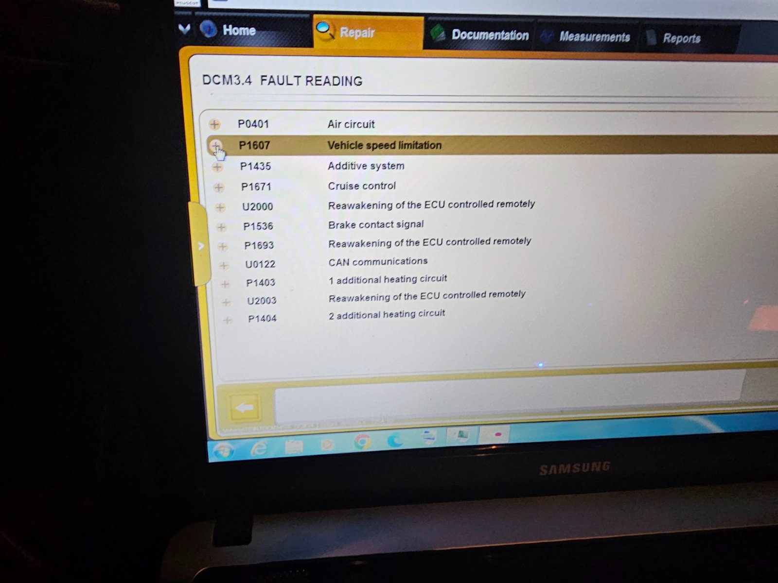

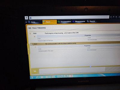

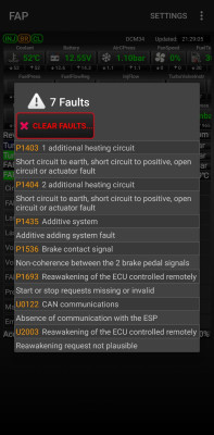

I've attached the faults that have returned for info should anyone stumble across this in the future, but I'm not too concerned with targeting them in this thread, I'm more focused on do's and donts when swapping a BSM.
That said, for clarity, I have already replaced the brake switch but after clearing, it reappears after a day or two along with p1693 and U0122. U2003 didn't clear at all. I've also found no corrosion on the pins or plugs of the BSM.
I'm not too concerned with the first 4 faults, I think I upset the egr when I cleaned it and it's been like that ever since, the additive fault has been present since I've owned the car, dpf still clears every 400-500 miles.

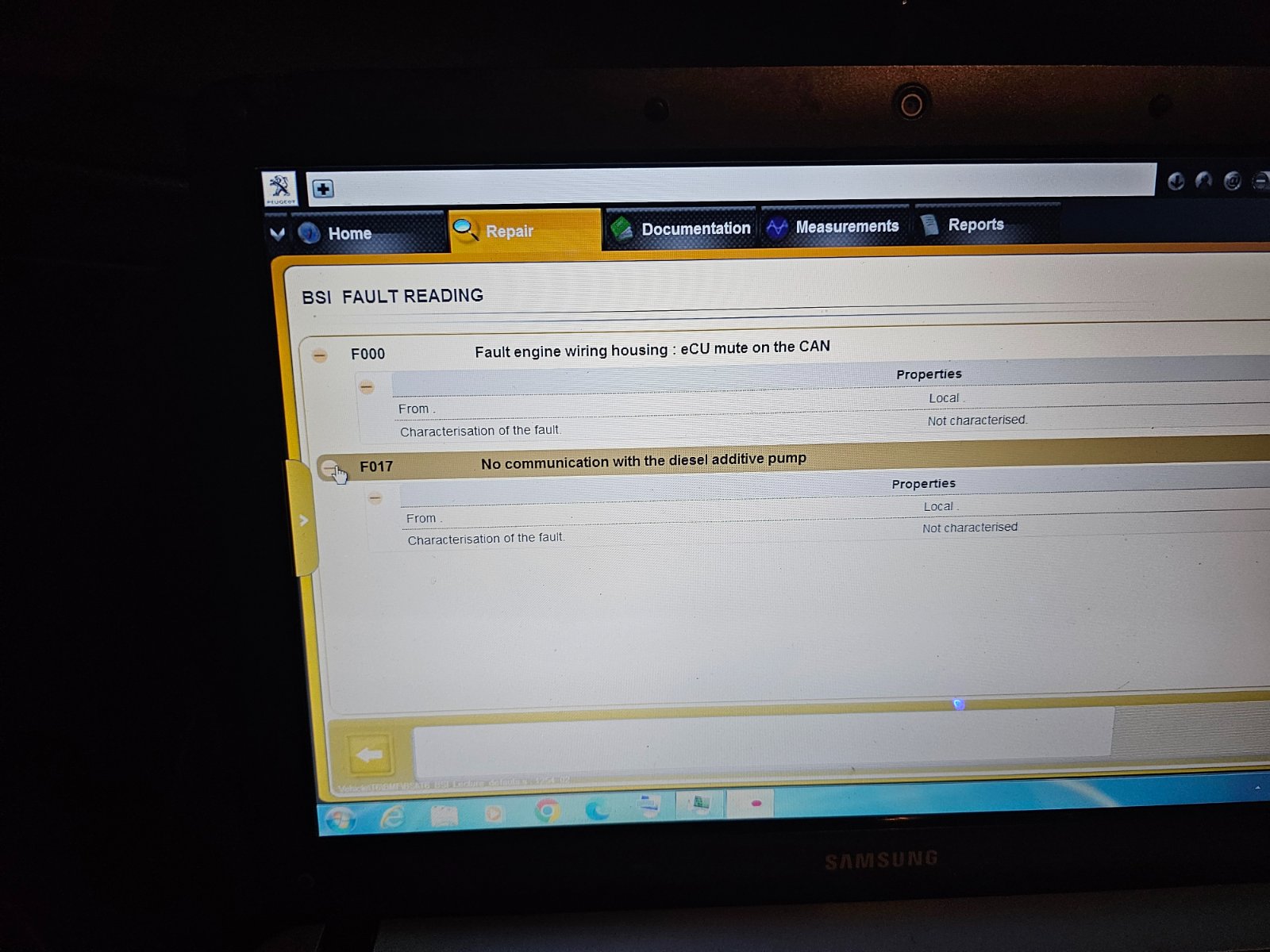

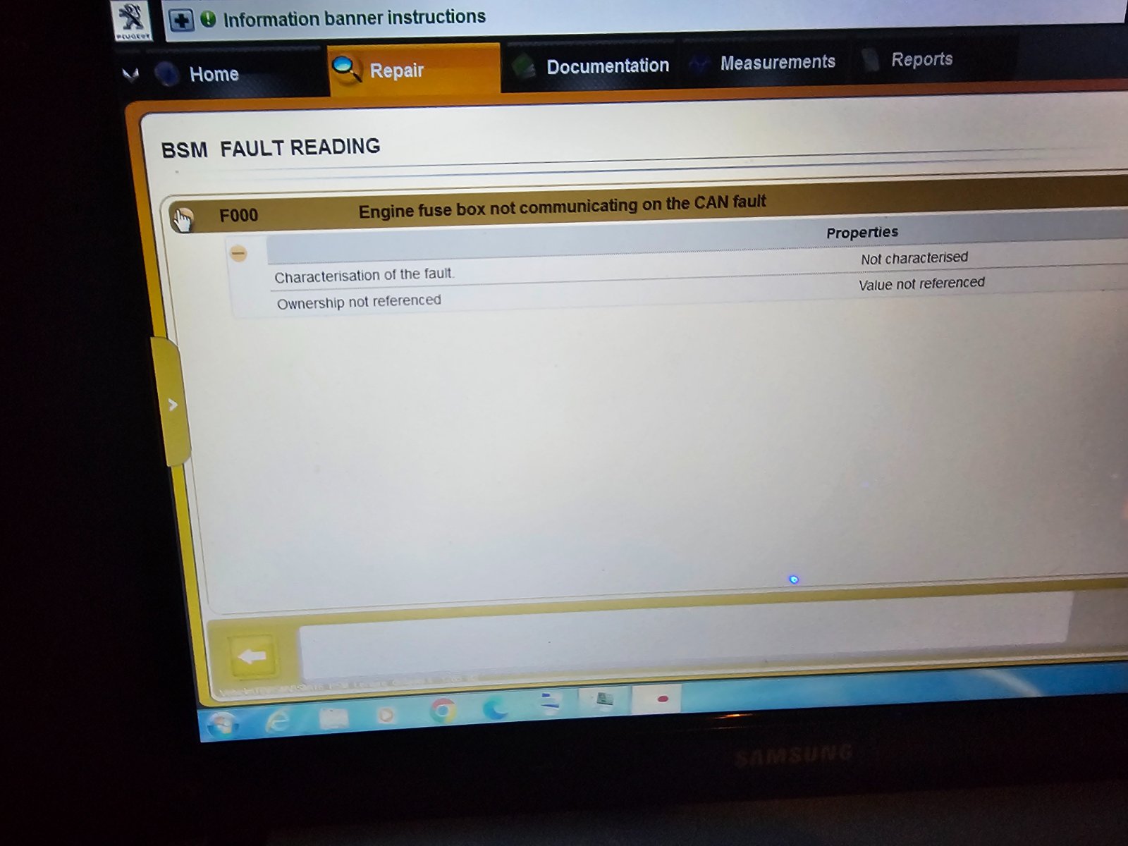

BSM had it's own fault code of f000 (not communicating with CAN) and BSI has same code (fault engine wiring housing, ecu mute on the CAN)
So I thought for the sake of £40 I could swap it out, programme if necessary, and see if some of the faults disappear.
Air circuit fault is because egr was temporarily blanked. Cruise control coherence cleared and hasn't returned but probably will in a few hundred miles (CC and speed limiter will rarely fail, but ignition off and on allows them to work again for many weeks before it'll come back for a journey).

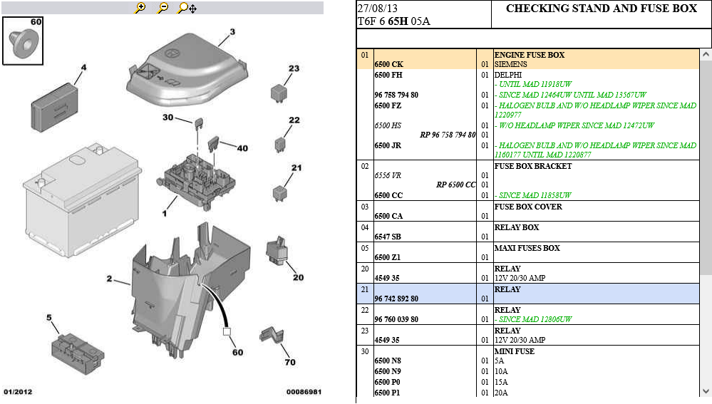

This is all I have, it is not clear which cars have the Siemens box fitted. Note that the same BSM part was often shared by different models of Peugeot and Citroen.
Maybe you could get the PSA part number matching your VIN from a dealer, but there is still the problem of cross referencing that to a 9*** number.

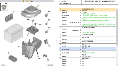

MixerFistit
- Posts: 177
- Joined: 17 Oct 2021, 14:45
- x 14
Re: BSM replacing information
OK, the dealer suggested the part number I gave is from a 207 which seems to match what I was seeing online. He's suggested 6500CK is the match which matches nicely to X_V6's findings
This still leaves me with the problem be predicted of matching it to a 9x number and there's more than one number on ebay but fortunately, L04 seems to be consistent in the results. 9x numbers do seem to change over the years so I think I'm narrowing in on the correct part. I'll hopefully be back with a conclusion when it arrives.
Yes, 6500CK seemed to be the most common variant at the time, so you should be able to find one, it is frustrating that the actual part number is not printed on the unit.
