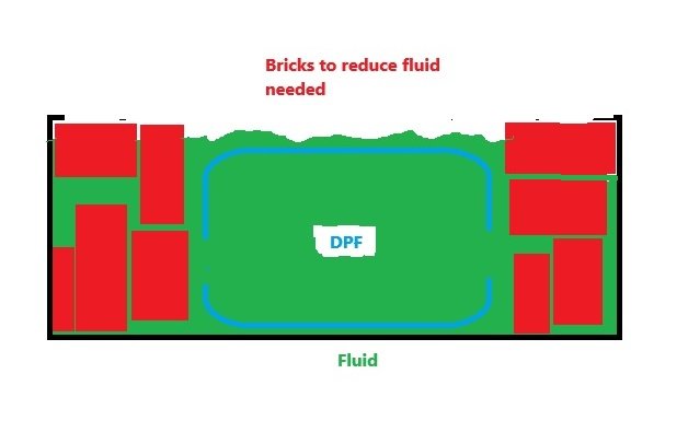

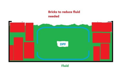

You need to remove the DPF from the car, remove any sensors attached to the dpf then with a suitable container that will hold your DPF with enough depth to submerge it fill the container with the diluted acid until it covers the whole thing. Leave it to soak and then flush thoroughly with a low pressure hose until the waste water is clean. Ensure it is fully dry, use a hairdryer if necessary and then refit to the car.
In the UK you can buy 'brick acid' in 5litre cans from a builder's merchant. I used one can on each DPF minimising the free space around the filter to reduce the amount needed. I used bricks!! This is a link to the product in the UK: https://www.travisperkins.co.uk/cleanin ... 5/p/333531

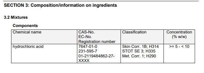

The product I refer to as 'brick acid' is already diluted in the can. i cannot remember the actual strength but I think it's pretty low, it should be in the ad I linked. You just use it straight from that can. Actual 'pure' HCl is pretty nasty stuff and you don't really want it around!! So your use of the word 'pure' may not be what you meant. You use the product as it is, being already a diluted form.
It appears that the spec for that product is between 5 and 10% HCL as you can see here:
