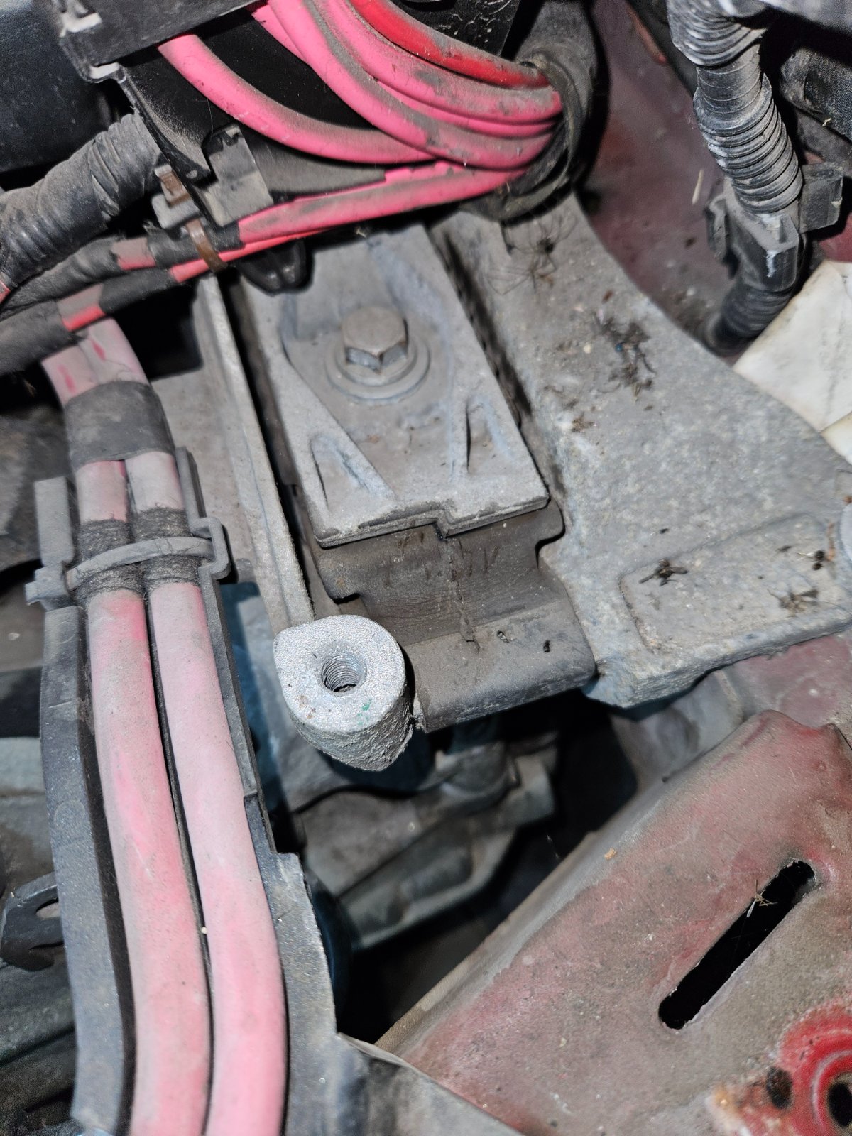

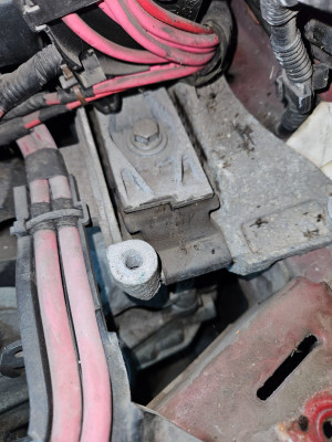

Hello everyone i have megane 3 2010 1.5 dci 81kw grandtour,and I have problems with vibrations inside cabin only on idle,replaced mount bellow engine,replaced up right mount and still vibrate..Vibrations can feel on pedals,steering wheel,and seat.Cluch pressed or not it is same.Only left is mount that hold gearbox,dont know if replacing will solve vibrations..Here is picture of it.Tnx in advance.

I don't know anything about the Renault engines, does the engine have an upper stabiliser bar? If so check the bushes that it is mounted in and check the gearbox mountings if you have already replaced the engine mountings. :)
