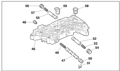

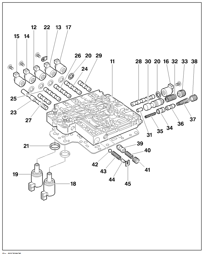

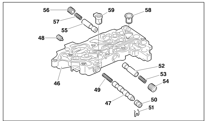

I'm in a bit of a pickle here! I have received the new Valve Body but upon inspection I have found that the pressure regulating plugs are at different depths and stupidly, I matched them to my old Valve Body assuming that these should be identical without taking any prior notes of the plug depths...
I have done some research and it looks like there are a few minor variations of the valve bodies- but, how do I confirm the correct depths for these plugs?
The original Valve Body from the car is marked "E/07/079" whilst the new valve body is marked "3/99/301".
Does anyone know how I can find out the correct depth adjustments for the pressure regulating plugs?
I am referring to plugs "38, 33, 41, 51, 54, 56" in the below schematic:
ozvtr
- Posts: 849
- Joined: 13 Oct 2020, 01:11
- x 233
Re: AL4 Gearbox P1167 Fault Even after Solenoid Change?
Oops!!! They are set individually at the valve body factory for that particular valve body! Air pressure is applied to certain orifices and the valve tension adjusted to get pressures at other orifices.Sam-Kelly95 wrote: 18 Sep 2025, 19:07 I have found that the pressure regulating plugs are at different depths and stupidly, I matched them to my old Valve Body assuming that these should be identical without taking any prior notes of the plug depths...
An auto transmission shop might be able to set the valves for you.
