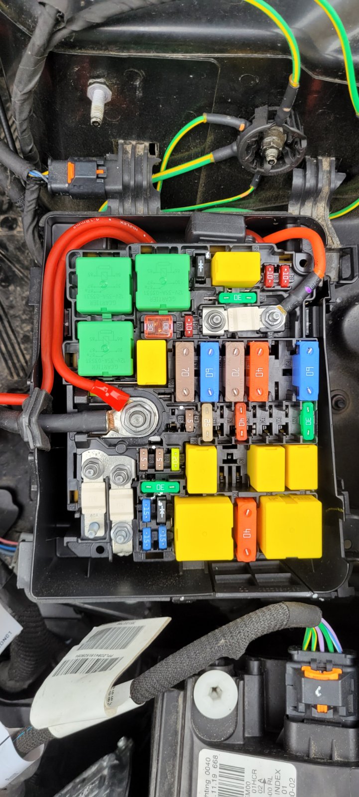

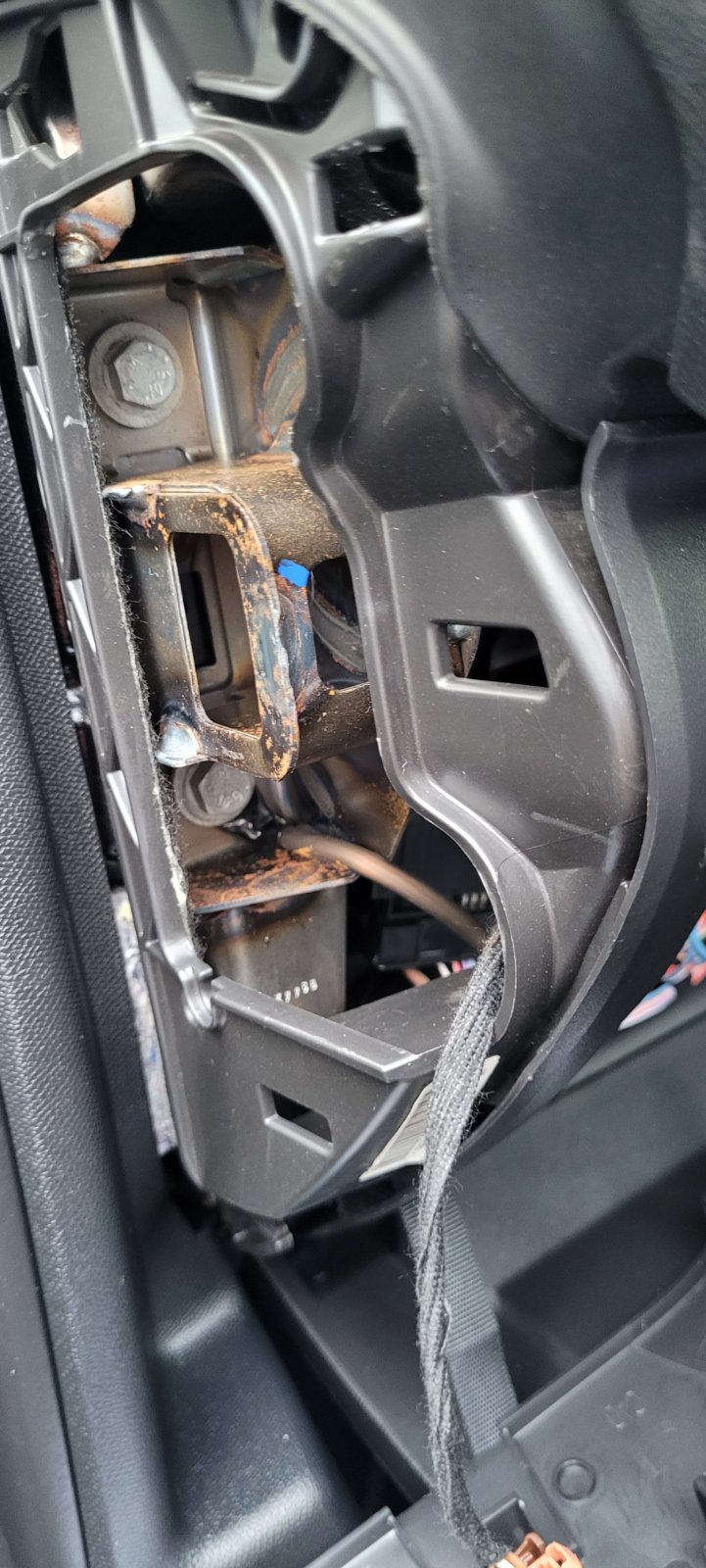

Thank you, I connected the amplifier to the stud in the engine bay fuse box and earthed to the bolt at the side of the dash as per the attached pictures, that should be okay right? It all seems fine now touch wood.
