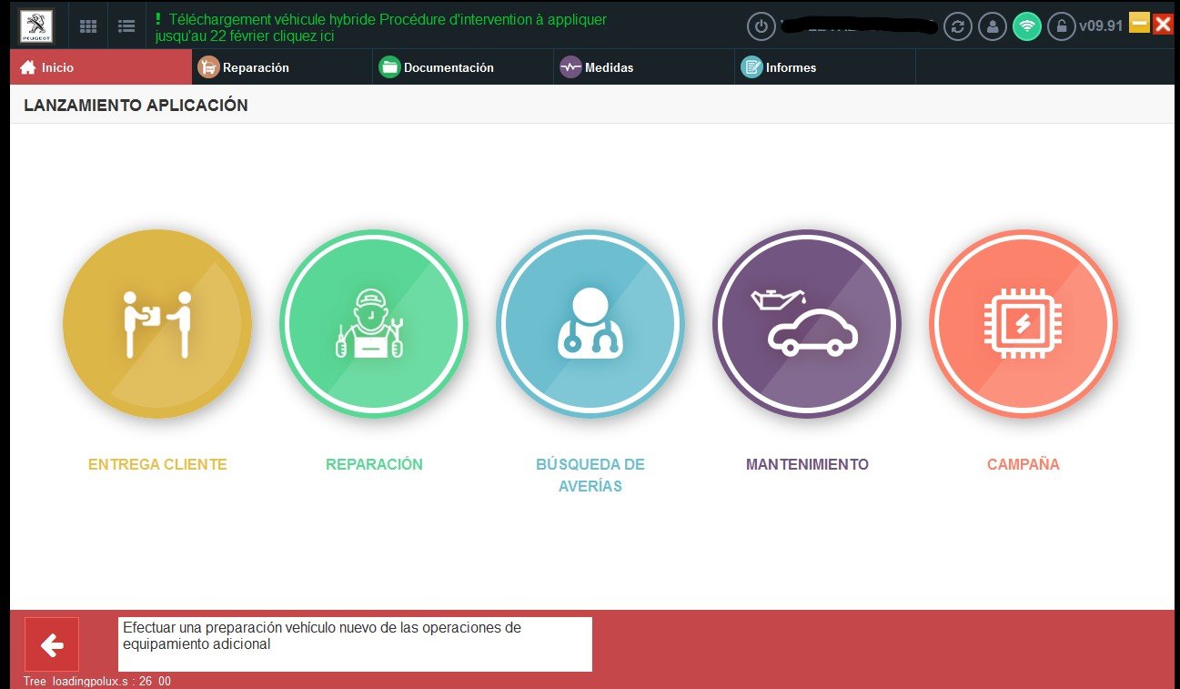

Hello, I have a 2019 308 diesel with an EAT8 automatic transmission, due to a fault I had to change the gearbox transmission control module (TCM p/n:9831606080) and I can't get the car to recognize it. I have Diagbox 9.91 on Windows 11 64bits but the telecharger or telecoding does not respond as it should.
How can I make it recognize it? Do I need to be connected to the internet from diagbox?

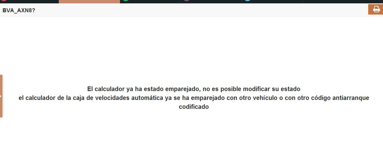

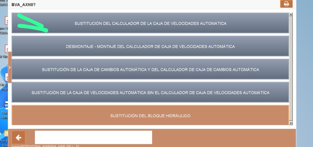

Now When I try to do the "Part Replacement" process it tells me that
"the computer has already been paired, it is not possible to modify its status, the automatic gearbox computer has already been paired with another vehicle".

Was the TCM from another vehicle? If so then you may not be able to pair it with your car. These are calibrated to each vehicle as far as I know.
