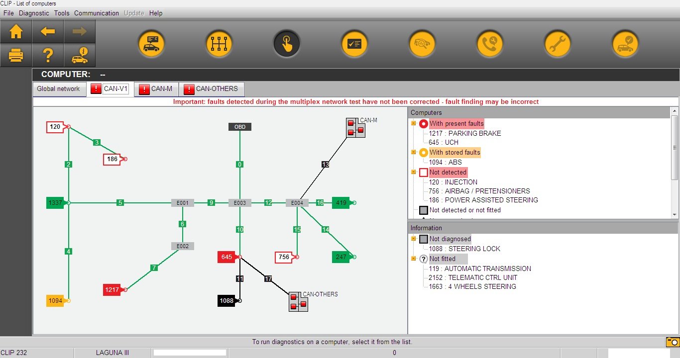

Reanult Laguna 3 dci Hatch 2011 model Electronic Parking Brake does not ENGAGE... hence no handbrake
Can anyone please advise, today my Renault Laguna 3 dci 2011 hatch keeps showing "CHECK PARKING BRAKE" and the brakes will not engage at all, have to leave it in gear and put bricks under the wheels.
The RED P circle on the DASH KEEPS FLASHING and so does the RED light on the Brake switch.
When i open the driver door it flashes red "APPLY HAND BRAKE"

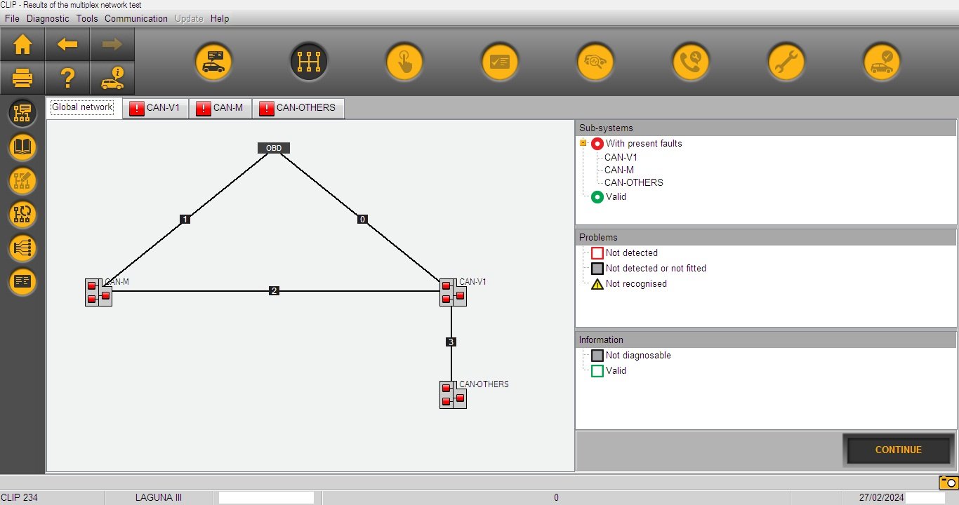

Here are the screen shots of the scans of Renault Laguna 3, please see attached

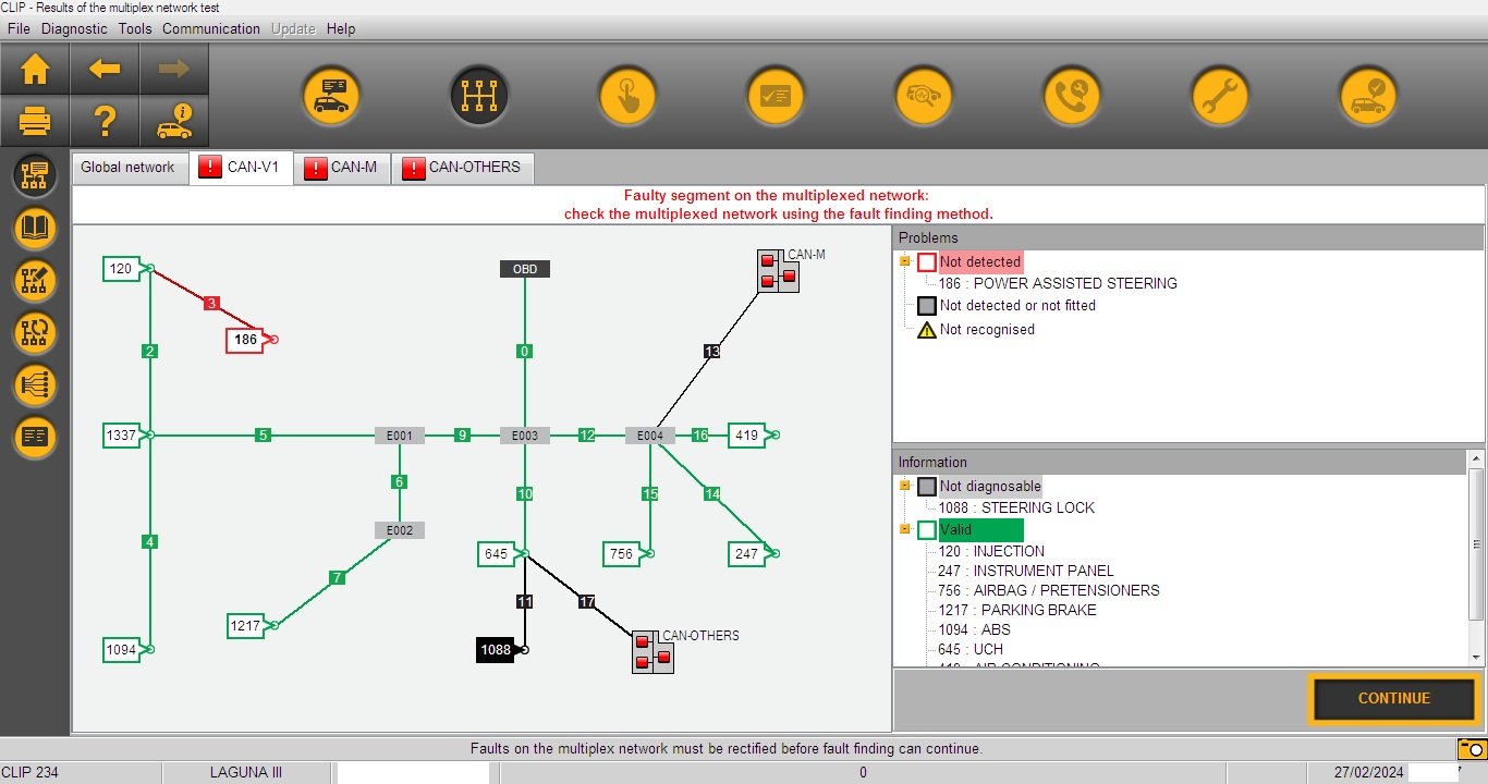

CAN-V1: 186 Power Assisted Steering

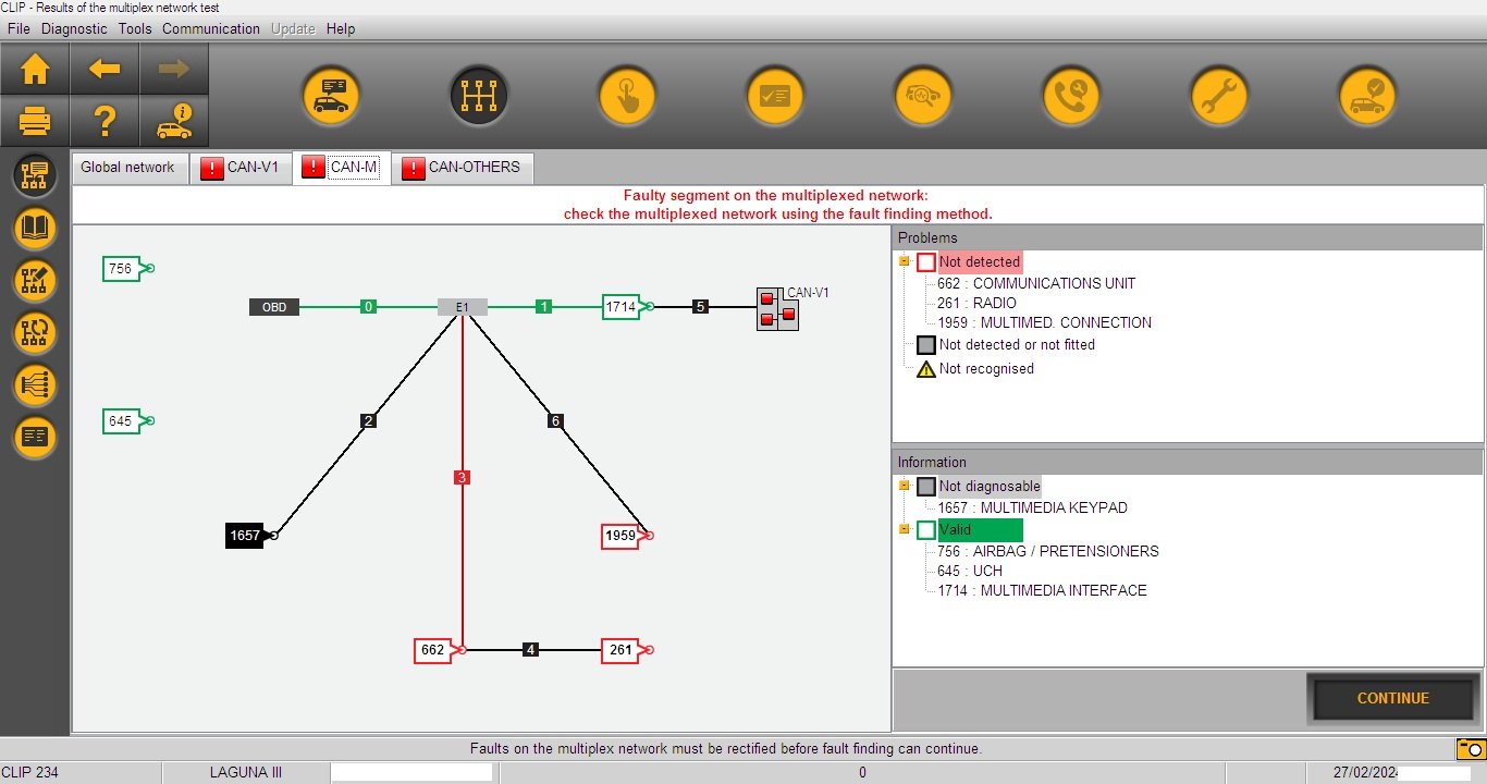

CAN-M: 662, 261, 1959 (not sure what this means? )

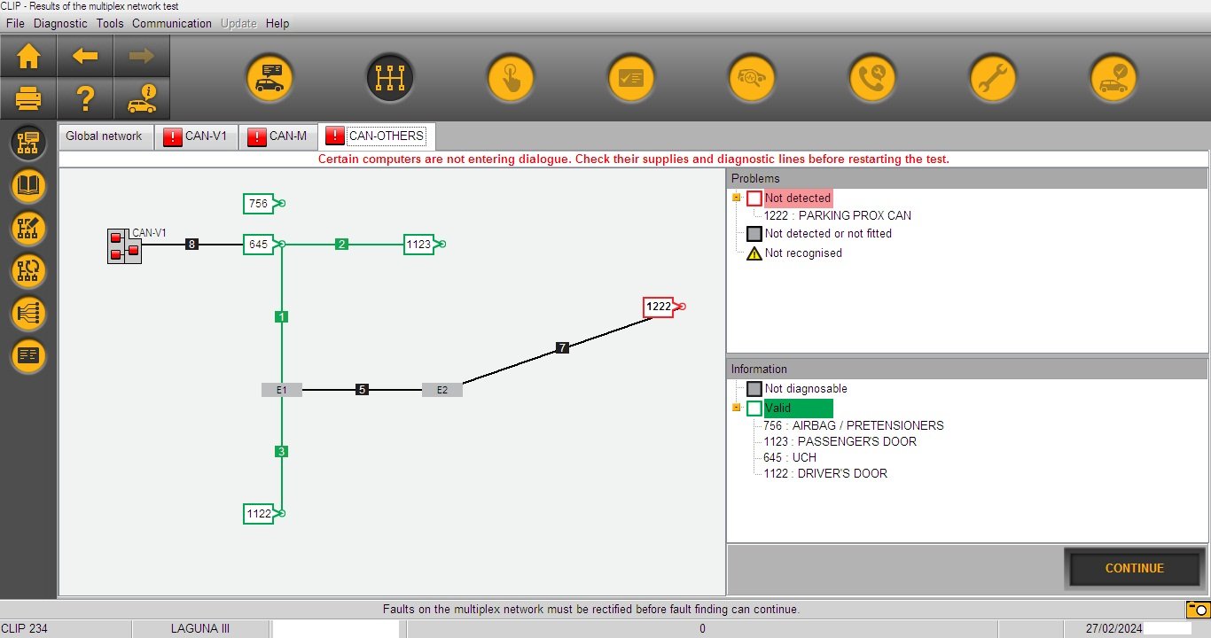

CAN-OTHERS: 1222 (something to do with parking proxy can??? )
Also what does the other messages mean?
"Fault on the Multiplex... "???
"Faulty segment on the multiplex network"???
I have limited knowledge on how to use this CAN-CLIP so i am a novice
Any Help and Advise i would be Grateful so many thanks for your help in advance

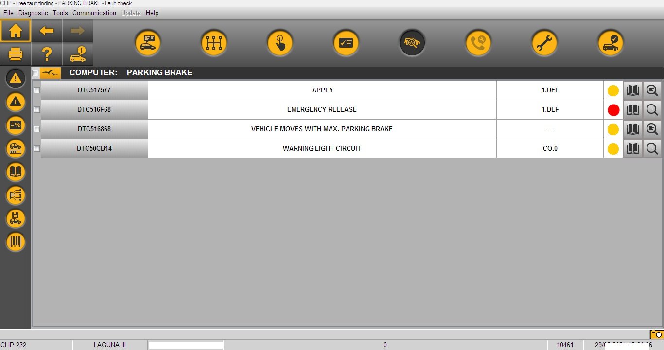

I MANAGED TO GET SOME MORE INFO OF THE PROBLEM
DTC517577
DTC516F68 -------------
DTC516868
DTC50CB14
thanks for any help provided

Re: Renault Laguna 3 dci Hatch 2011 Electronic Parking Brake NOT ENGAGING
I cleared the yellow codes but only 1 red code still remains
Computer: Parking Brake
DTC 516F68 Emergency release 1.5def
The (p) on the dash keeps flashing then goes off does not appear again and the brake button light behind the gears stick keeps flashing red

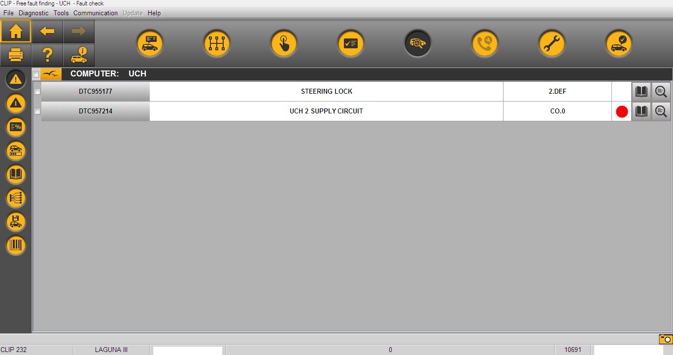

UCH
Index
Title
Characterisation State
DTC957214 UCH 2 SUPPLY CIRCUIT CO.0
PRESENT
Context when fault appeared
Index Title Value
Additional data
Index
Value
MILEAGE SINCE LAST APPEARANCE OF FAULT
Index
Title
CharacterisationState
DTC955177 STEERING LOCK 2.DEF
SAVED
Index
Title
Value
ET497_FF CAUSE OF STEERING COLUMN LOCK FAILURE INDETERMINATE
PR091_FF STEERING COLUMN LOCK SUPPLY VOLTAGE 11.900000
PR092_FF VEHICLE SPEED, STEERING COLUMN LOCK 0.000000
Additional data
Index
Value

DTC516868 VEHICLE MOVES WITH MAX. PARKING BRAKE---
SAVED
UCH
Index
Title
Index
Title
PRESENT
SAVED
ESP
Index
Title
DTC407481 EFFECTIVE MEAN TORQUE MULTIPLEXED INFORMATION ---
SAVED
