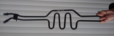

Having got the MOT out of the way I can now move on to the next immediate project. As I said above I noticed the MX3's power steering cooler was looking exceedingly rusty and I went searching for a replacement. Unfortunately nothing to be found other than a factory back order at £162.79 + VAT. So I applied my inventive spirit to the problem and the result arrived today for the princely sum of £13.00:
Own work
Own work
It is from a different car but will fit with a lttle fettling as it connects to hoses which allows some scope for modification.

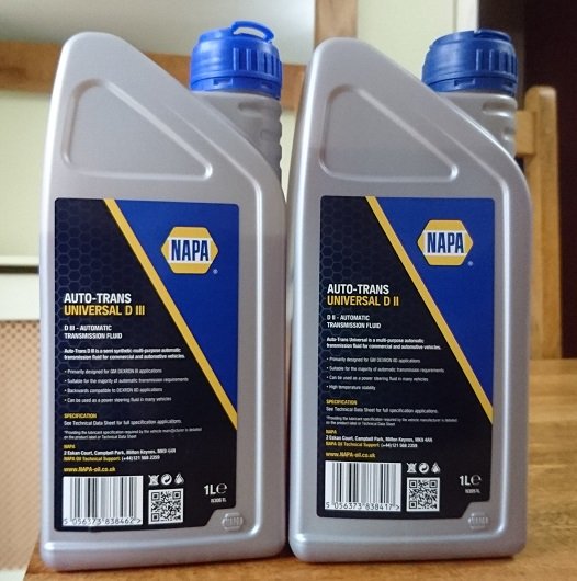

So I planned that job for tomorrow and realised I needed some power steering fluid so popped down to get it. When I got back I stood it beside the ATF I bought for the gearbox and this is what I had:
Own work
Own work
Personally I think that is pretty poor from the makers as the fluids are not the same and the difference is not exactly obvious!! Can you spot it?

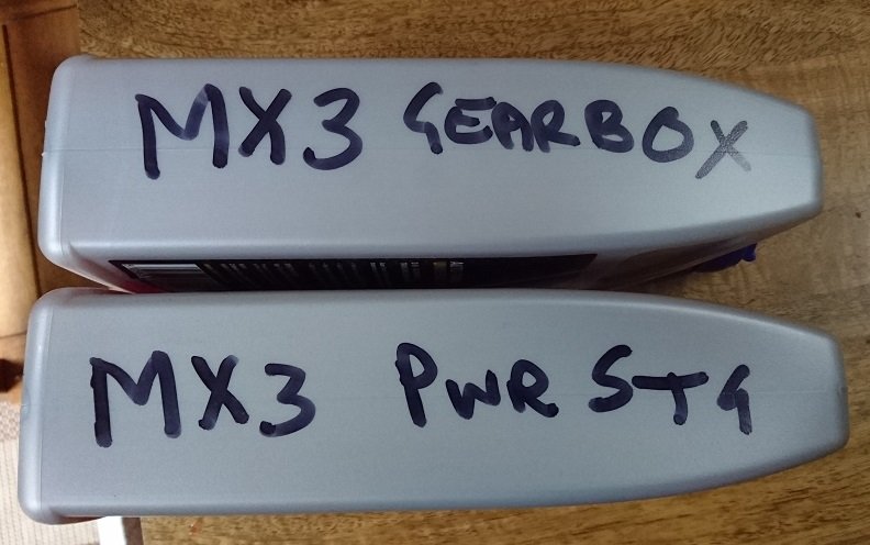

Knowing that I may well pick up the wrong one at some point I have made my own labelling: :-D

I'm loving that cooler Mick :D Very pretty!
Yes, difference spotted. One's Dex II and the other is Dex. III... Dex. II is mineral based and the granddaddy of ATFs whilst Dex. III is the synthetic child... Supposedly backwardly compatible but drivers sill running ZF 4HP14 and 18 slushboxes will say otherwise...

CitroJim wrote: 14 Oct 2022, 18:52 I'm loving that cooler Mick :D Very pretty!
It comes from a BMW 3 series so the quality is there too. A real bargain at £13 I thought!! :-D
