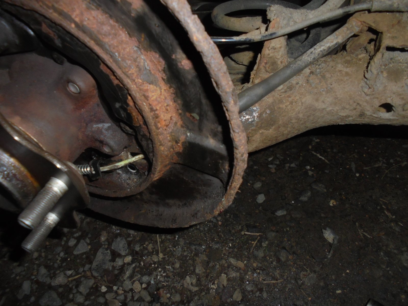

Looks like I have turned prophetic. Indeed the setting the shoes to the correct position had zero effect on the foot-operated parking brake not working, and the dismantling was necessary and revealed the crux of the problem. The cable responsible for operating the handbrake mechanism transmits a pull and push to the backplate but not on the critical few inches inside the "drum". The last bit of the cable before the backplate is "swollen" which I seem to recall from one of the Nissan leaf forums. May need a new handbrake cable. Meantime spraying stuff working backwards and forwards, pedal on and off many times is the current strategy. That's the offside, expecting the nearside to be the same story.

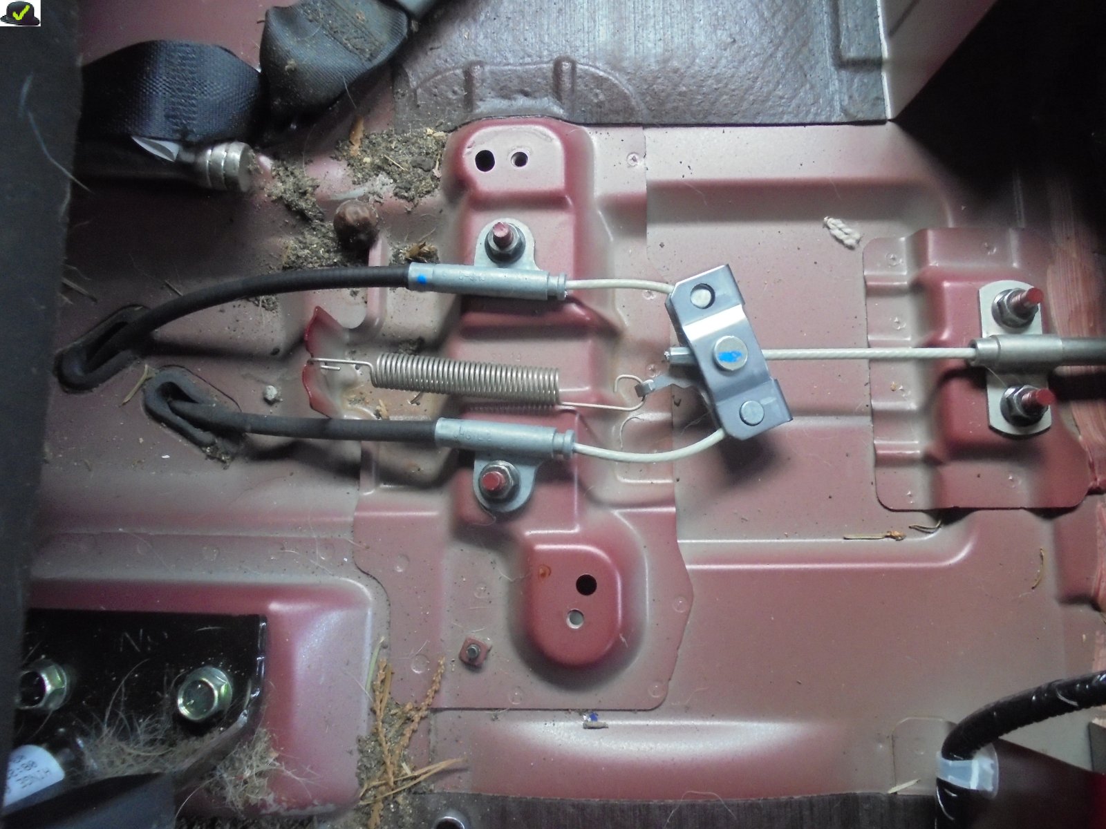

An excellent simple summary of the Brake cable replacement job on a Nissan Leaf.
Spoiler: show
A few falcon originals in the wrong place see viewtopic.php?p=769193#p769193

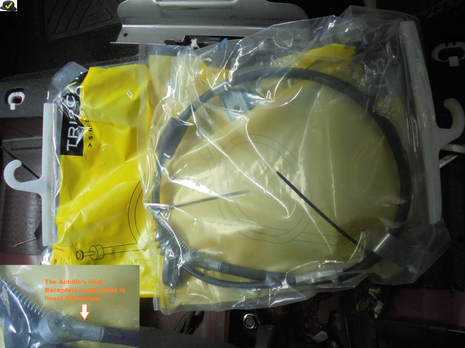

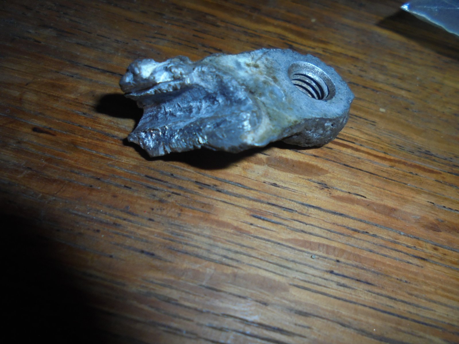

Whatsthisthen :?:
Relax, I'll tell you.
It is an aluminium bracket/cable guide which screws to the rear steel brake backplate of a Nissan Leaf.
Its job is to provide a little hole through which the handbrake cable enters the backplate.
What happens next? Well the picture shows the picture 8 years later. The hole no longer exists and the handbrake cable cannot pull the operating lever on the brake shoe as the former hole has closed up due to corrosion.
The last thing I want to do is to break the cable they are expensive for a brake cable from Nissan, and little aftermarket in them although Lithuania has a few, but that bracket/guide needs removing/replacing/freeing off. I can see me destroying that bracket to save the cable.
Falcon Original
Falcon Original

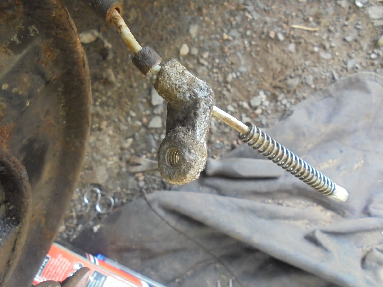

Close of play today ended on a small but excessively time-consuming bit of progress but still some way off scoring the first satisfaction point.
Managed to remove the cable relatively intact from the corroded up aluminium cable guide, with a careful just enough destruction of the guide. No power machinery used, careful hacksaw and file use, followed by a series of small nibbles with a small pair of pincers.
Falcon Original
Falcon Original
Falcon Original
Falcon Original
Will probably have to recreate the cable entry guide in some shape or form, but the cable is saved and functional.

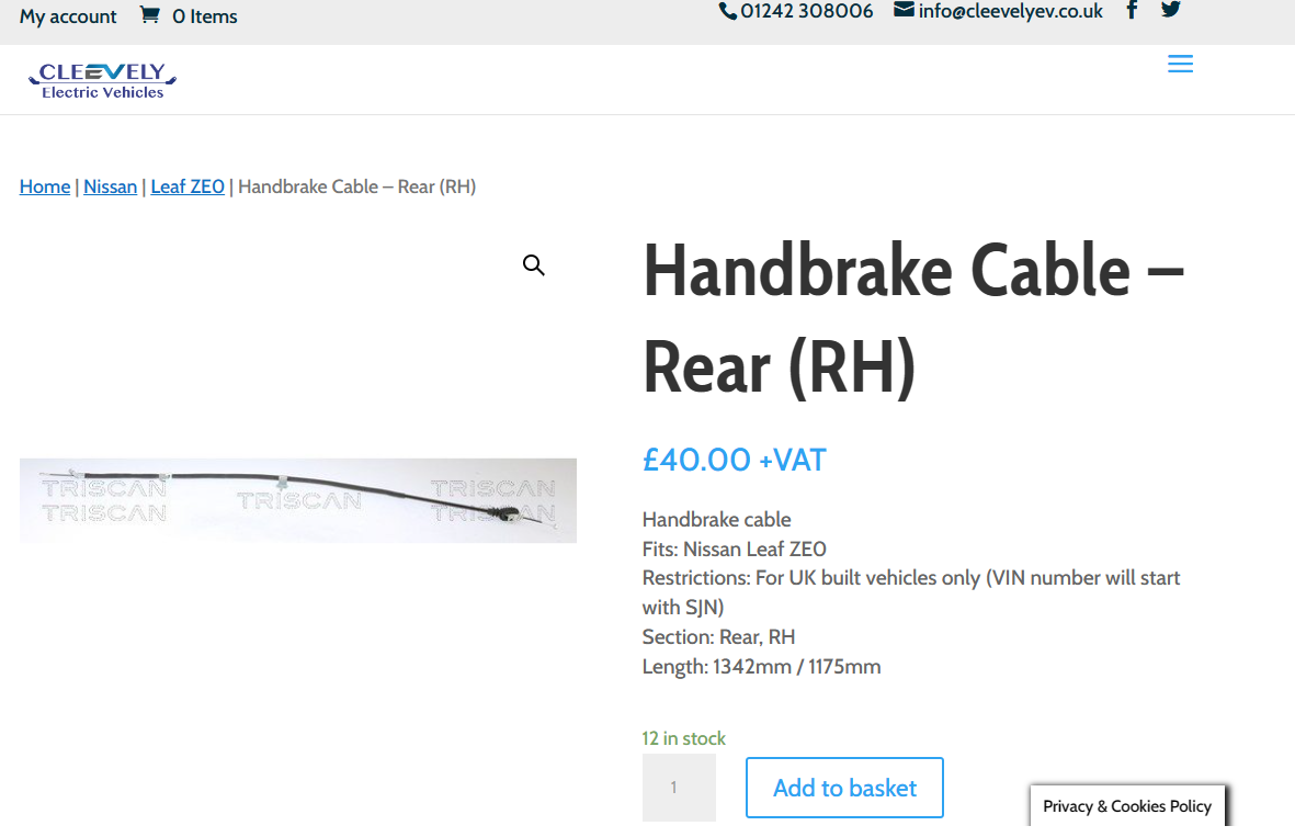

Never mind Lithuania or Nissan, Gloucestershire is the place for Nissan Leaf handbrake cables
£48 each more like it and it’s from tried and trusted EV specialists Cleevely
https://www.cleevelyev.co.uk/ev/nissan/ ... e-rear-rh/
Screenshot  <br />https://www.cleevelyev.co.uk/ev/nissan/leaf-ze0/handbrake-cable-rear-rh/
Screenshot
