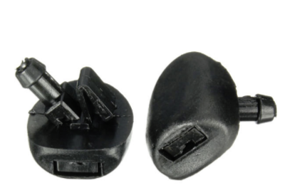

I have a Peugeot 407 2007 57 plate. I need to remove the washer jets from the bonnet to be able to clean them. And advice on how to get them off.

They simply clip in when pressed into the hole from the top of the bonnet, as you can see in the diagram. To release, you just need to use a blunt tool to pust the clip in to release it - then push it through the top of the bonnet.

6438Z1 is the part number. There are aftermarket ones available for a few quid:

I replaced mine with aftermarket ones from halfords when I couldnt get a great spray from them. I had tried pins, air line, and wasted a lot of time but only could get a dribble out of them. There was plenty water coming out of the pipes though so it could only be the nozzle

Ok, so you could take a punt on a couple of these at a few quid for 2. But note that when you fill your washer tank up, really be careful to ensure there is NO grit or crud in the container from which you are filling it from. The smallest bit sand is enough to block the washer nozzle. Once it's in the nozzle, it will be almost impossible to get it out as it it is so small.JoshWiggill wrote: 06 Mar 2019, 13:56 Thankyou. The pump is working and water is coming out of the hoses but just didn't come out of the actual jets.

Okay thankyou both for your help. I will order some new washer jets. When u clipping them must you doing it from the tool of the bonnet or underneath. I have had a look at the underneath of the bonnet and there is a small rectangular opening.. just wondering as I don't want to damage the paint work.

I was lucky, it was luck and not design that the ones I bought were supposed to go in from the top and had a nut to hold them. However if I remember correctly I couldnt get the nut on but the threaded splind on the nozzle fitted perfectly in the square hole like a mini ratchet and they just pushed in and have never moved since

I've had mine out a few times and back-flushed them with hot water which has worked every time.

Some jets might need descaling, if they've been run on tapwater-based screenwash.

My washers have turned from jets to a mere dribble. Do I need to remove the cover from under the bonnet to get them out ?

Try using a pin inside the actual ball of the jet of the washer. These can become blocked with grit or other fine particles. They are easy enough to unclip and are cheap enough to replace.

Tried that n made it worse ! There doesn’t seem to be any jet I can see in there, the hole the water comes out of is oblong. Unless it’s hidden ?
