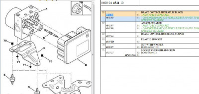

I've had a look for you and the part numbers are as listed for your VIN (one part number in each of (1) & (2) will be for the part pre-configured - the other part is when VIN is specified on order - but you have at least both to search on.
I would suggest you get a matching one - don't mix the different types'

I think we've discussed this before, and there's minimal configuration required - like only whether ESP is present or not (or maybe that is the suspension pump....). I'll have a look and see how many different types there are.

Yes the distinction is whether they have ESP and then after that for the Non-ESP version, whether it has ASR or not - so I think it better to stick to the ESP version as per the parts above for the 2.2
