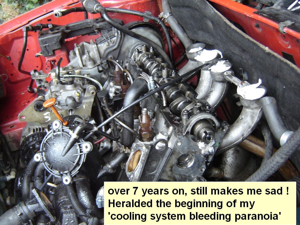

Oh that's a bloody shame but at least you did it and it allowed you to assess the rest of the mechanics so it was well worth it and bloody interesting it was too..
Yes, the XUD is as tough as anything - just look after cooling and cambelts along with regular oil changes and they will go on for ever normally. Often they might consume a head gasket around 150K but that's about it...
Same with the 2.1 and HDi...
My Gabriel is on 209K now and she runs and sounds like she's done a tenth of that...

Getting Head Bolts Out
...talking of which, I'm gonna be having the head off my 'known running but HG blown' 275k lump to try to 'lay some Ghosts to rest'. Back in 2009 I got to the 'head bolts' stage on a HG job on my previous 405 and I just couldn't get em to budge. The 'access only from the front' (windscreen & bulkhead to rear ofc) didn't help, but others cope doing it 'engine in', often on the Turbo's, on which I know the bolts are tighter.CitroJim wrote:Often they might consume a head gasket
A garage took over the job and it was never right, I threw money I didn't really have at it and ended up scrapping it, so I'd like to work out why I couldn't get em out and feel I could 'do the job myself if it became necessary' now.
I'll have space, being engine out, to use a T-Bar, but I guess the normal tool of choice for 'em would be a torque wrench or breaker bar, both of which I have in approx 3ft long varieties readily available.
Also, as much as I don't partic want to remove the injectors or camshaft, knowing that I don't have the necessary copper washers for the former, and I don't know how to 'Shim' a camshaft; would it be fair to say that, much as I suspect the engine's never been boiled [I sincerely believe the previous owner was oblivious to the blown HG, delivering it 40miles to me with insufficient oil in the sump to register any reading on the dipstick] it'd be pretty daft to ever rebuild it without skimming the head? Can you skim a head with the cam & injectors in situ?
It'd be a difficult decision which engine to fit: this one, known runner; or t'other, probably ok but can't be sure. Hopefully, I'll never need to fit either of 'em.

In other news, lifted the cam cover again this morning and found something strange. As well as the again-snapped camshaft and obligatory crumbled caps there's also a dropped inlet valve on #2 cylinder now. So another positive to the second blow-up is that my decision to not attempt a rebuild using parts from other engines appears vindicated, in that the whole lump appears to have been subject to some huge stresses/impacts and likely wouldn't have held together that long. And as mentioned, it was a very interesting little exercise too.
On the subject of head skimming, I believe the head is required to be fully stripped of all moving parts (including valves). Also, shimming is easy using the formula in the BoL although if you measure them and find them to be in spec prior to removal & keep them in order they shouldn't alter that much even lightly lapping the valves back in on reassembly (and definitely replace the stem seals while you're in there, for the price of them it'd be a sickener to have them fail down the road)
Also, 1/2" drive T-bar about 10" long was my tool of choice for the head bolts along with a Halfrauds Advanced T55 bit. Took a good maul but they cracked off OK. Not sure how much closer the bulkhead is on a 405 but I found access easy enough on the Xant' & with the rad removed I had room to sit on the slam panel with my legs in the engine bay, easing strain on my muscles. There was one "stubborn" bolt on this engine, front centre, and the reason there was corrosion to the threads. I guess it was either wet when assembled somehow or the HG managed to weep a bit of coolant into the threads.
