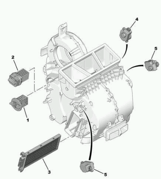

OK, you don't have an actual additional heating unit on this model if that is what you are referring to - here is the main heater housing in the car.
On the following diagram you have item (1) Heater Control Resistor and item (3) Air Heating Resistance.

That's the heating resistance unit as I know it - the term 'auxiliary heating' to me is the additional heating usually installed for colder countries, but I've used this picture as I'm guessing that's what 'Uncle Buck' is referring to richard

Yes I mean item number 3.

Marc - item 1/2 is the blower resistor.

Marc - I think it's one or the other, depending on whether it's got climate or not; I expect one is a resistor pack and the other a transistor based one.
