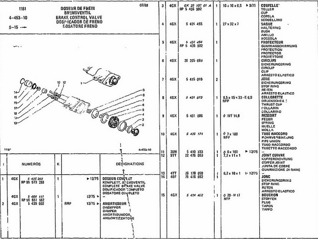

Anyway, back to the brake control valve damper. It seems from my butchers at the parts book that part 95 640 067 is for a GS/A from June 1981. Prior to that is a different number and I've a feeling they didn't even exist pre-1975. According to this thread http://www.gs-gsa.org/forum/forum_read. ... read=37618" onclick="window.open(this.href);return false; , something late DS might fit the bill.
Would this be the part?
http://ds21.eu/xcart11/product.php?prod ... =93&page=1" onclick="window.open(this.href);return false;
GS brake control valve:
Brake_Control_Valve_GS by macplaxton, on Flickr
GS/A brake control valve
Brake_Control_Valve_GS_GSA by macplaxton, on Flickr
The other things the parts pages point to is that 3 pieces seem to have become an all-in-one single part.

Late DS pages for comparison of numbers, some are the same:
Brake_Control_Valve_DS_Late_01 by macplaxton, on Flickr
Brake_Control_Valve_DS_Late_02 by macplaxton, on Flickr
Brake_Control_Valve_DS_Late_03 by macplaxton, on Flickr

On the GS parts page, it can be seen that the three items no. 2 (5 435 902 - Damper), no. 3 (GX 25 199 01 A - Cup, dimensions: 10 x 16 x 6.5 ) and no. 5 (5 424 454 - Protection) have been superseded by a single part - (5 435 902). Compare that with the DS page and you'll see that the no. 3 is the same part number (and dimensions) as does no. 5 - Rubber protection. No. 1is different, but the "old" number isn't listed in the GS page. However next to no. 5 on the DS is "R.p. 5 435 902 S" all of which points to a late DS one being the same as the GS one.
Looking at the books, your measurements with the very-nears along with Malcolms input, I think it's safe to say that the difference between these two parts is a 5mm (5.5?mm) hole and 6.5mm hole in the cup.

here are some picys i took from an OE repair manuaol i have
https://www.dropbox.com/s/r5rymp85a6d6x ... 5.jpg?dl=0" onclick="window.open(this.href);return false;
https://www.dropbox.com/s/hg2leei9zkt2c ... 7.jpg?dl=0" onclick="window.open(this.href);return false;
https://www.dropbox.com/s/xw0kdk8ulrkk3 ... 2.jpg?dl=0" onclick="window.open(this.href);return false;
https://www.dropbox.com/s/y1j46a66mek76 ... 2.jpg?dl=0" onclick="window.open(this.href);return false;
hope they are of use if you aint already got these
another really silly/stupid question
you have fitted the dosur with the rubber protector towards the pedal???

Thanks Malcolm, I do have that book along with its companion 008102, and a Hyena's, and a 'Databooks'.
I'll turn that unit over tomorrow. That way it will match what is shown. It's all that's left. I'll be gobsmacked and relieved if that's what it is.
