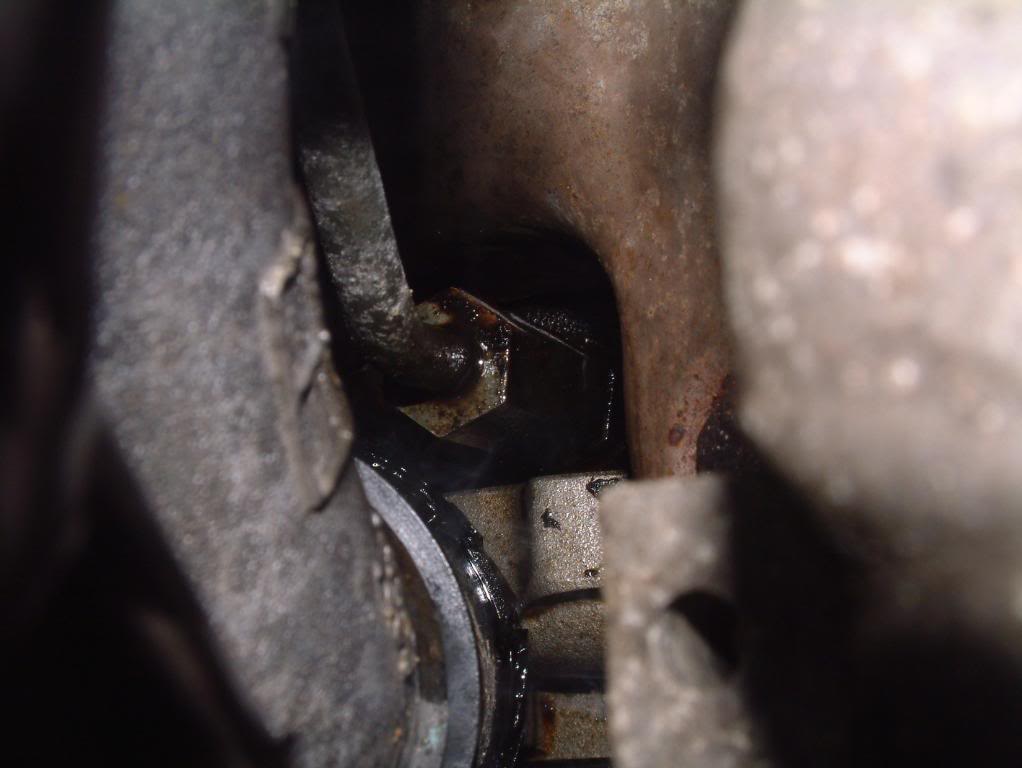

I looked again and saw this -
Oil 'apparantly' leaking from the oil feed pipe. I tried to nip it up with a 17mm but it was already very tight. Cleaned again with degreaser but yet again when i put my foot down it was leaking oil from somewhere.

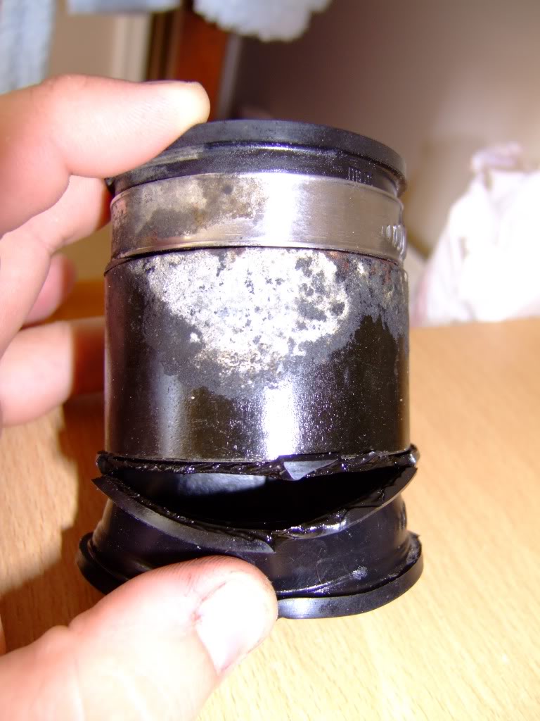

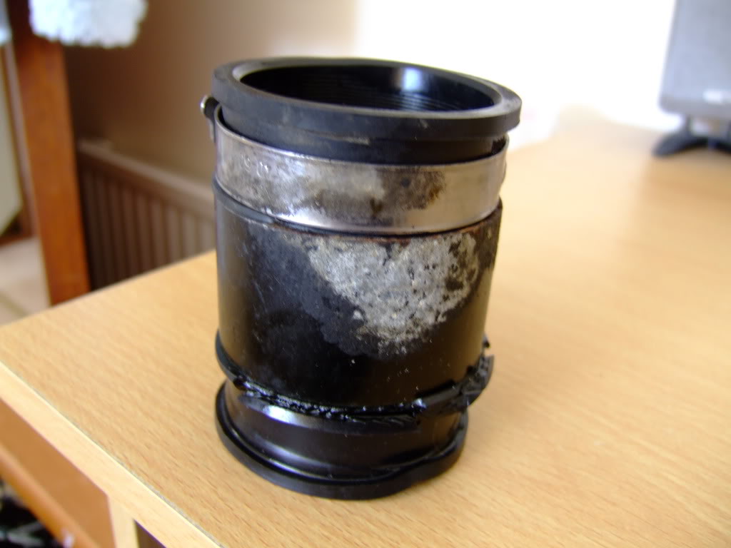

This is the connector piece between the turbo and alloy boost pipe that goes to the intercooler and then after that, to the throttle body. It has a metal insert in the centre to reinforce it.
It has seen better days -
Completely split at the bottom, so under high load and boost, was blowing out a little bit of oil onto the exhaust manifold and directly inline with the oil feed!
Heat and age must have got to it. It will have also been losing a little bit of boost, so its a shock to me considering how well it goes, been like it for a while.

The oil is just residual sitting in the pipes and it only takes a tiny amount to create a lot of mess and smoke! Oil feed moves slightly if you wiggle it but almost certain its not leaking, its rare for it to do so.[/url]
