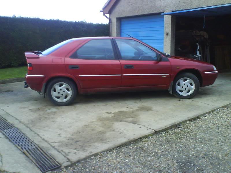

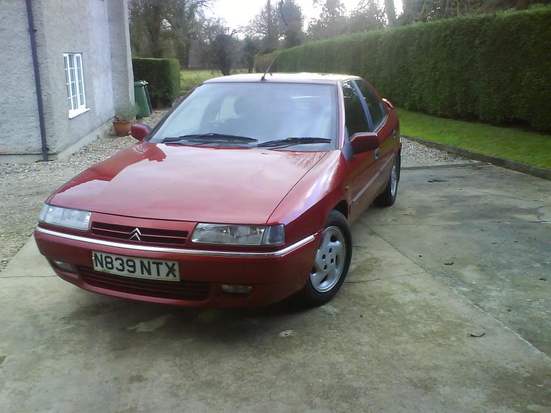

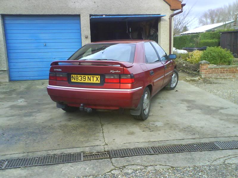

Have you got any pictures you could post?
