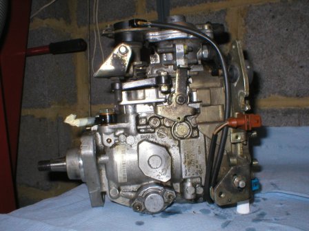

The EPIC was only used on the 2.1TD engines in the Xantia, later XM and 406. 1.9TD engines in the same cars invariably had the Bosch VP20 pump. Earlier 2.1TD engines fitted to the XM and some PSA white vans had a mechanical Bosch pump fitted.
The VP20 is the Bosch mechanical pump with electronic timing control fited to many 1.9TD engines in PSA vehicles. Sometimes it's known as the EP-VE or VP20-AS3. There is a very similar pump to the VP20 that is fully mechanical and found on pre-1996 1.9TD engines. Confusingly also known as the VP20. These are the best bet if you contemplate doing a mechanical pump conversion on a 2.1TD.
This is the VP20-AS3... The mechanical VP20 looks virtually identical but has an electical timing device on the side.
