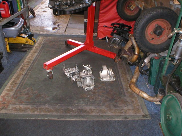

Nothing nasty found just yet Alasdair bar the oil leaks from the cam boxes.. Today I'll have the camboxes off and see what the cams and interior look like...
One thing that's quite horrible is the engine wiring loom. All the outer plastic Anaconda tubing is badly hardened and cracking up so I'll have to re-do the loom. Thankfully the underlying wiring is fine, just the outer wrappings are rough... I'll be on the lookout for some pukka loom wrapping tape and learn the techniques to do it properly...
James, I really did enjoy myself Won't enjoy myself quite so much during the cleanup of all the muck on the engine but will be enjoying myself once I start the reassembly!
Mike, I concentrated on stripping in this session. As I reassemble cleanly I'll be taking lots of pictures.
David, it's just those E10s that are tight, once off the hubs come off easily and it makes the job so much easier. I don't quite see how the camboxes can be properly resealed without removing the cam hubs...
Before the question is asked, I'm not painting any part of the engine. Firstly I'm allergic to paint and secondly I don't like painted engines - I prefer them as nature intended.

I didn't take the cam hubs off when doing mine, the shafts lift out easily, and the seal can be guided back into place on reassembly.

Your cam covers must be of a different design then Mike because there was no way I could life the cams out without removing the hubs...

No chance of a bike ride today as it never stopped raining so I just kept cleaning the engine and some of it's ancillary castings..
This is the result:
It is so clean now I can now continue working on it dressed in my Sunday best without fear of getting mucky...
Next job, cambox resealing... I will very carefully photographically document that but for now some very valuable groundwork has been completed
This is the result:
