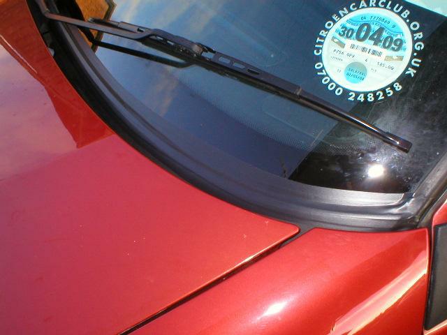

My Activa is on the moist side too. Doesn't feel wet inside, but the scuttle seal isn't the best (looks spongy as someone else on here described).
The car can mist up suddenly as soon as the fan air hits the windscreen. No, it's not the heater matrix - was changed by Citroen last year. Is there a drain on the air conditioning that can block up somewhere?

Failed scuttle seals are insidious :twisted: You can feel no wet on top of the carpet as it is all underneath and the sound deadening foam soaks up literally gallons. You have to lift the door seal and lift the carpet and put your hand right under the carpet. If your hand comes out wet, you have the dreaded task of then pulling all the carpets out. That means seats out and centre console out.
Luckily, the damp rarely makes it under the drivers carpet but it's worth a check. It does seep into the rear though so the back seat bases have to cvome out to lift the rear carpet. You need to prop the rubber membrane on the bulkhead up so that air can circulate under it.
The job must be dome as wet gets in the wiring loom and alarm box eventually. The only good thing is the floorpan does not rust as a result.
You then need to drive around for about a month with a stripped interior whilst it dries out. Race look Activa :lol:
A misty screen with the blower on is a sign...
There is a heater box drain for getting rid of A/C condensate and you have to be careful not to break it when replacing the matrix. It can be seen up by the steering rack, looking like a little rubber pigtail. You have to get right under the car to see it.
I hope, pray, you find yours nice and dry...
This will now be my third time of drying out a Xantia. Both my 1.9TD and my first Activa suffered. Happily my 2.1TD is bone-dry (I think/hope)..

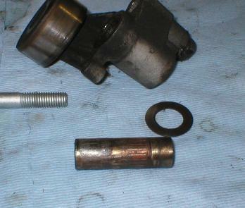

Today has been a extraordinarily good day :D At first light I got cracking on the 2.1TD aux belt tensioner problem and was soon joined by Richard (DickieG). By that time I had the car up on stands, wheel and mudshield off and the top bolt out of the spring. The lower spring bolt, deep in the HP pump and alternator casting was causing a problem. Due to the close vicinity of the oil cooler pipes and other bits and pieces, access was just a little poor. We cracked it in the end by loosening it was a normal Allen key and then used one of Richard's ball-ended Allen keys to wind the bolt all the way out. After that, it was plain sailing and the tensioner assembly will just wiggle out between the chassis leg and engine without disturbing the engine mounts :D
Getting the spring bolts back in was a bit tricky as the springs needs to be compressed a little for the bolts go go home.
It is very much a two-person job as to do it solo you'd need to be an Octopus :lol:
With the new tensioner, the belt tensioned as per book perfectly :lol:
The old tensioner was well worn on it's bearings and here you can see the ridges on the sleeve that made it behave like a ratchet!

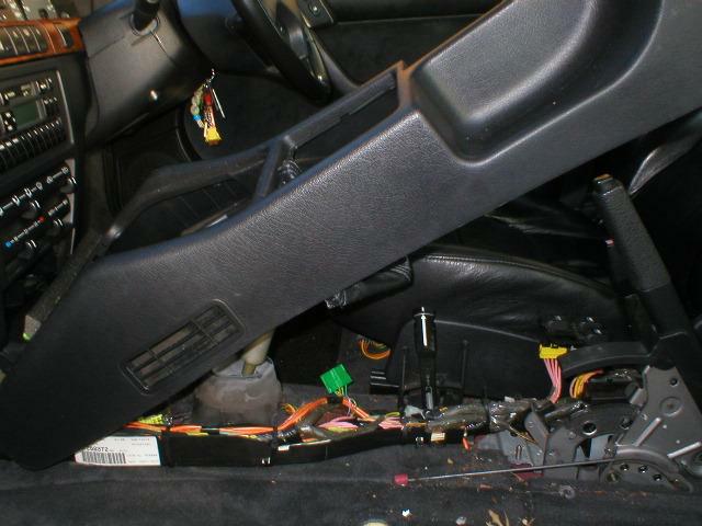

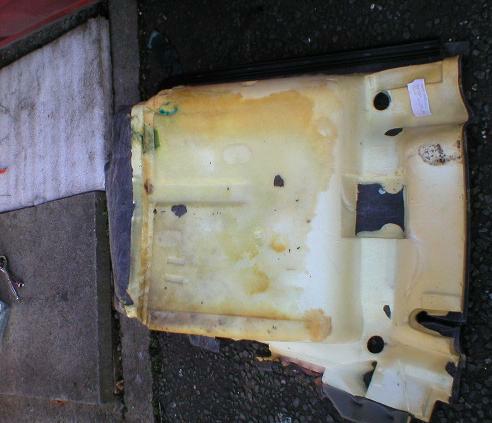

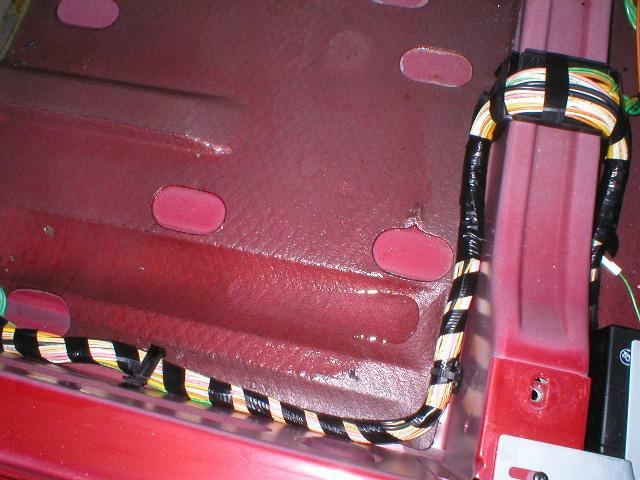

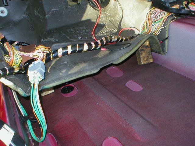

This afternoon I removed the passenger seat and carpet out of the Activa to assess the water damage from the leaky scuttle seal. My luck was in and I'd caught it early, before the water had got into the rear footwell :D :D Only the passenger side was wet and no wet in the electrics at all! Here's the puddle...
Caution, watch that plastic cable tray on the crossmember. It has a sharp edge on it which resulted in an inch-long cut to my little finger :twisted:
And the extent of soak into the carpet foam...
One of the big problems is the foam-backed "septum" (the bulkhead sound deadening layer) gets soaked and this cannot be removed without pulling both dash and heater box out. The fix is to prop it up with wooden blocks so that air can circulate under like this...
Finally, and until I can get some good sealant, some tape was applied to the scuttle panel to keep further wet at bay...
And to prove the centre console can be removed without disconnecting the handbrake cables at the calipers (as the BoL tells you) here's the proof :D
