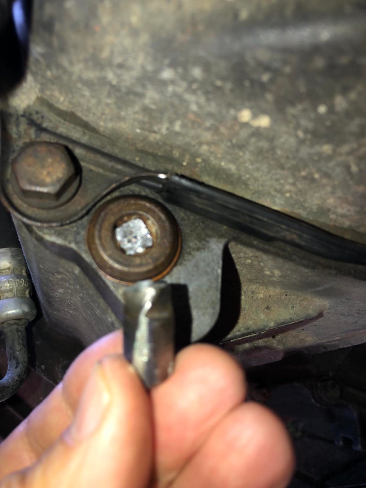

My sAXo gearbox oil had to be replenished after I changed a lower balljoint prior to the last MoT, I had left too much tension supporting the hub to release a stubborn bolt, when it let go of it's grip the tension pinged the driveshaft out of the gearbox
£20 for fresh oil nowadays
Maybe next time
I also discovered a well seized level plug that destroyed my square drive and has kept hold of it
(filled via the breather, which came off easily suggesting it was the prefered option)

Been there and done that so many times SkullSkull wrote: 30 Sep 2024, 10:24 My sAXo gearbox oil had to be replenished after I changed a lower balljoint prior to the last MoT, I had left too much tension supporting the hub to release a stubborn bolt, when it let go of it's grip the tension pinged the driveshaft out of the gearbox...
...I kind of wish I'd opted to undo the hubnut ...
Maybe next time![]()
So many people use a super-fit gorilla to do up drain and level plugs in my experienceSkull wrote: 30 Sep 2024, 10:24 I also discovered a well seized level plug that destroyed my square drive and has kept hold of it![]()
I've refilled many gearboxes via the breather and via the revering light switch although these days I do AX 'boxes through the level plug using a funnel with a length of clear plastic tube on the end.
I first used this technique when I was rebuilding 4HP20 autoboxes and in fact the (proper traditional) oil jug I use has 'LT71141 ONLY' written on it in bold... I felt a minuscule quantity of ATF in an AX 'box would not hurt...
Absolutely... Gearbox oil doesn't really deteriorate or get contaminated like engine oil and if you are spotlessly clean draining and refilling - and the oil looks fine - then no reason not to reuse... I have been doing so for years...Skull wrote: 30 Sep 2024, 10:24 £20 for fresh oil nowadays(I prefer your option Jim to re-use if clean
Naturally, if it looked tired, contaminated and clearly past its best it would be changed.
I was pleased to see the magnets had very little swarf on them

I managed to source fully synthetic 75W80 gearbox oil relatively cheaply (in bulk, 20 litres) off eBay.
I'm a fan of changing it, equally I've yet to have some come out of a gearbox (at first change in my ownership) that's looked anything like sensible to reuse!
Usually opaque, grubby dark brown to black, and sometimes much less than required! Last change I think was about a litre came out, should have been double that

Now if I had got 20l of 75W80 at a good price I'd have swapped Strawberry's gearbox oil without a second thought
