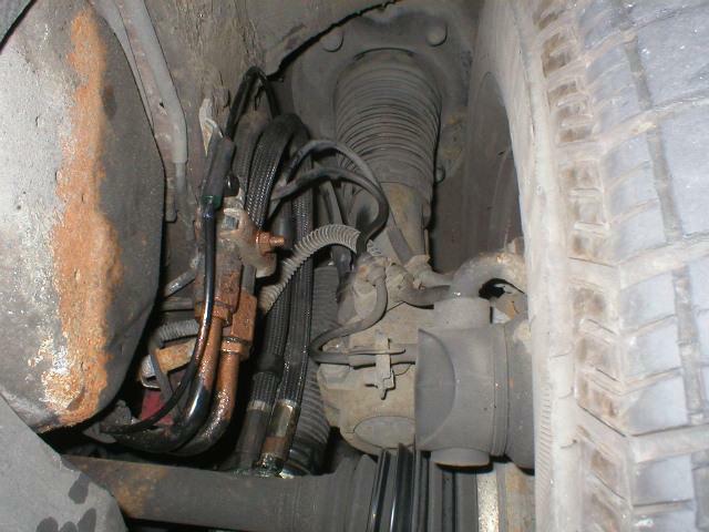

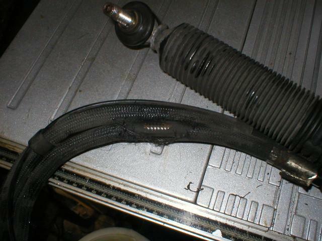

I thought one of the front Activa ram pipes looked a bit awkward and chafed. Closer inspection certainly showed it had been chafing. Have a look at this! That was as a result of the pipe rubbing on the strut.
:shock:
Down to the inner core. I dread to think what would have happened if that had let-go on the road...
So, it was off with the ram and fit a replacement hose. Luckily I had a good used one in my stash.
Those ram pipes are strange. One is longer than the other and to which ram port the long one goes to is critical to them laying correctly. In typical Citroen fashion, what seems to be the logical arrangement is not correct :roll: Go the illogical and non-intuitive path and it's correct!
This is a shot of the pipes now laying nice and clear of any metalwork at normal ride height.
The brown on the metal pipes is not rust, it's copper grease!
The correct fitting order for the pipes is as described here.
I recommend all Activa owners to check their pipes at the earliest opportunity...
