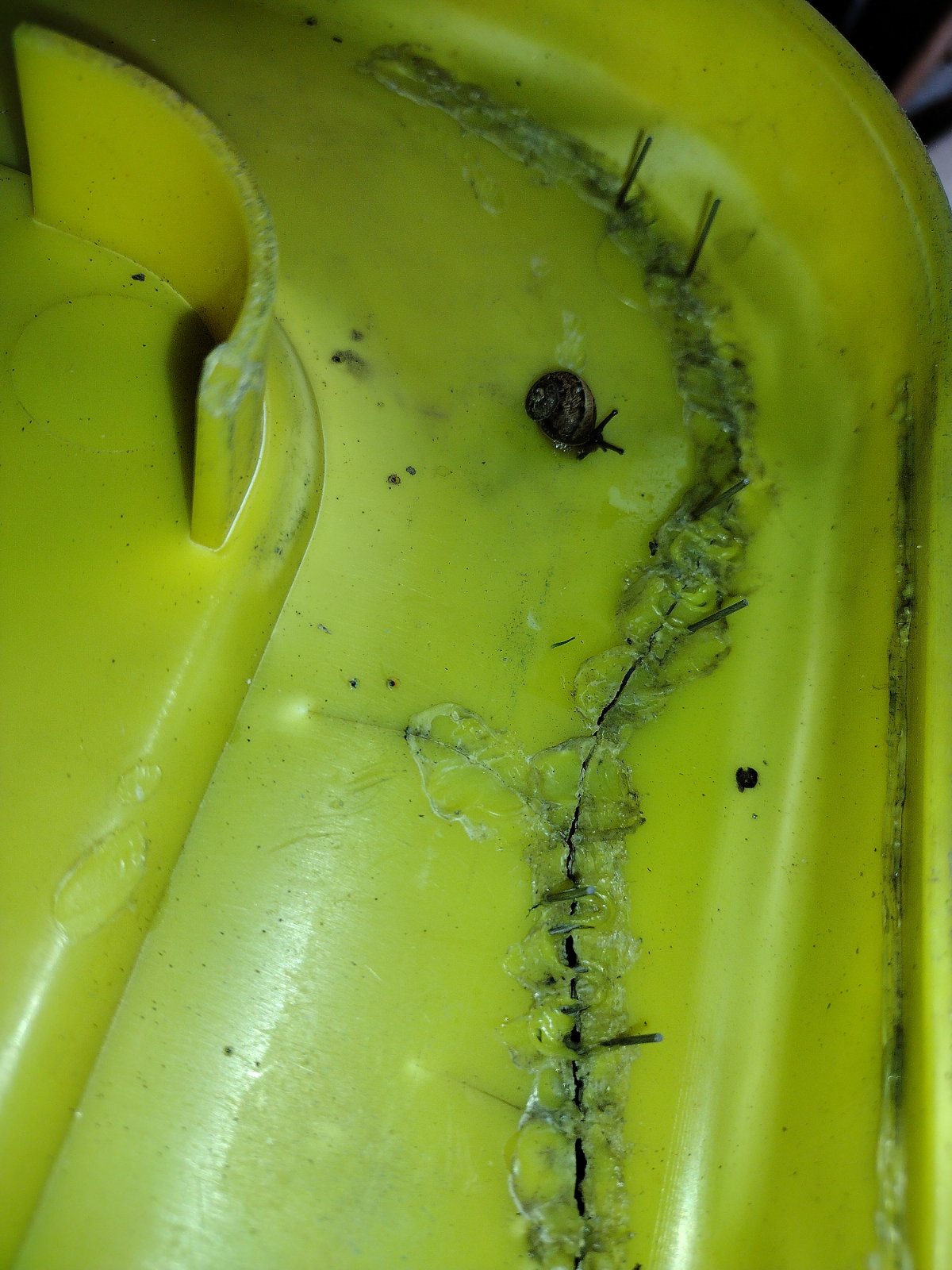

Plastic hot staple machine update:
Very quick test of my gizmo this morning, works well. The white LED on mine is lit continuously. No rear red LED here. Fuse like others is marked 13 amp and plugged in without a few fuse gives no life so thankfully not a fake fuse holder!! Swapped for a three amp.
Incredibly tatty recycling bin lid the first victim: worked okay. Have also put a couple of staples in to the machine's case to fix on the missing corner.
Hopefully my little friend approves!
Mention the broken case to the seller: no reply whatsoever!
Can see me eating through the 50 staples of the useful "big wiggle type" in no time.
The cutters don't seem to actually cut the ends but useful for for encouraging them to snap off (can do it equally well by hand though a little hard on fingers)

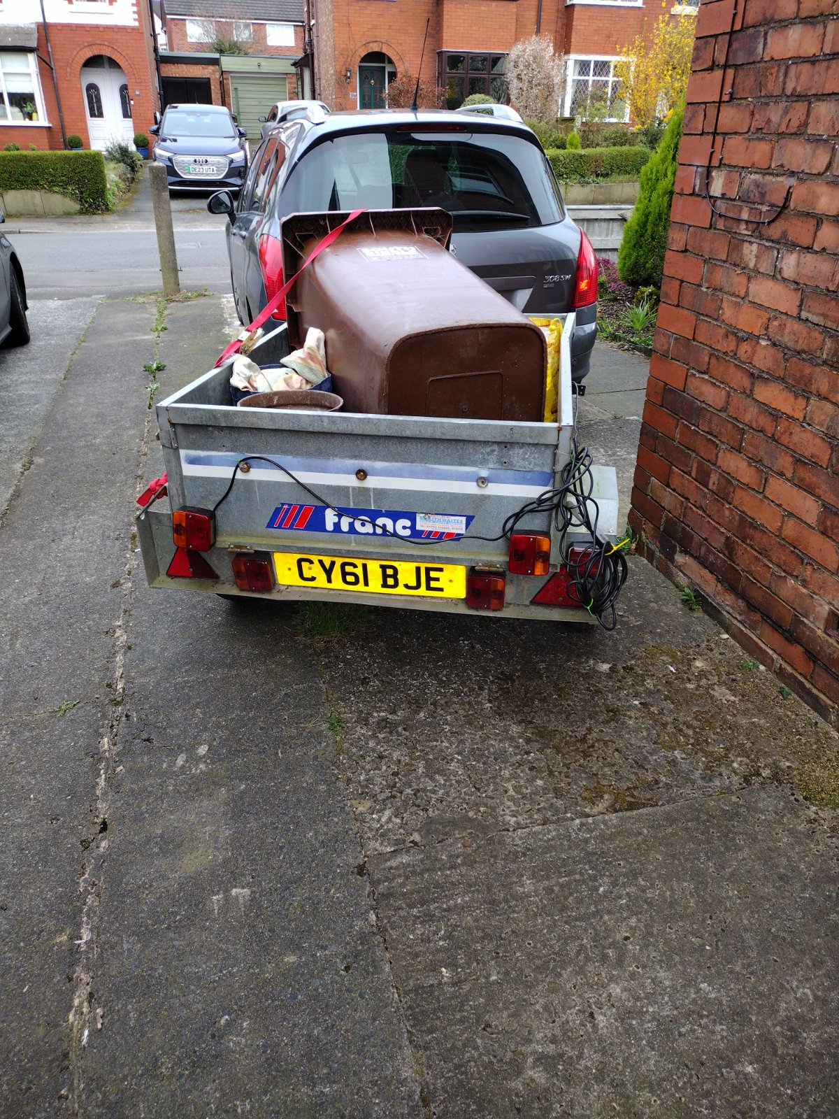

Successes:
308 SW towbar clipped in and little trailer taken for a tip visit - garden waste.
Dart Charge have written to confirm at last that they agree the tiny silver Aygo pictured is not in fact my but black C5 estate so they are closing "the case"
Steps backwards:
Back home after tip (forgot to take a picture of the full load)
As can be seen wasn't hassle free as trailer's built in lights refused to function. Much faffing with a needle file on the very crusty terminals / bulb holders (new about 4 years ago :( ) got indicators both sides to light, but nothing else co-operated.
So magnetic ones again to the rescue!

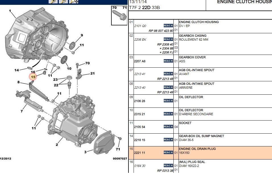

From the parts thread:
RichardW wrote: 26 Mar 2024, 08:00 Matt
Drain plug seems to be M16 x 1.5mm thread, but it doesn't give a length.
Pasted here for (my!) Easy reference and a post link to the answer on that endless thread!
viewtopic.php?p=794927#p794927

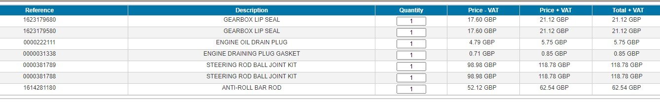

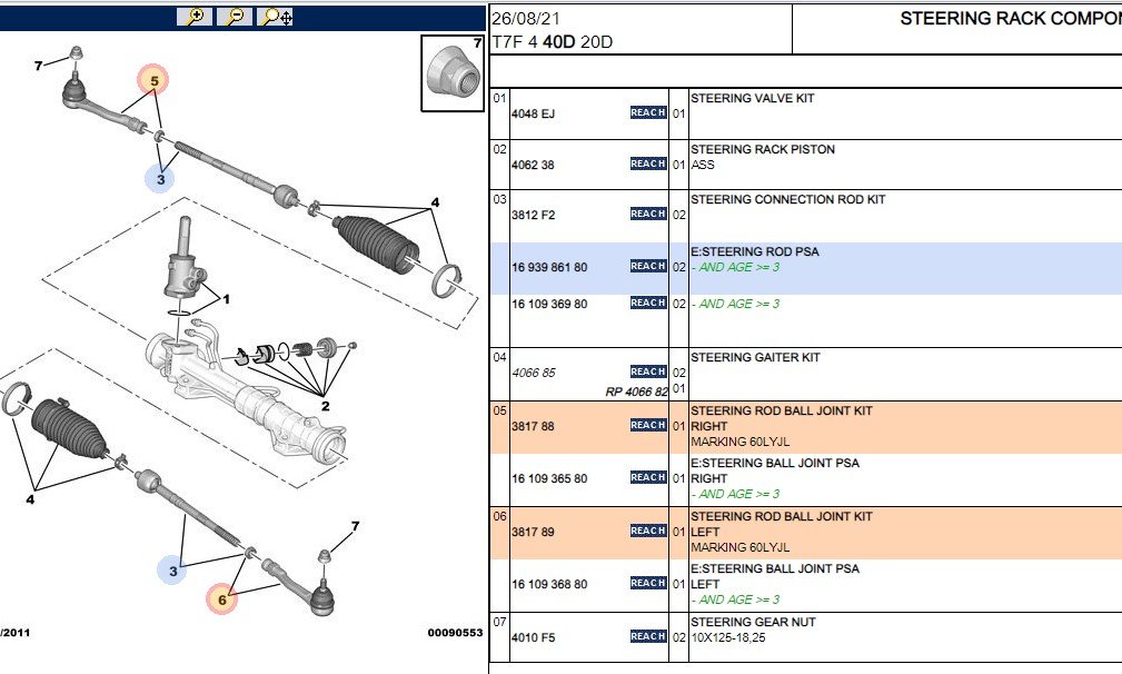

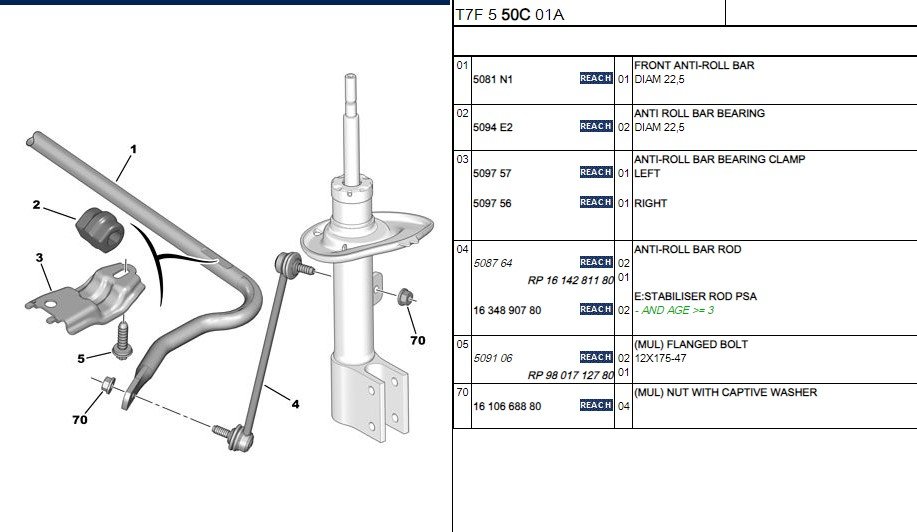

Part numbers for possible knocking noise sources (will get it up in the air over the upcoming bank holidays hopefully to diagnose) and possible gearbox oil leak sources, again will have to have a look, but driveshaft seals a prime candidate.

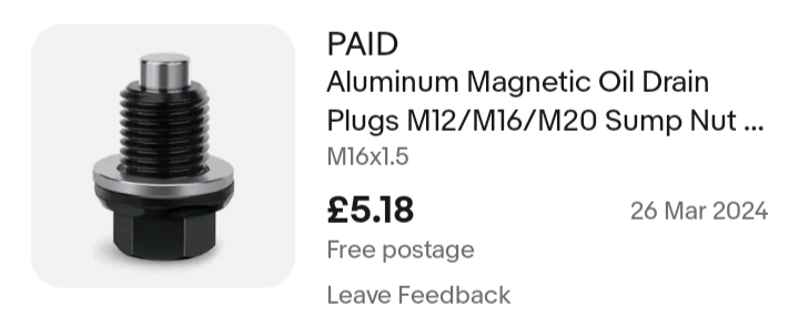

Sump plug for gearbox (M16x1.5) magnetic version on order:
Price for two
Price for two
Bought a couple as same size for HDi Coupe and the 308 SW gearboxes.

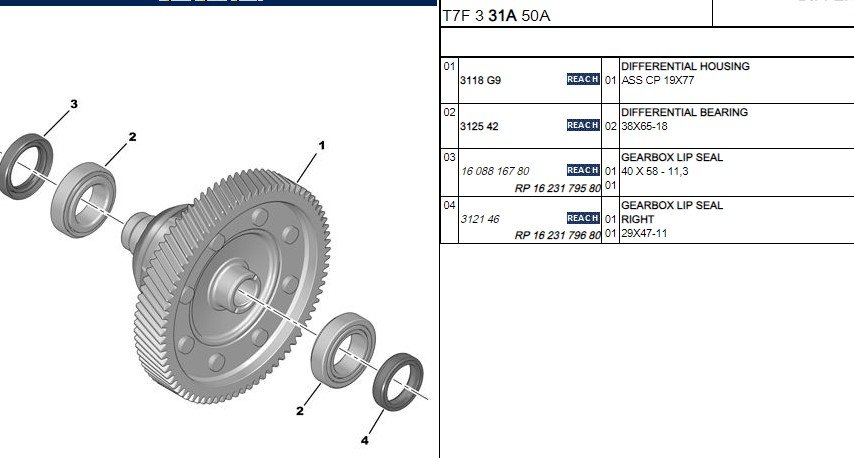

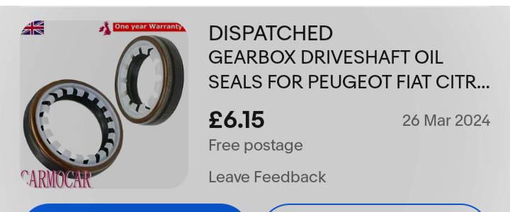

Driveshaft lip seals also ordered:
Lip seals
Lip seals
The larger one is 9 mm wide Vs 11.1mm but should be fine (just don't push it in as far)

Brief updates more later when I get chance,
308 SW
knocking noise: driver's side track rod end is the culprit fair bit of play in that!
Gearbox presumably leaking as quite a bit of oil all over the (installed for a week or two) undertray.

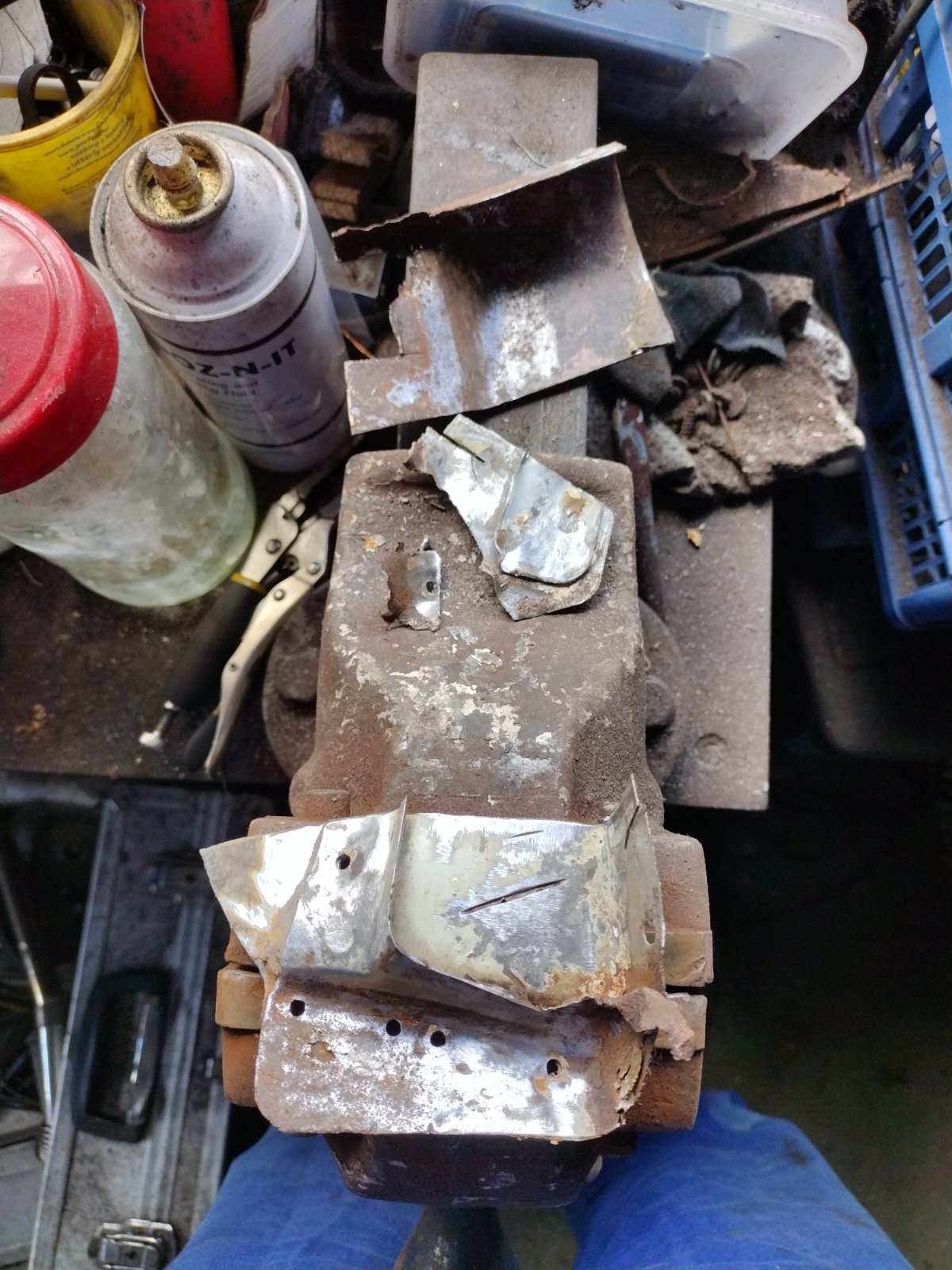

Bit of coupe tinkering today:
Can you tell what it is yet?
Posts: 28690
x 5674
Looks suspiciously like
Spoiler: show
the remains of the Baltimore bridge
