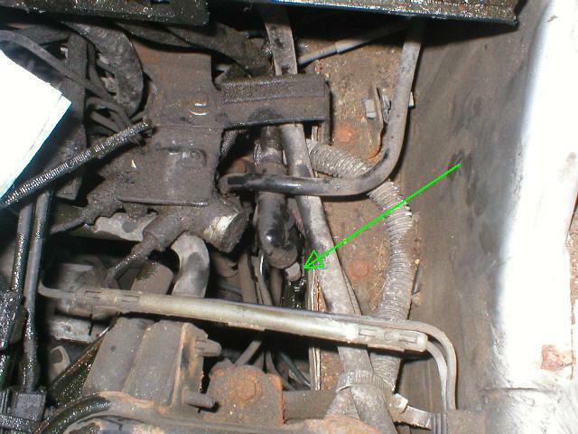

Noticed a small pubble of LHM under her this evening, in the vicinity of the front ram :(
Nope, not the ram. That's bone dry :) The source of the leak was somewhat higher up. It looked for all the world like the anti-sink valve had gone :evil:
But no, nothing so easy as that. I had the LHM reservoir off to have a look as I could not see from under and found a split leakage return pipe. A split on one of the moulded rubber pipes that take leakage from the front struts up to the reservoir.
It's going to be a fun job fixing that as access is not terribly good. The rubber, as usual, had split where it joins the metal pipe.
Here's where it is, by the green arrow. Other LHM in the picture is from where I removed the reservoir.

Bad luck Jim :(
I see what you mean about access....Looks like a treble jointed hand job :lol:
You will nail it though :wink:

Fixed the LHM leak from the strut return pipes. Luckily there was enough spare to enable the pipes to be trimmed back and reterminated. Heck of a fiddly job though.. I cleaned the LHM filters whilst I had the reservoir off, not that they were dirty though.
