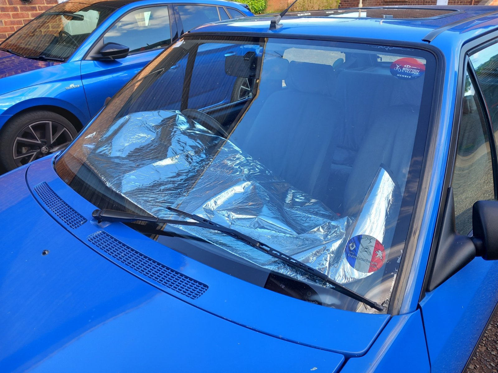

As she's outside for a bit and all this bright sunshine does her dash no good, precautions have been taken ;)
Once the carport is up and Pix is rehomed, this will not be such a problem. It'll be nice and cool and shady in there...

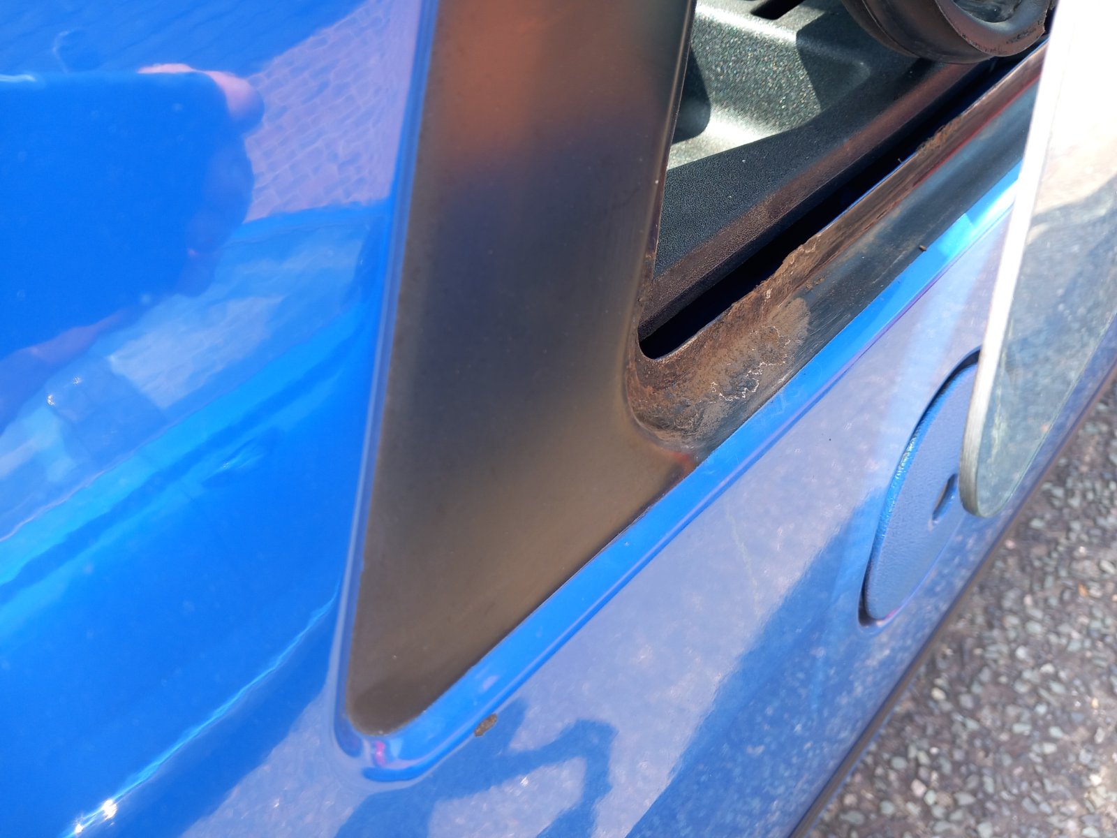

I've been able to do a bit of light stuff on Bluebell today and as its been seriously hot and sunny; a perfect day to do do a bit more on her rear window flange rust-proof and repaint.
First job was to drive (in Bluebell, naturally) to Halfrauds to get some paint. Now it's an age or so since I last set foot in Halfrauds but I was shocked. It's not the shop it was any more. It seems to be a boutique for modern car tat mainly, with the serious stuff poked into a dingy corner.
Still, I got my paint. A can of anti-rust zinc primer and some satin black top coat.
Now, I'm not the world's best at painting although I'm keen to try to learn and improve. Where I'd be painting today is more or less hidden so I could practice without much risk...

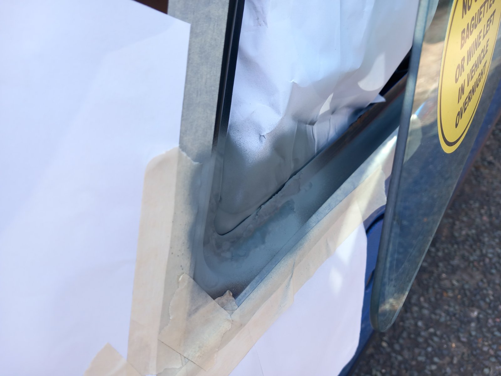

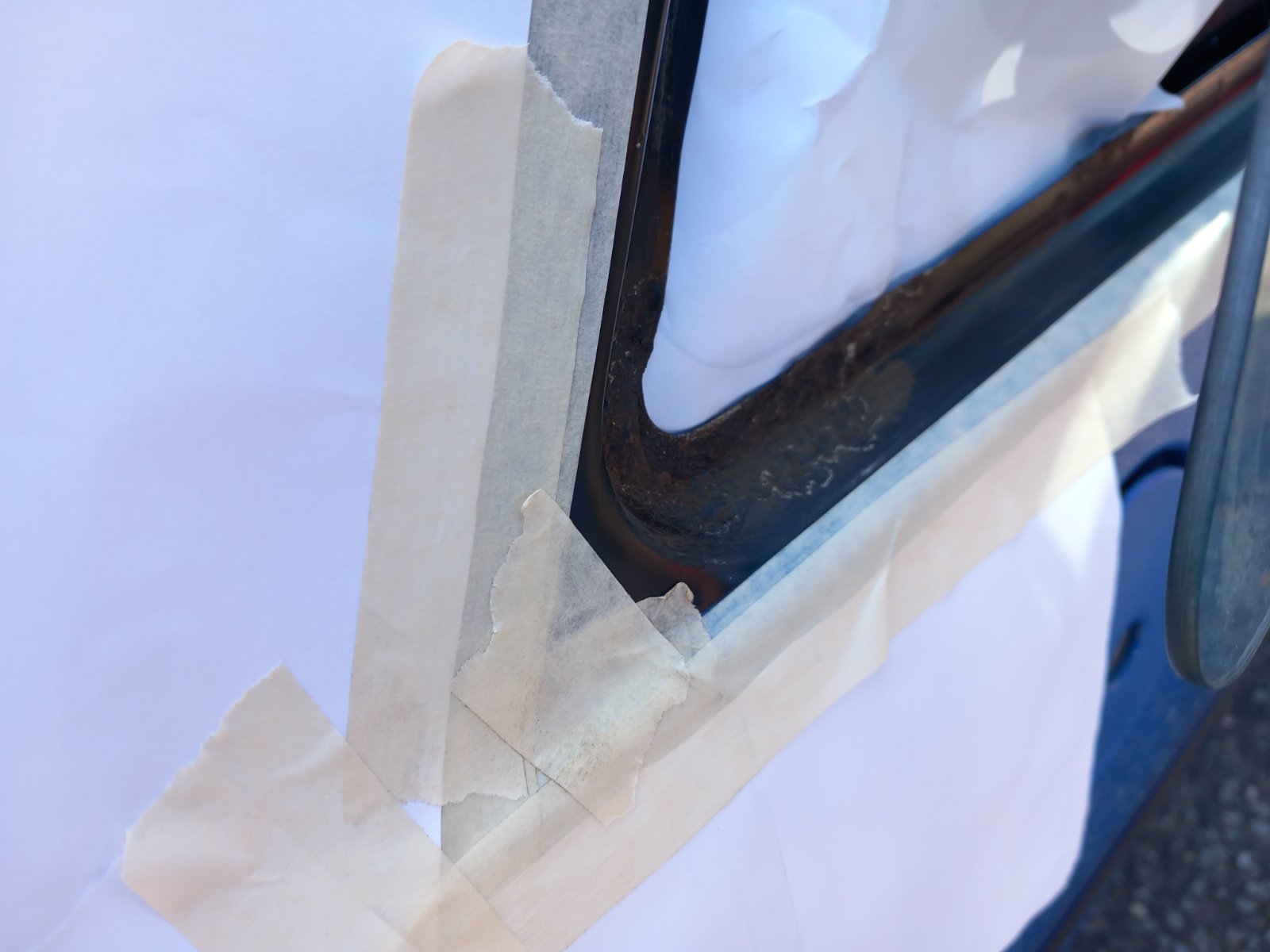

First job was to pull the rear window weather seal up off the flange:
Rust removal and killing had already been done using a phosphate-based treatment...

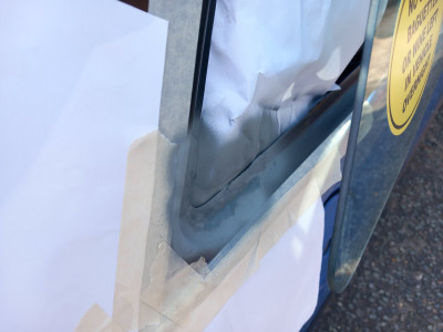

Masked up:
Primer:

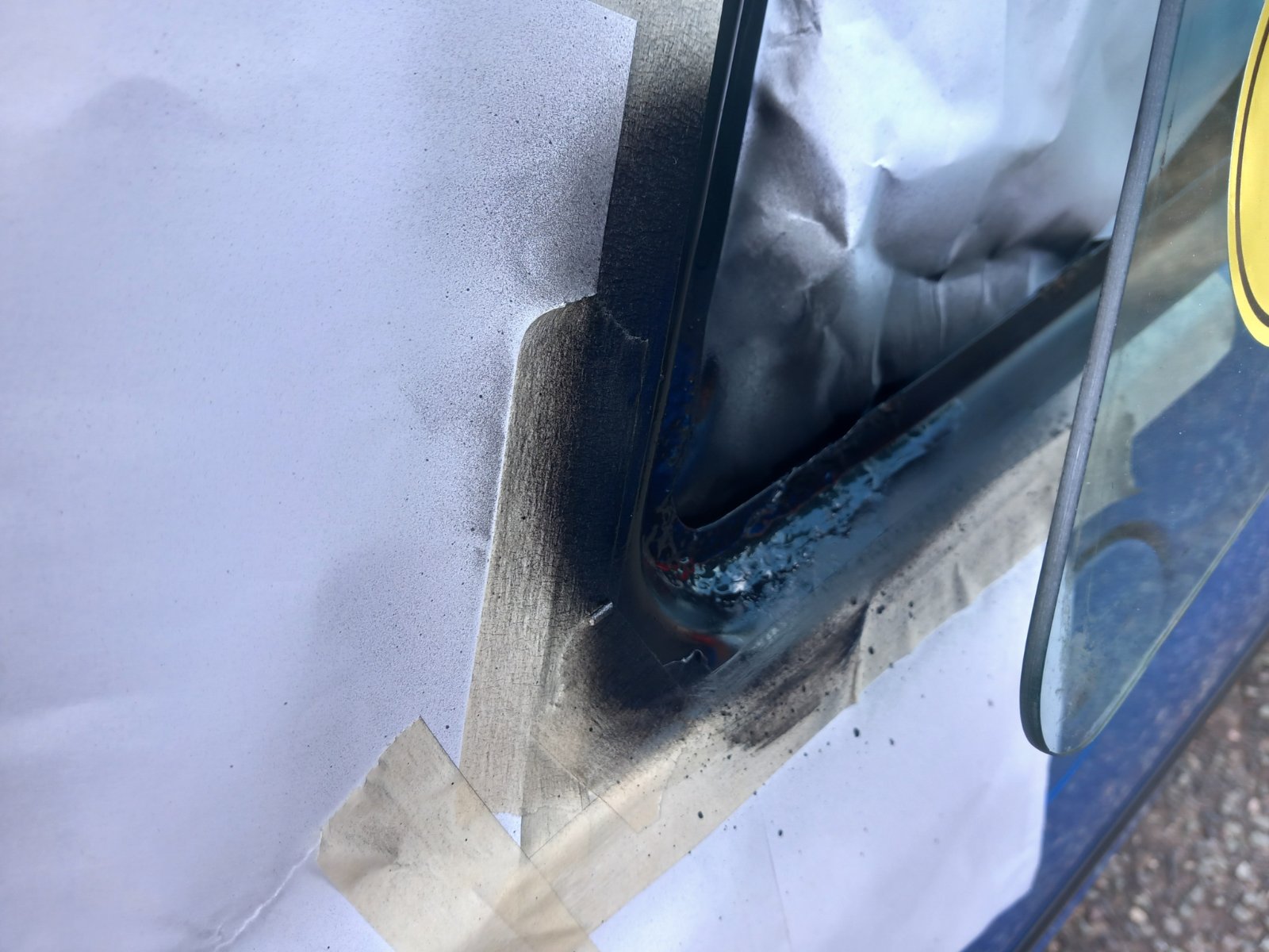

Top coat:
It's OK, not perfect but will do for now... Not bad for a beginner...

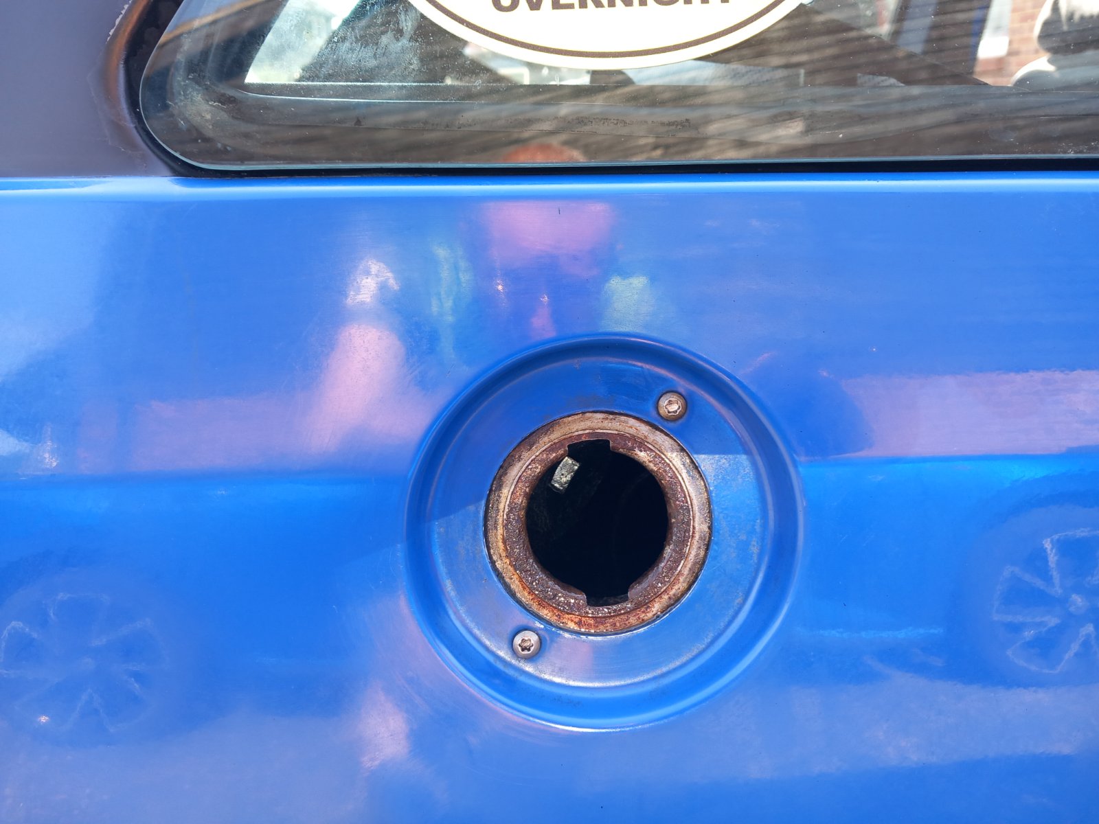

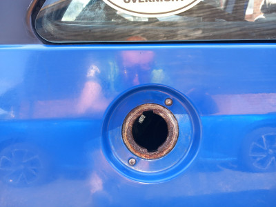

Whilst I had the can of Bilt Hamber out, I gave Bluebell's fuel filler a bit of a re-treatment. This is a place were the AX can rust alarmingly and mine was a very surface rusty here when I first got her. She is all very structurally sound around her filler and it looks a lot better now that it did. Another application of the magic fluid didn't hurt though :)

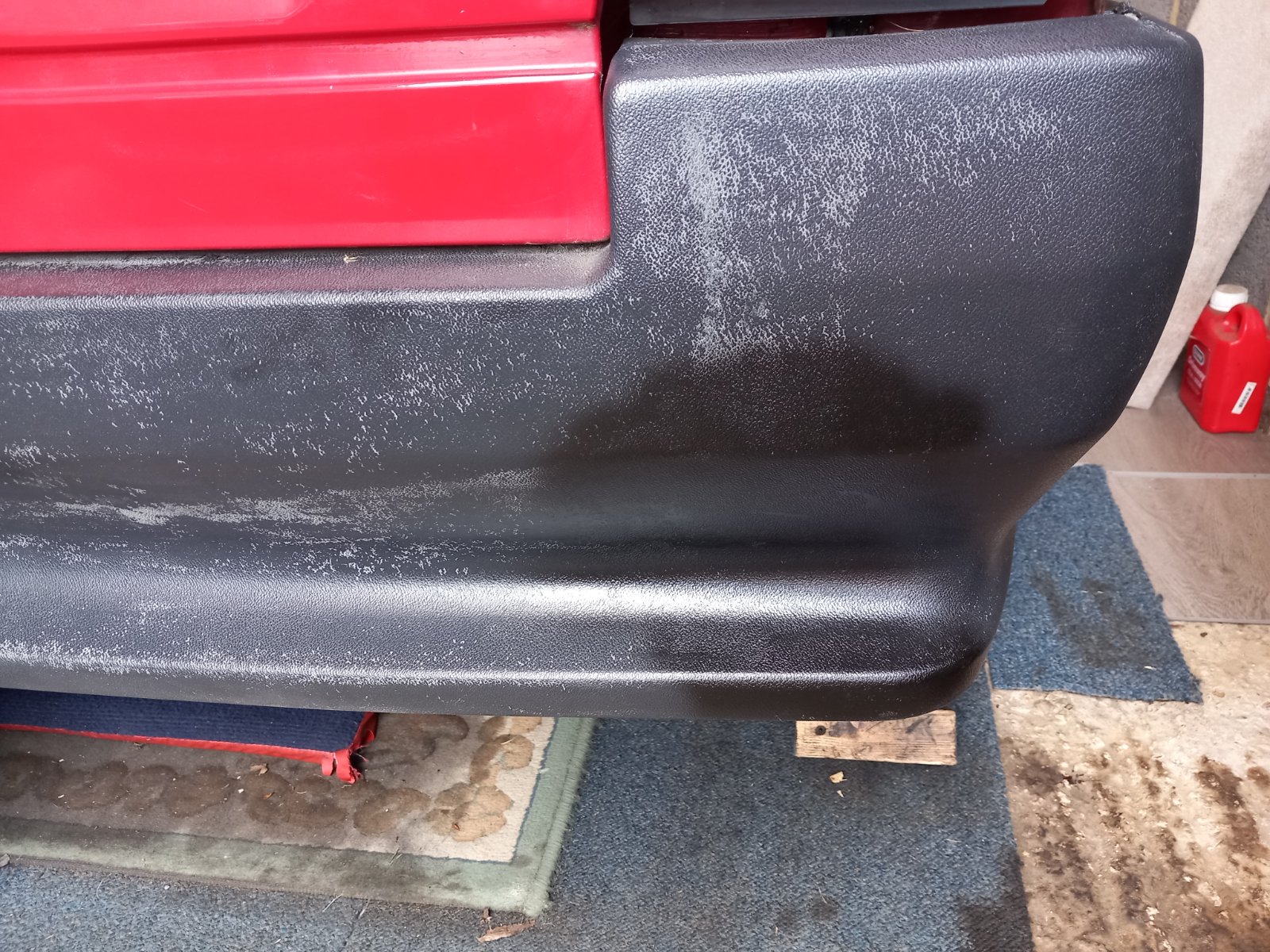

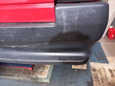

Finally, for today, whilst I was waving a can of satin black about, I tried a bit on Strawberry's rear bumper... At some point, her bumpers were painted - incorrectly really as they should be natural self-coloured like Bluebell's.
Her rear bumper is a bit patchy so I did a little test spray to try and gauge what it would look like..
It looks OK but the black is too black. It really should be a very dark grey ideally.
