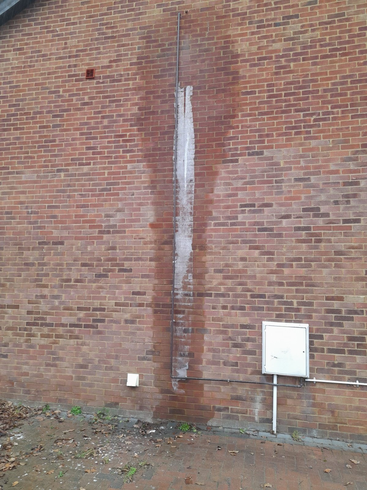

On the general subject of domestic heating..
My neighbour's attic mounted (as is mine) gas combi has been venting from its overpressure/safety valve for around three weeks now and has created this impressive icicle all down the wall...
How the boiler is still working is a mystery to me... It must be as they have a young family.
As it was installed by the same engineers as mine at around the same time I expect it's the same one I have. A Glowworm...
Must be a bloody good and bullet-proof boiler...
Been keeping an eye on mine but it's not suffering this affliction...

My old one, replaced 2021, was doing the same. Pressure vessel collapsed.
Had to fill it up every day. As it heated up it would chuck water out then as it cooled the pressure would drop to zero and stop the boiler lighting.

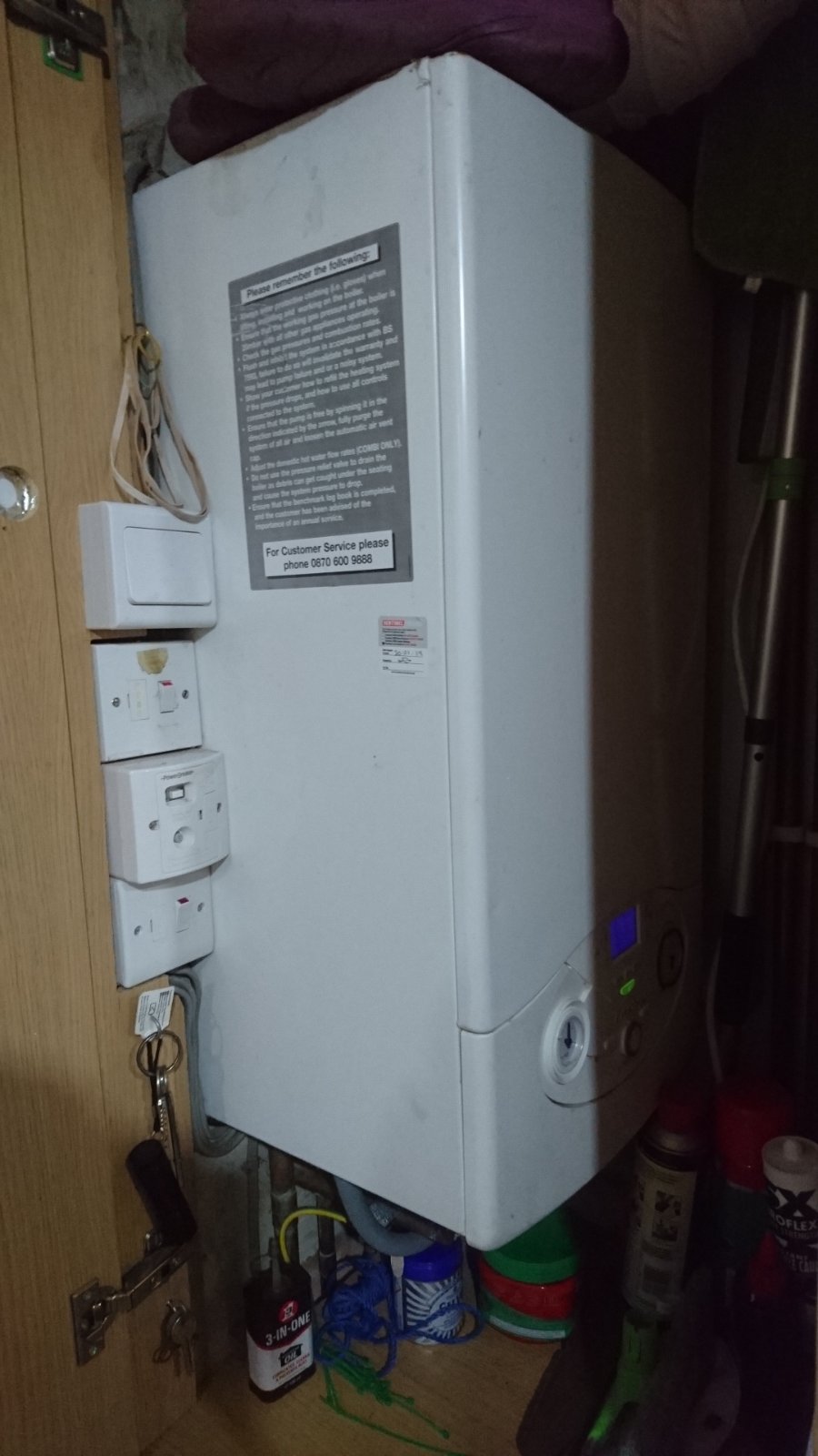

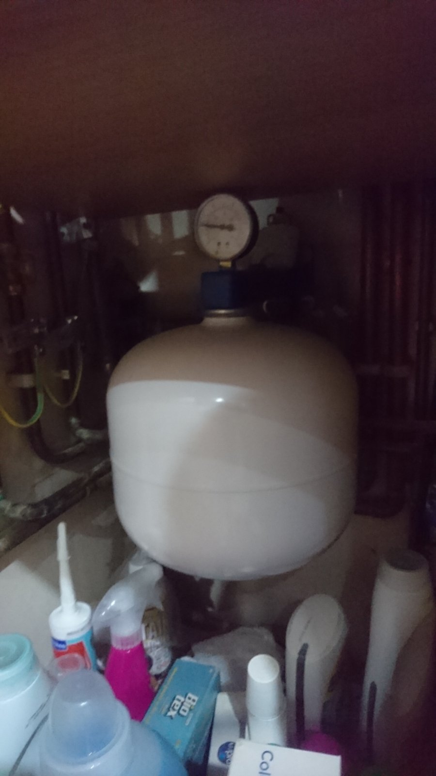

I'm guessing he keeps repressurising on a daily basis if its losing that much. After our current boiler had been in for 5ish years it started venting from the expansion chamber within the boiler and losing sufficient water to warrant a weekly top up.CitroJim wrote: 25 Jan 2023, 14:31 On the general subject of domestic heating..
The main problem is simply that the integrated relief vessel was simply too small to cope with the volume of our system so I installed an auxiliary pressure vessel below the boiler and now it only needs a slight top up every 9 months or so. Much more efficient as the new vessel can easily cope with the systems total expansion!!

Ohhh-errr , that is a big sphere you have there Sir !

My neighbour must be up and down his loft ladder like the underwear of a practitioner of the oldest profession
My system has no expansion vessel Mick, save the little one in the boiler, and like you, it's a rare event that I need to top mine up. Every six months or so...
