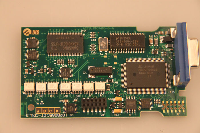

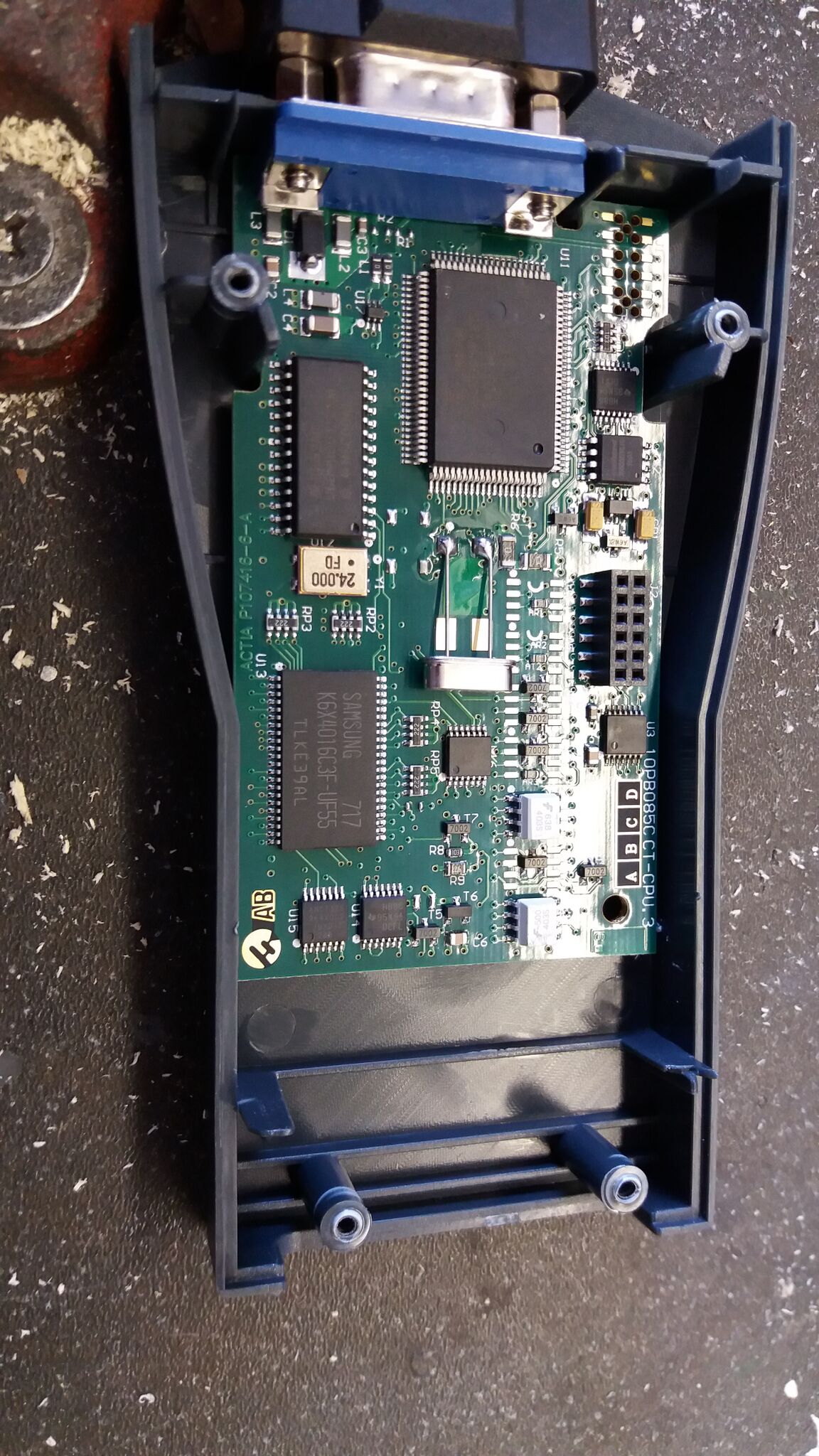

[img][/img] I think what you should see is the inside of my Lexia

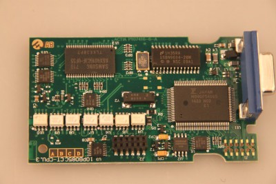

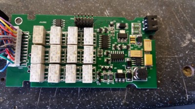

Well the first picture is certainly looking to be missing half a dozen chips - look on the PCB on the edge where it says ABCD just under there you can see half the Optocouplers are missing when compared with the following!
- x 6963
Re: Merged Lexia & Diagbox threads
I don't really need to look any further than the first picture, that is definitely not a full chip revision C unit Renegade, sadly, so the first thing you should do is downgrade back to the previous version of a Diagbox as this firmware will not work properly with this hardware and may cause other problems.
It is highly unlikely that the other components are there either.
Time to invest in a new Lexia I think
