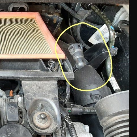

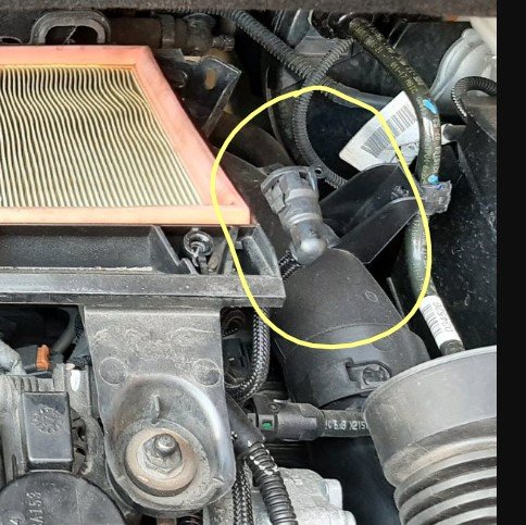

Re: Citrojim's AX, Pixo, C3, Running and Cycling Tales
How did you get that breather pipe off the air box, Jim?
PSA seem to have developed some magic pipe that no one can release - I couldn't get it off when I did our Picasso last, and looking at Blue HDi air filter changes on youtube shows that most are broken - and as I recall, even the main dealer broke the one on David Hallworth's car! I've seen a suggestion that pressing it in first then squeezing the clips helps, but sure I tried that, I also seem to think twisting it first may help.
That connector is definitely fiddly and there's a knack to it Richard!
It took me about 20 minutes today...

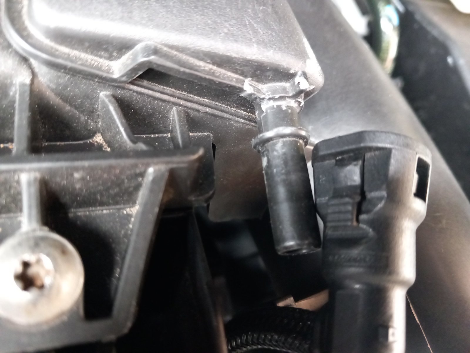

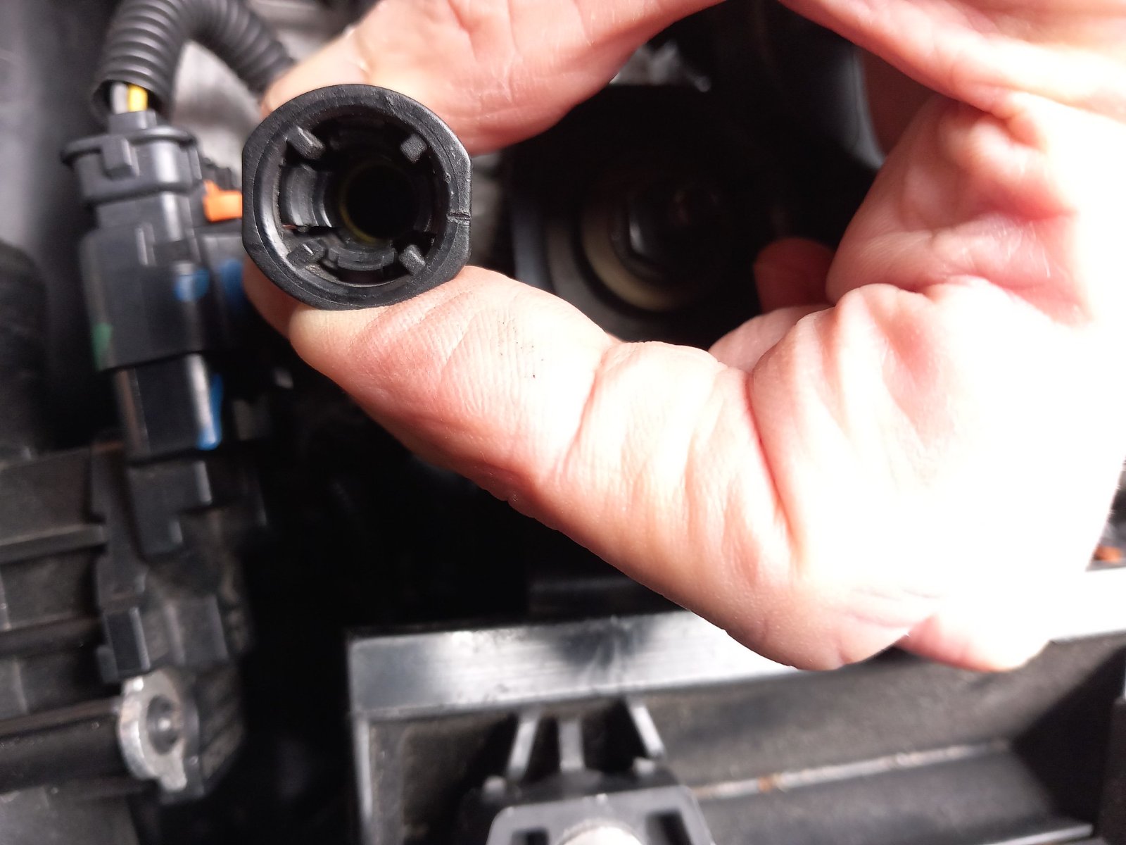

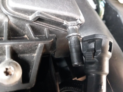

This is what the end of the airbox spigot looks like:
And this is the collet within the connector:
The technique is to initially push the connector towards the airbox. Then, whilst holding the connector as far forward as you can, pull the collet assembly back as far as it will go by its ears, squeeze the two ears together really hard and keeping them squeezed as hard as you can, pull forward and the connector will release and come off the spigot... It may take two or three attempts. It's made difficult because the collet is loose inside the connector and that's why it's needs to be pulled back whist squeezing its ears... If you don't, the ring on the spigot prevents the collect jaws expanding enough to pass over them...
Whoever designed that was a genius/idiot/psychopath/joker/sadist*
100% more complex than it needed to be...
* Select your favoured choice...

Wow, take the fiddly fuel pipe connector and make it thoroughly worse!
Wondering if I could swap in a fuel pipe connector in its place, or is it the pipe spigot that is normally broken in this connection?

Agreed Matt!MattBLancs wrote: 23 May 2024, 12:42 Wow, take the fiddly fuel pipe connector and make it thoroughly worse!
I'd say the spigot is likely to be most at risk of breakage from harsh attempts to separate it, closely followed by the poor, hapless mechanic's state of mind...
There are times when you can try and try multiple times and then for no good reason it then just decides to release with ease. It's frustrating!
