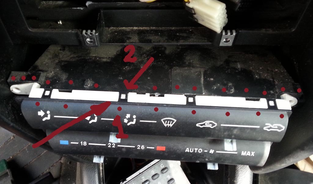

The black top panel, there should be space to slide a trim remover (little notch in the white) then dont remove it completely just hinge it up.
Stu

The black facia 1 ? or the rear black [box] 2

2. The front should lift up, if you look at the leading edge where it meets the white top part you can get a knife/screwdriver in and lift it up, not the tangs that clip the front to the white
sorry if im confusing you!

Ok.....I get it now.

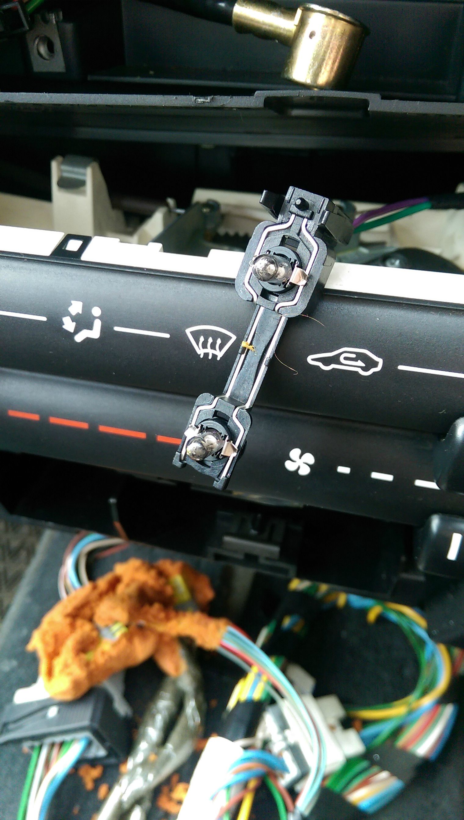

Found a picture from mine too

The black cover you see above the top slider Alasdair, it just clips on...
I'll be down your way on Saturday so can do it then if you like!

The black cover on the top has some deep release tabs on the sides and reveals all the controls .... in certain position the bulb holder can be wiggled out ... good luck [Is that .... DUST !!!]
[How slow is my typing - none of those replies were there just now

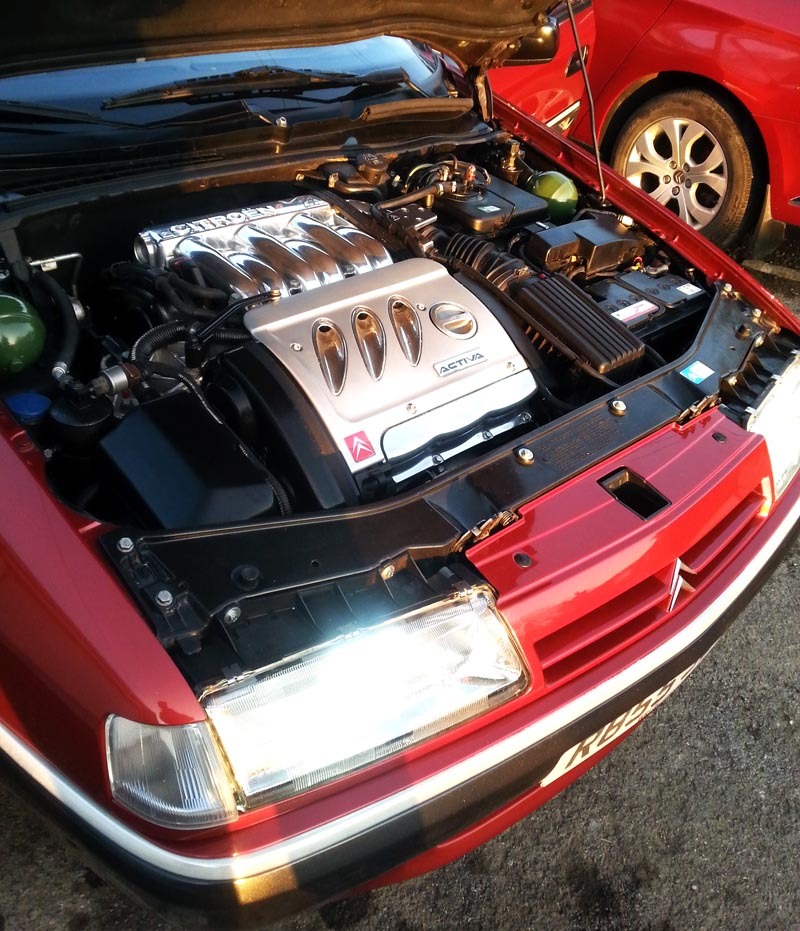

Cleaned up after the mess I made fitting the DRL's....nasty finger prints all over the place ....yuk
But I now have Green Balls !

Nice looking engine bay Alasdair

Damn why do you post these pictures! I will be ashamed to post pics of my engine bay
