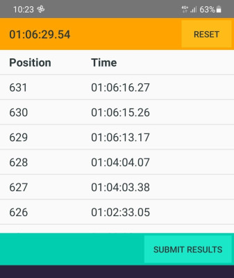

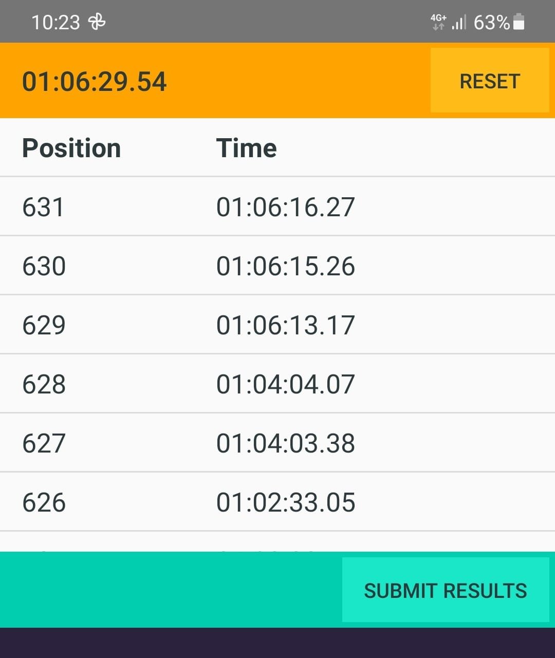

A very special day today... As many of you will be aware, I love parkrun and particularly, volunteering with timekeeping being my favourite role and one I've made into my speciality. I've now done it 95 times.
For a while I've been wanting to give my timekeeping skills a stern test at a big, premier parkrun. Today I did just that at Milton Keynes.
In the bitter cold I timed 631 parkrunners across the line with 100% accuracy :-D That's over twice as many as I've ever done in the past... At times the adrenaline really flowed...
To prove, here's a screenshot of my stopwatch app. at the end...

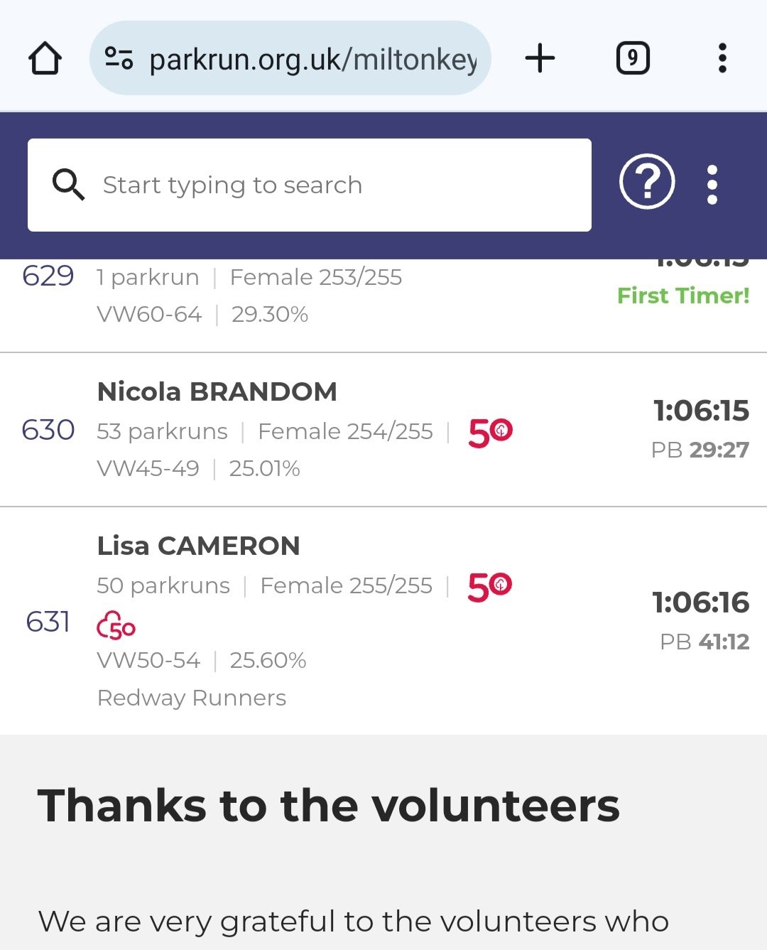

And here's the tail of the published results... They match!

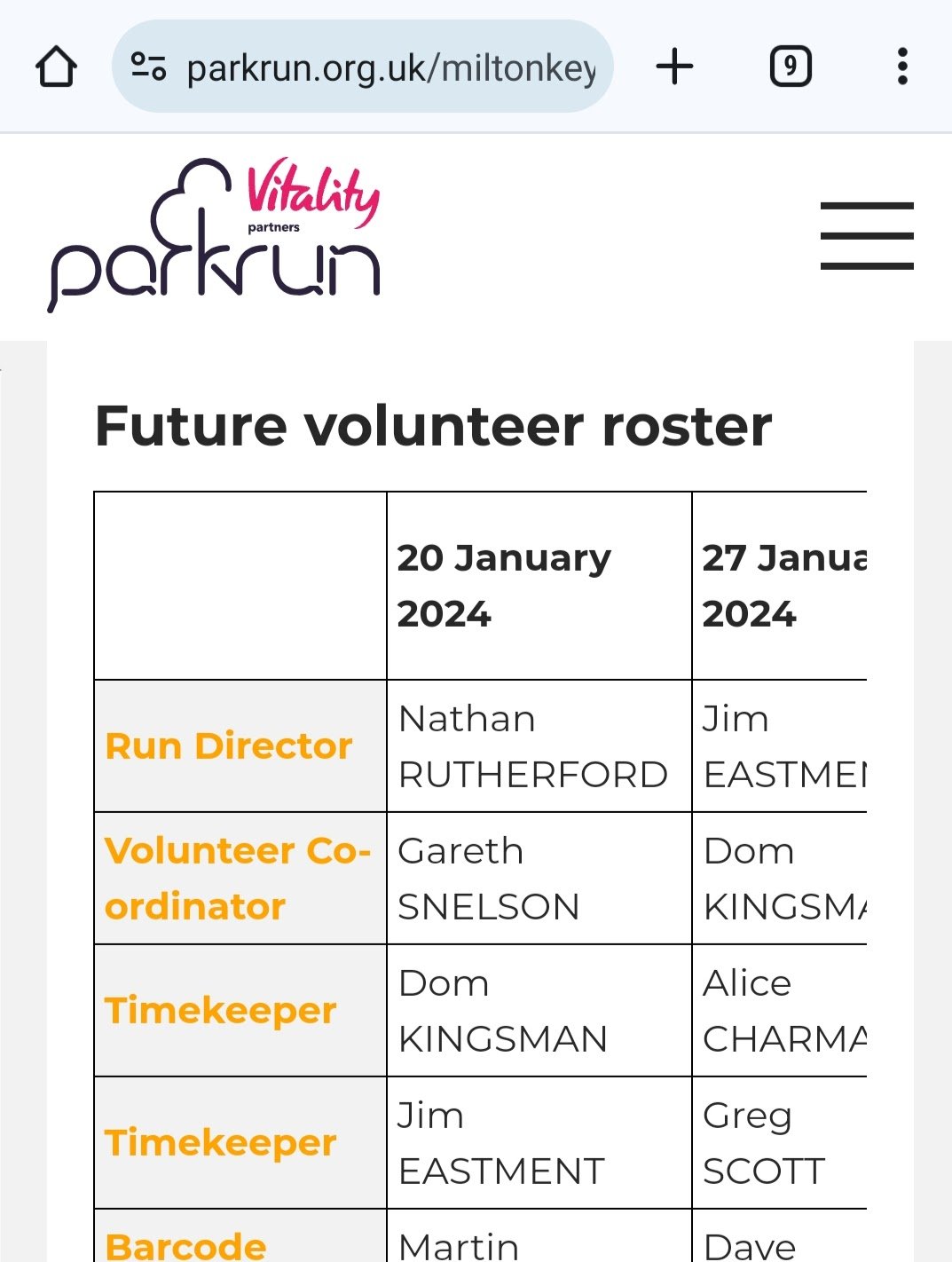

Next week, I do an even bigger job at this big premier parkrun... THE top job!
True bucket-list stuff :cool:
