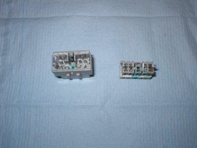

Before that there was the small matter of replacing one of the corroded loom interconnects. This was the state of it:
Pins had corroded away and wires had come adrift!

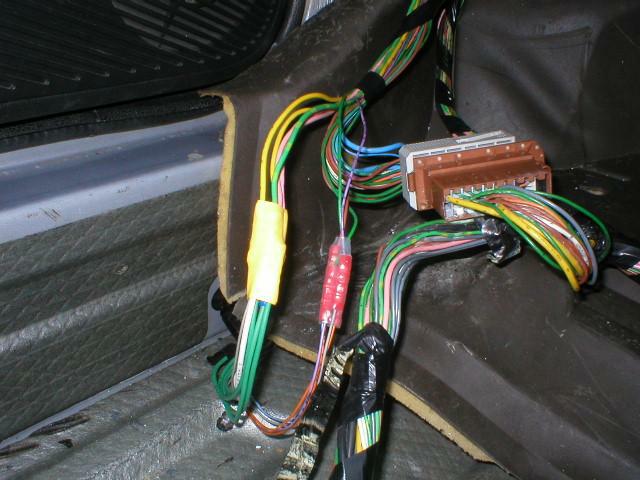

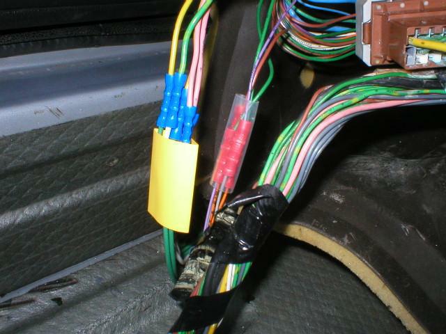

I used crimp butts to join the wires...
With an overall heatshrink for a bit of additional protection..

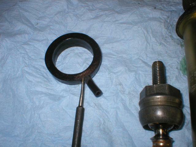

Most rams leak not because the hydraulics have failed in them but because the leakage return pipe spigot or the leakage return collar seal fails. I'd tried a fix using heatshrink sleeving but that proved not quite successful. It still wept LHM a tad but worse, the gaiter would not stay properly put and as will be revealed later, a good gaiter is critical on a ram.
On the front, it's easy enough to take off the top balljoint after making up a special thin spanner to engage on the flats at the top of the piston rod. The gaiter can then slip off. Then the outer metal cover can be removed by twisting it using a pair of pipe grips. Following that, the leakage return collar can be removed.
The leakage return catches leakage from the top of the ram and this runs down inside the outer metal cover and then out through the spigot.
In dismantling, I found conclusively why they leak at the collar. Corrosion eats at the machined surface at the bottom of the ram as the following two pictures show:
This shows corrosion on the collar itself and this one shows pitted corrosion on the machined surface of the ram body which the collar seals against. Once again, I think we can blame road salt for this; I don't now think it is caused by infrequent use of the car.
This is a rear ram but the front suffers precisely the same way.

- Posts: 55111
- x 8406
Thanks Will,KP wrote:Jim,
Dont replace the pipe.
Take it off and go to pirtek.
I shall do just that, if it starts leaking again. I'm sure my sliver Activa is possessed. Since seeing that pipe weep like a good 'un last weekend, it has not wept a drop since
I've done something a bit, well, experimental. I got a tyre repair kit on the job and put a cycle patch on the nick in the hose and hid the lot behind the heatshrink sleeve. I don't know how long it'll hold but it might just be good enough to secure an MOT pass. I'm not willing to spend anything on this car if I can avoid it. So far I've spent the princely sum of £26 on it... Everything else has come from "stock".
I can't afford it this month anyway. Siany turns 15 tomorrow with concomitant drain on dad's pocket , my red Activa is due tax this month and my V6 due both MOT and tax early next month...
I'm still needing to get the Activa system properly balanced. It remains a black art to me and one that I'm having trouble with. last evening I decided to adjust it and worked out the way I'd have to turn an adjusting barrel. I did, got it wrong and she's leaning even more now
One day I'll get it right.
On Monday, after washing it on Sunday, I gave my red Activa a good polishing. Actually I also washed the silver Activa and she looks quite presentable now.
Anyway, one nice clean and polished Activa is now resting and the V6 is back in service. Fresh from adjusting ride heights on the silver Activa, I finally got around to adjusting the front ride height on my V6. It's now adjusted to three fingers and rides better as a result!
On a quick test run I could smell oil, fresh oil at that. On reaching home I cracked the bonnet to be greeted by smoke issuing forth from behind the rear bank.
Investigation shows I have a leaky rear bank exhaust cambox and oil thus leaked is dropping on the rear exhaust manifold and burning nicely. It's not too serious just yet but will shortly need attention. I'll do all four camboxes at the same time. The oily smell on first startup of the day has been there a few weeks now so is nothing startlingly new. What is new is that I know what it is now...
Another job on the V6 that will shortly need attention is drop links. I made the old error last year of fitting el-cheapos and guess what? Yep. The links themselves are substantially Ok but their rubber boots have almost completely perished away...
I shall do as the Anglian Windows man used to say. "You only fit them once, so fit the best!"
