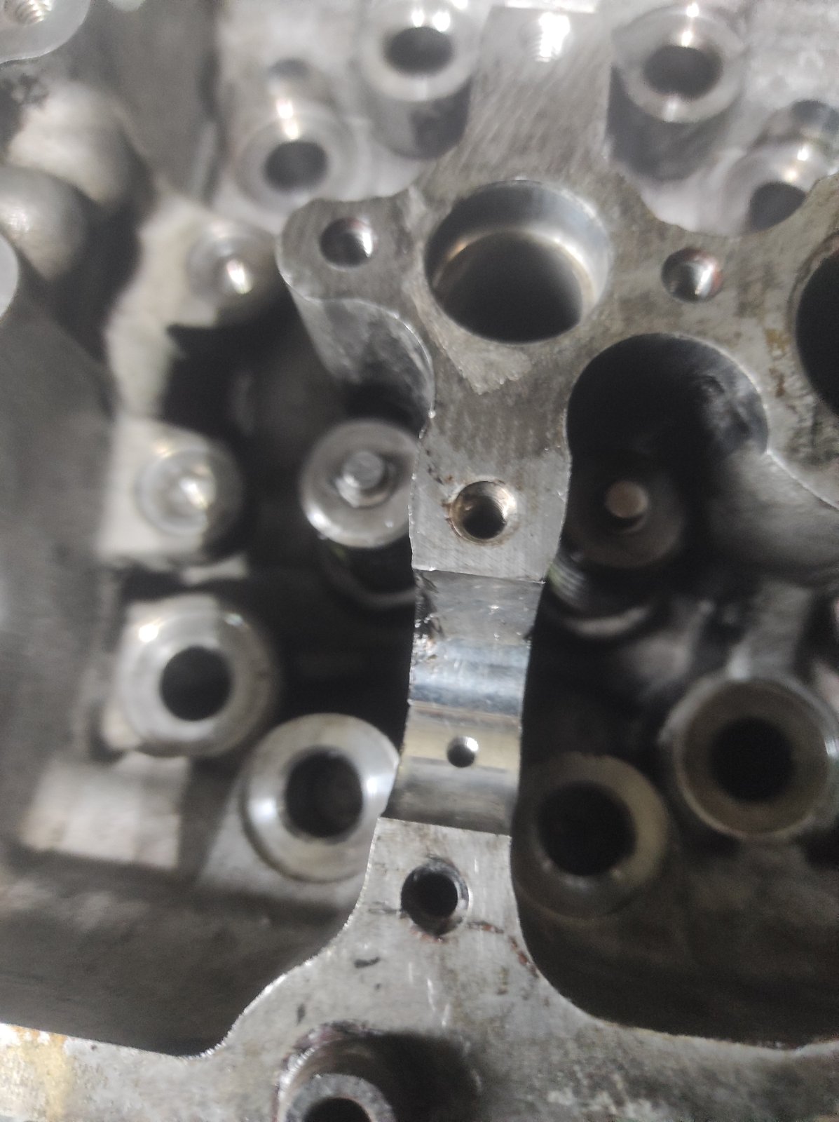

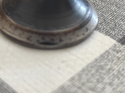

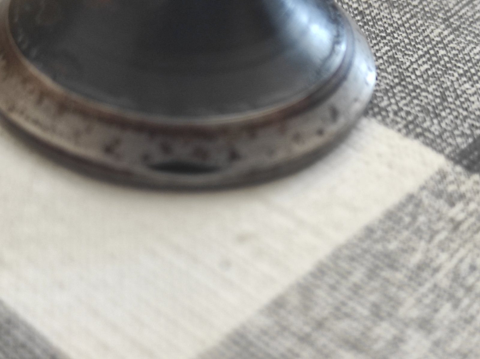

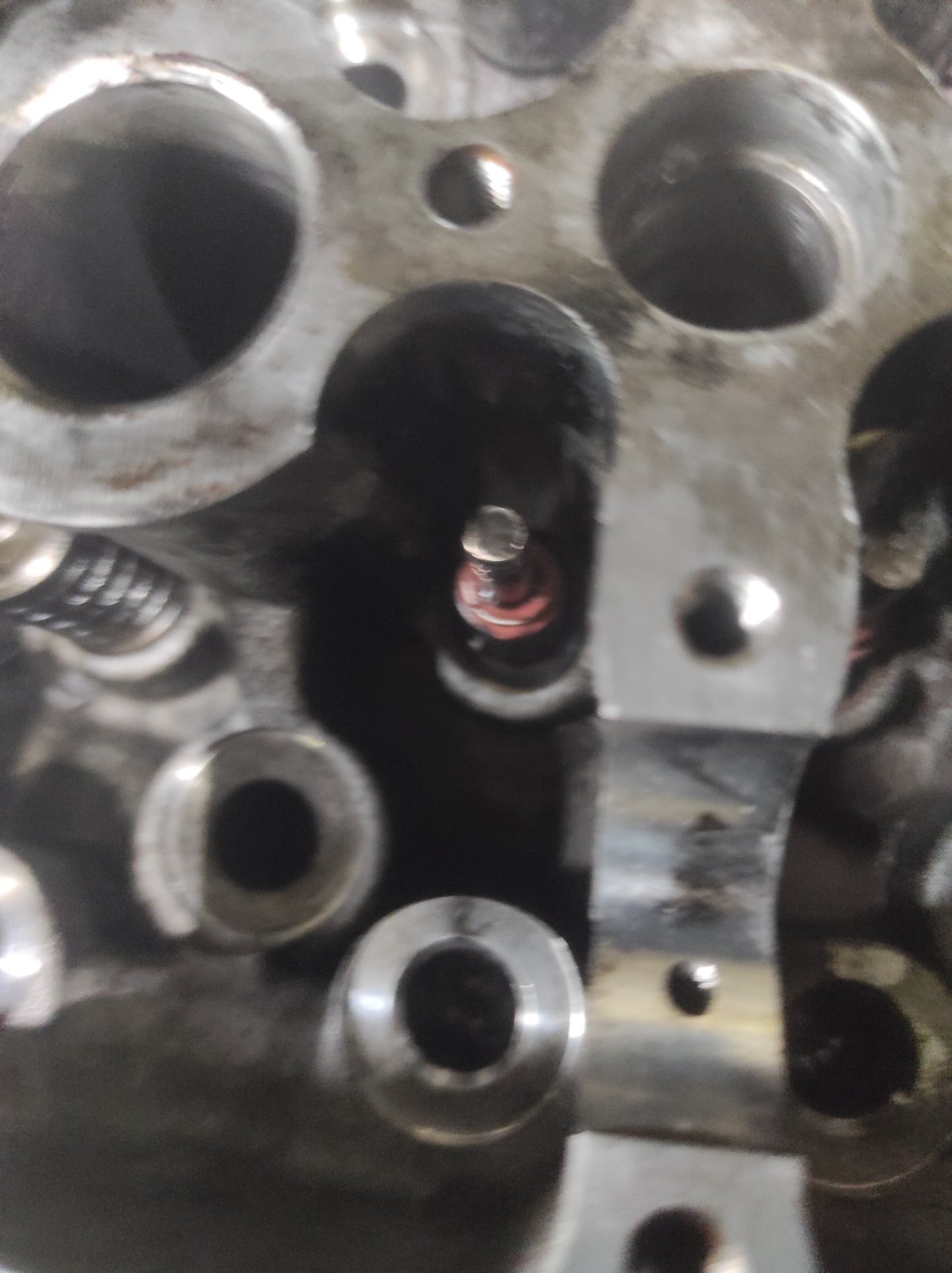

I was just down lapping the valves and is covered this on the cylinder 3 exhaust valves. I think I need to replace it any thoughts.its a small dent in the valve seat face

Hard to tell from the photo, but an engine machine shop might be able to re face it. Or stick a new one in for piece of mind. You are so far into it, be a shame to spoil it now....

That pitting is not good. As Steve says, it might be possible to reface them but better to replace I think.

Yes I have decided to replace both exhaust valves on that cylinder the other one is slightly out of true. There's a bit of wobble on it when rotated. It's the only one that does and given the pitting on the valve in the picture I think it would be prudent for the sake of €30 to replace it. These valves are from the cylinder with the bad injector it seems like something was going on in that cylinder possibly because of the valves/injector. Either way I think I caught it before it became a bigger issue.

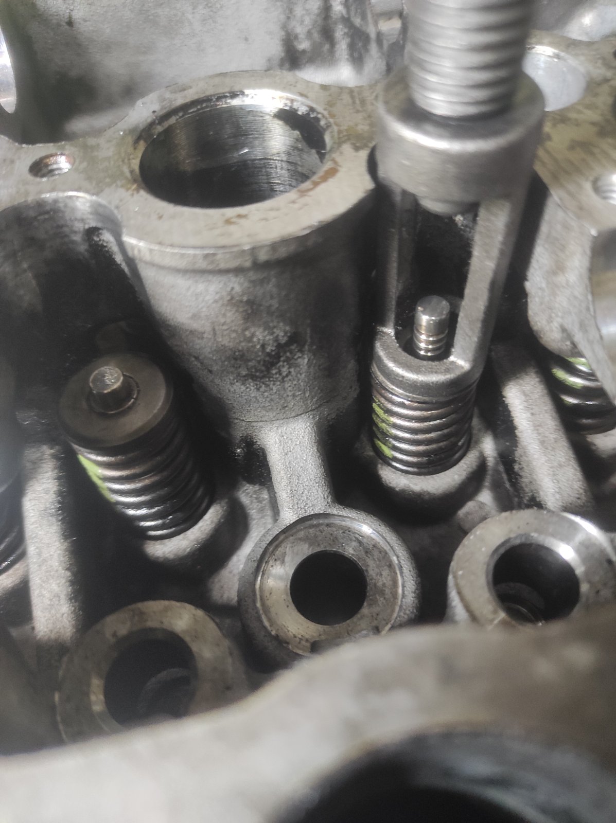

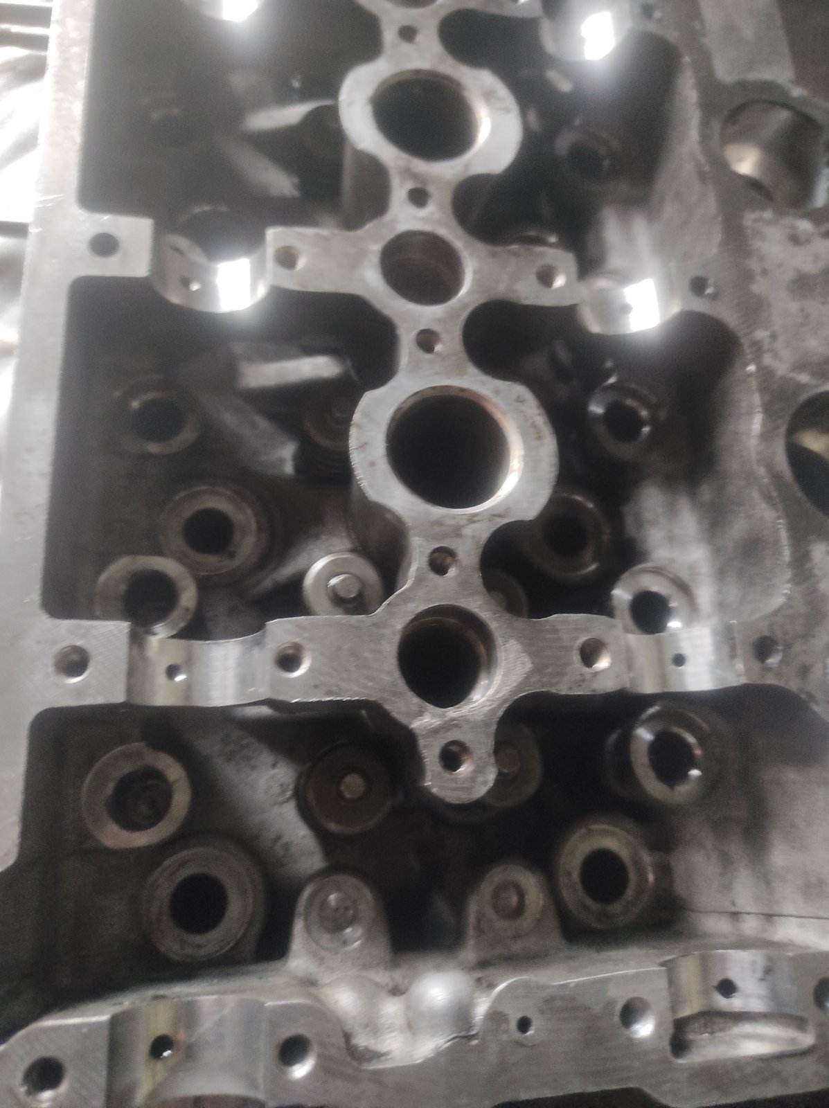

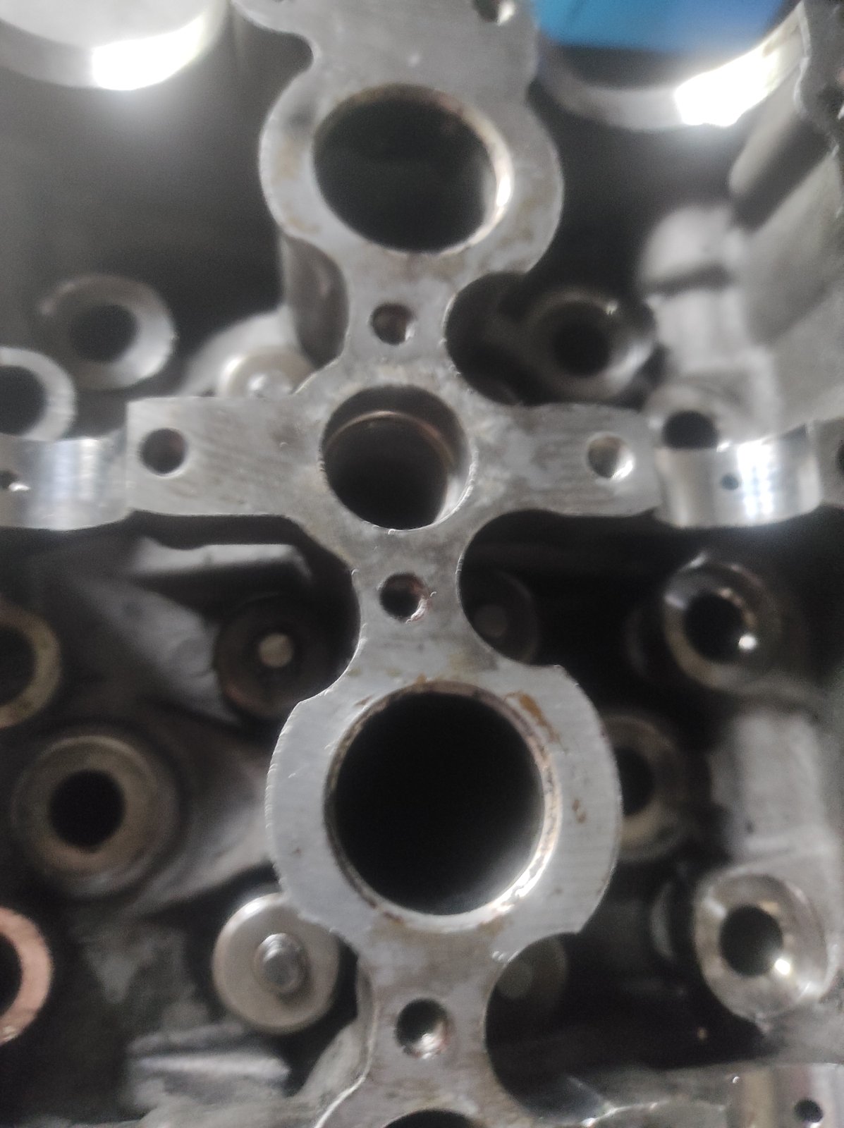

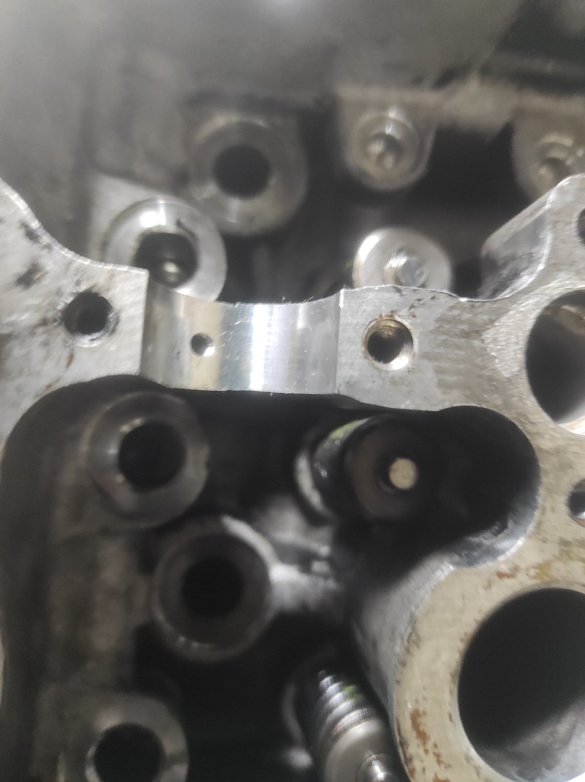

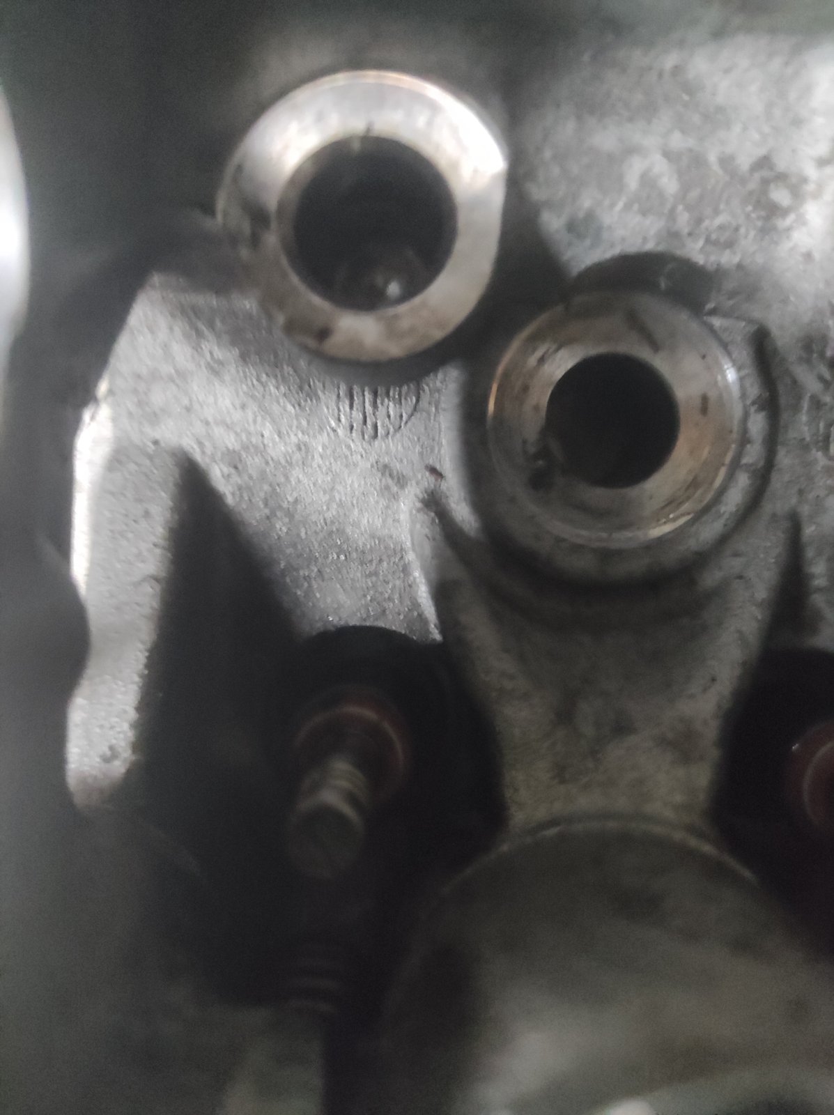

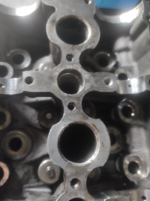

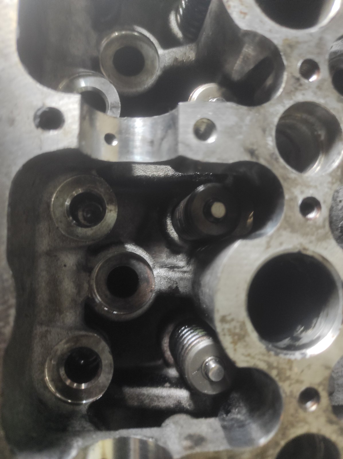

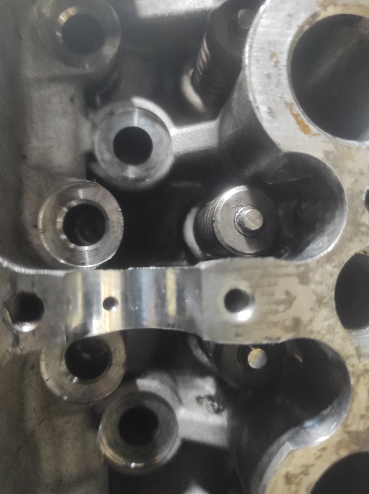

Hi lads a few pics of the head, I am slowly getting through it I have two valves left to do. Waiting on replacement to arrive now to continue rebuild

Keep up the good work Darren. I think what you have found explains the problems you were experiencing earlier plus the additional work on the rack.
Once rebuilt it will run like a dream. A new car!

Hi Kenny, I agree I think so too I am going to pull the sump when I have it put back together and give it a clean aswell I think overall it will be a great car when I am finished

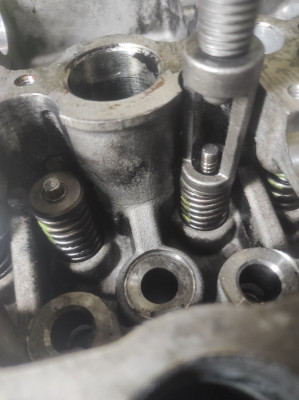

I have just put the last two valves into the head now, just need to do lifters and rockers.the hardest part is the colletts but with patience a magnetic screwdriver and a tub of vaseline and a windy valve spring compressor it's not too bad. I am hoping she will run well now when I put her back together.

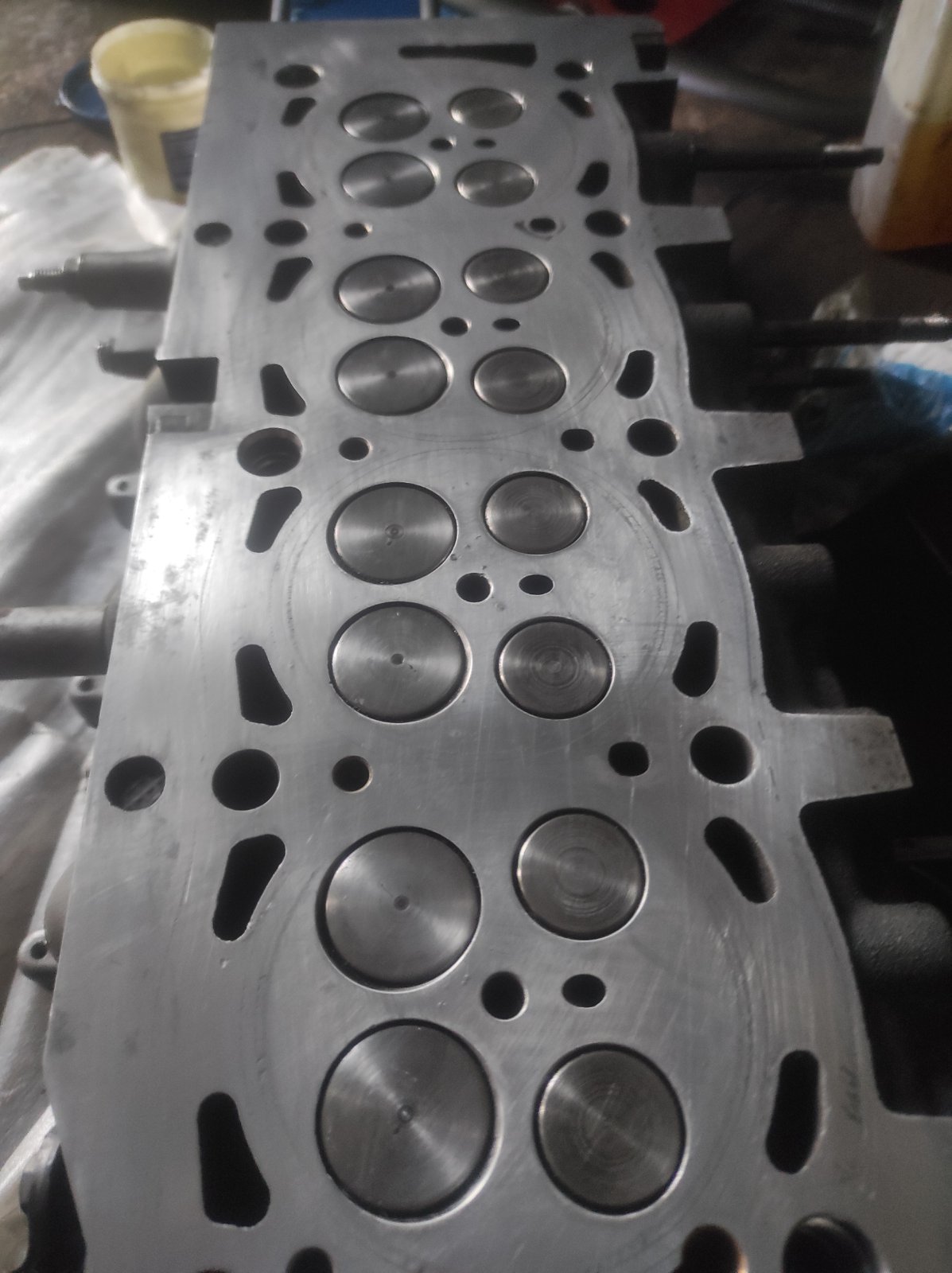

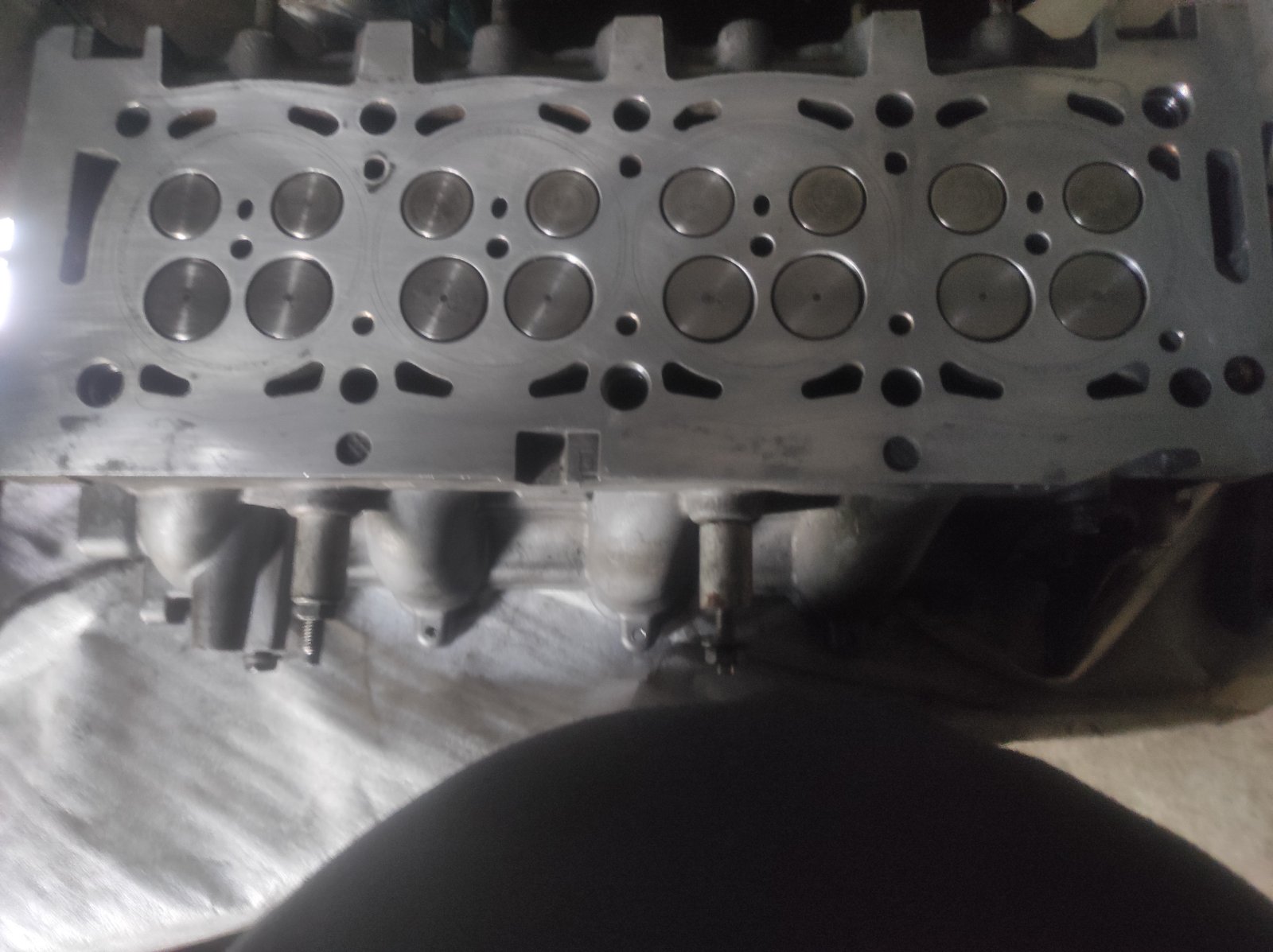

Has the head been skimmed? It's a cracking clean up job you've done if not!
Know what you mean about the valve collets, on my DV6 job I used grease rather than vaseline and also stuck it to the screwdriver with grease (instead of magnetic) as well as a splodge on the valve stem ridges. But it seems an endless job! Cylinder head on a nice high table, and a stool or chair to sit on and just "potter" through it.

Hi Matt, no it's just a plastic scraper scotch pad and 1500 grit. Just being my OCD self😂😂. Took nearly a week of evenings, just taking time to finish it off but I am happy it won't leak. No gaps under the straight edge. I have a V6 Maxima lurking on the driveway that might need this aswell.
