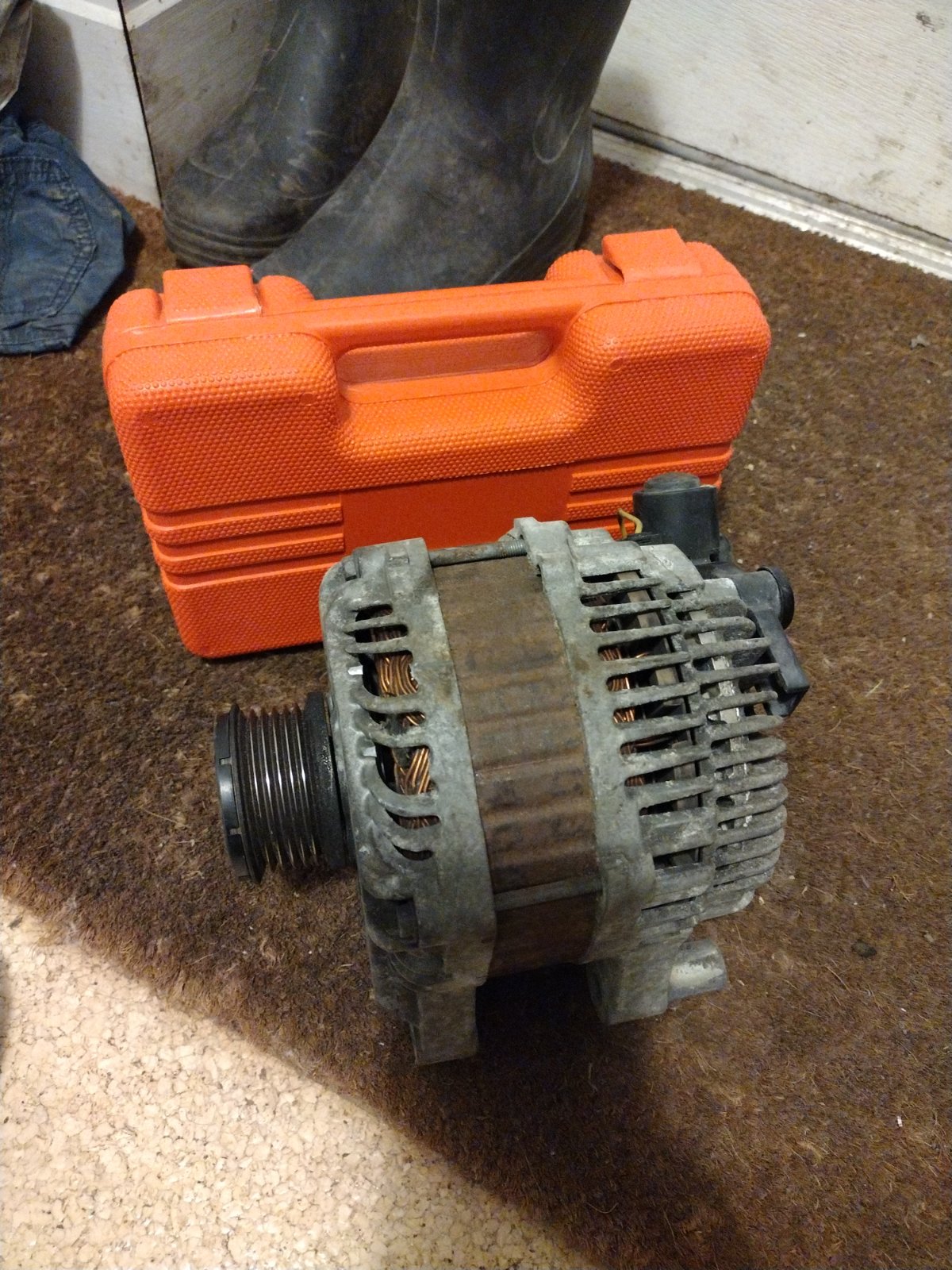

Certainly looks like it's taken a knock on that lug Matt... Hope it's not rendered it unusable but do check in that area for cracks before putting it into service...

Had a good look and rest of the casing looks fine. I'm hopeful it's survived ok, and a bit of action with a round file will give a hole the mounting bolt can pass through once more.CitroJim wrote: 12 Apr 2023, 06:21 Certainly looks like it's taken a knock on that lug Matt... Hope it's not rendered it unusable but do check in that area for cracks before putting it into service...

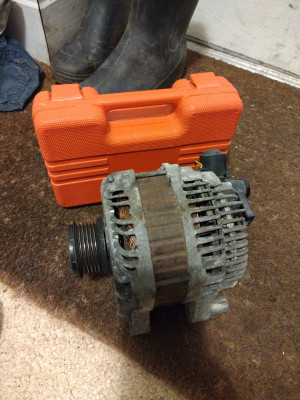

The set of clutch pulley tools arrived today, somewhat dwarfed by the alternator! Both my one year old and my four year old sons were quite taken with the cure little red box that arrived (and indeed with the interesting bits of metal inside that are fun to clank together!)
Confirms that a 180 amp Mitsubishi manufactured alternator does have the 33 spline fitting on its clutch pulley. Will see if tool allows me to shock the pulley loose given the odd smooth hole in the alternator shaft.

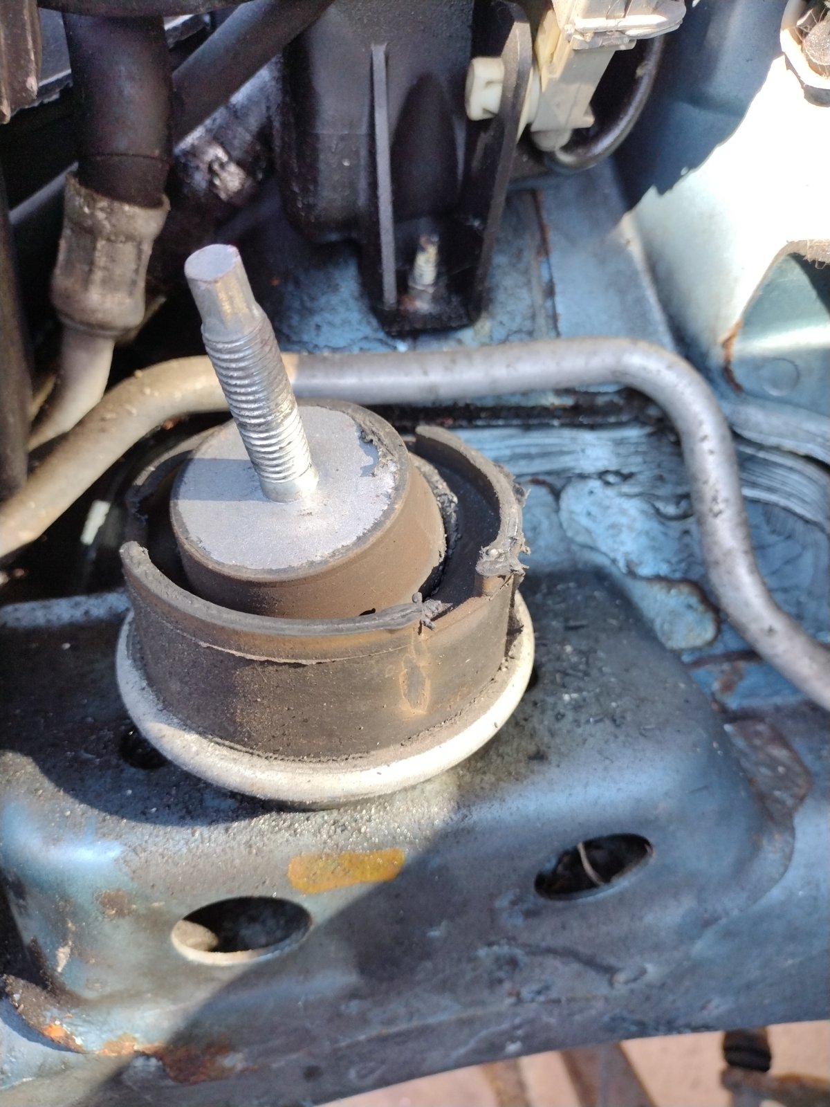

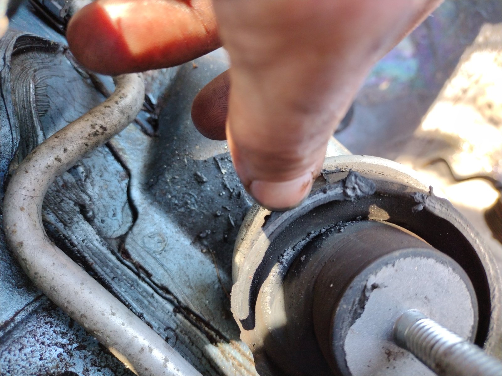

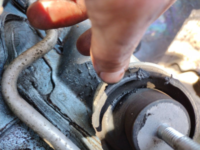

Ahhh, found why it had become so loud in the cabin! Not very old engine mount, completely collapsed!! Metal to metal on the edge where my thumb is.

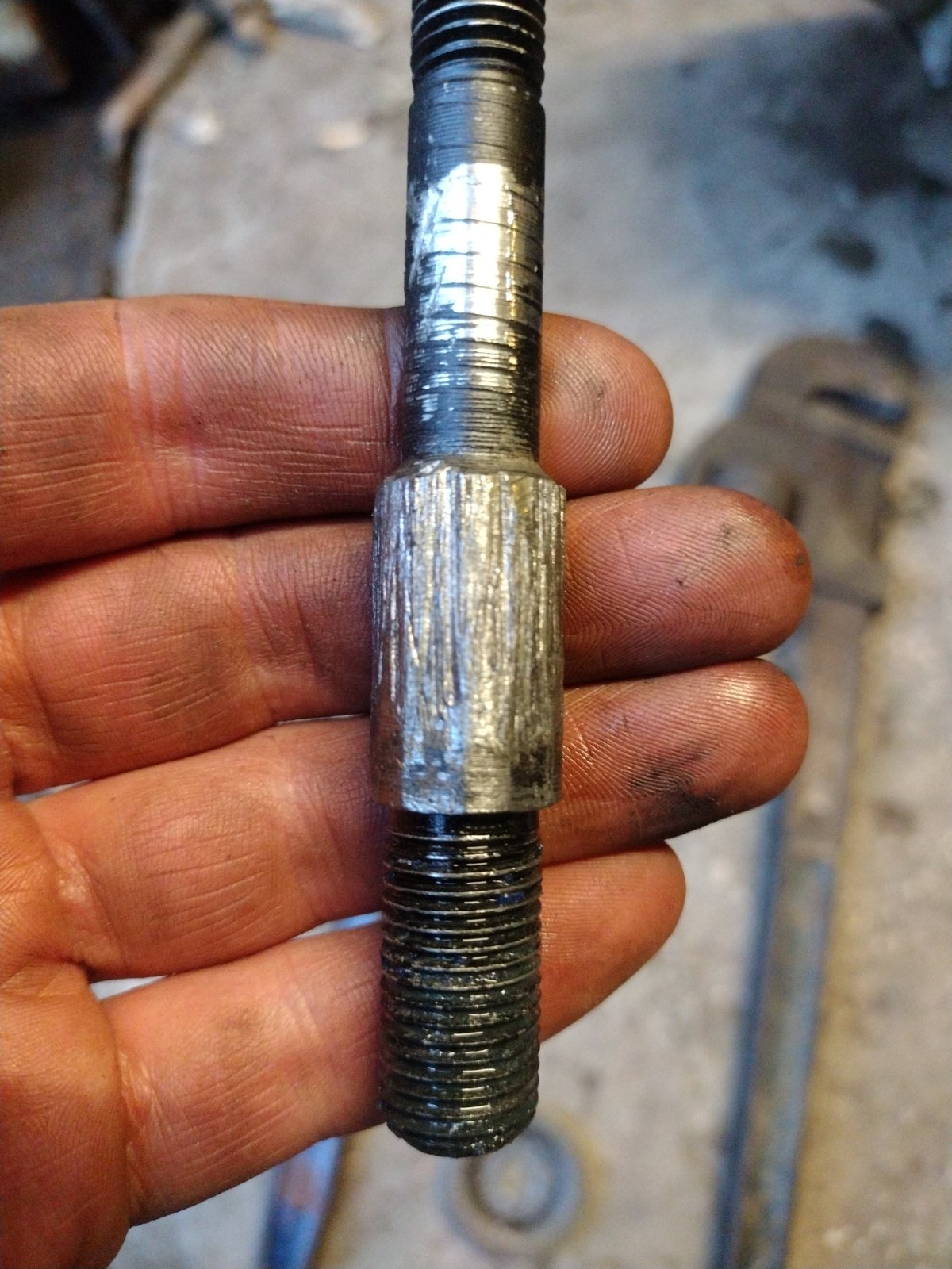

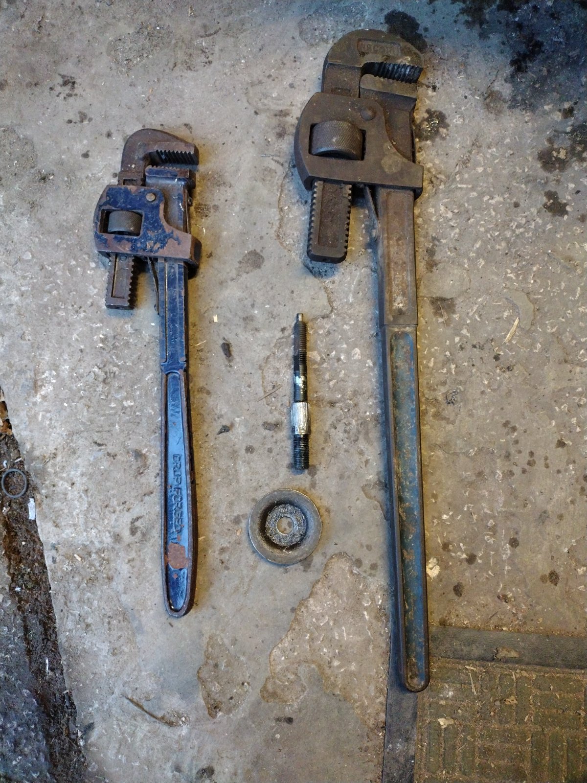

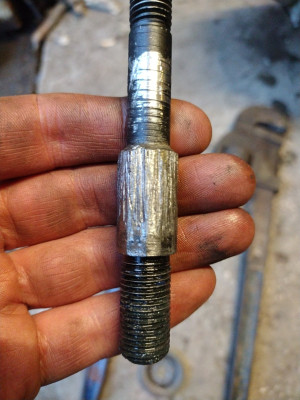

Easily the most reluctant gearbox mounting stud I've come across!
No chance on the car, big Stilsons to the rescue!

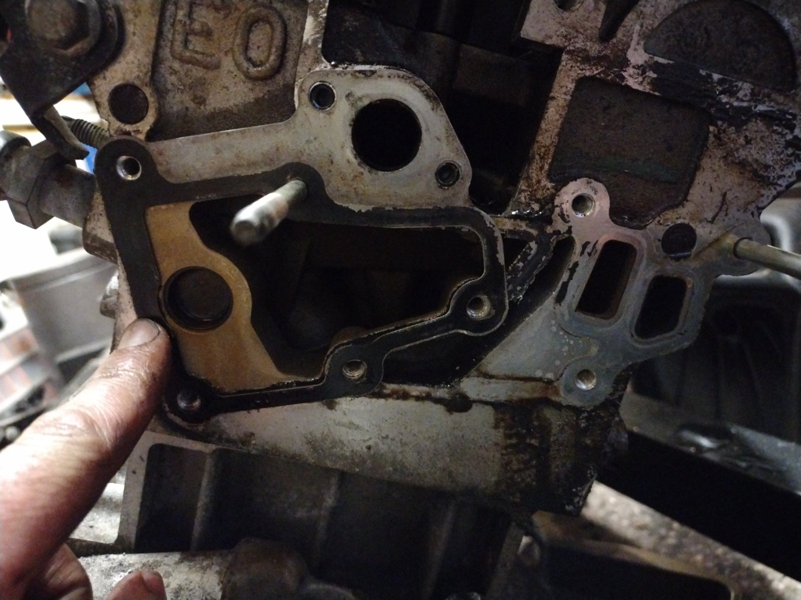

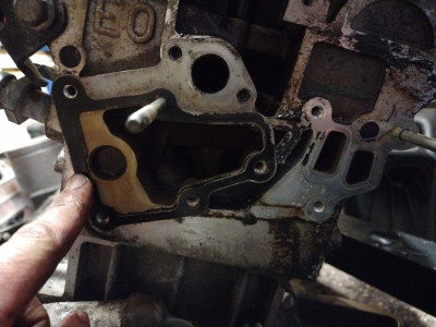

EW10A gasket for coolant manifold versus EW10J4 cylinder head.
2 square ports to the right EGR connection to exhaust port on right connection to the head to left. No EGR on EW10A
Top round port is secondary air injection inlet also fed to exhaust port. This does seem to be present on both EW10A and EW10J4.
Mounting positions all align put differing combination and positions of studs and bolts.

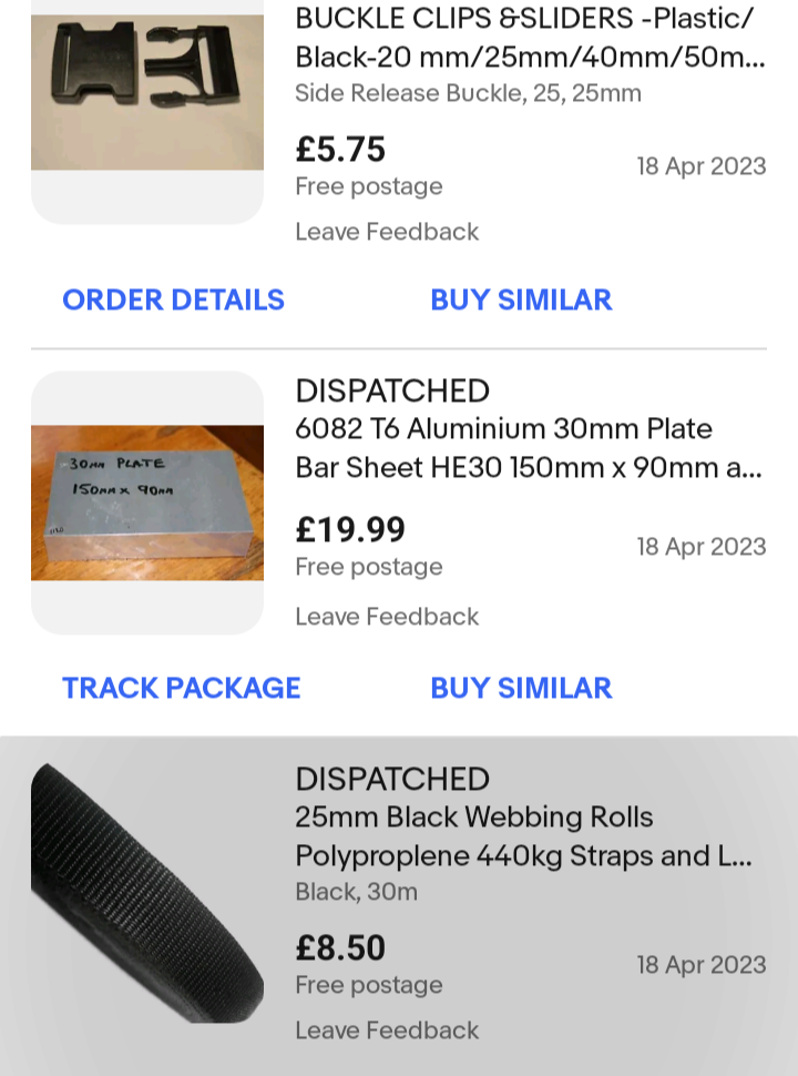

Follow confirmation from Marc that I should have something holding the X7 spare wheel in place:
viewtopic.php?p=751695#p751695
I've ordered some webbing and some buckles: I've done my usual "it's cheaper for more and will come in useful" so 30m of webbing and 25 buckles. Need about 1 - 1.5m and 1x respectively!

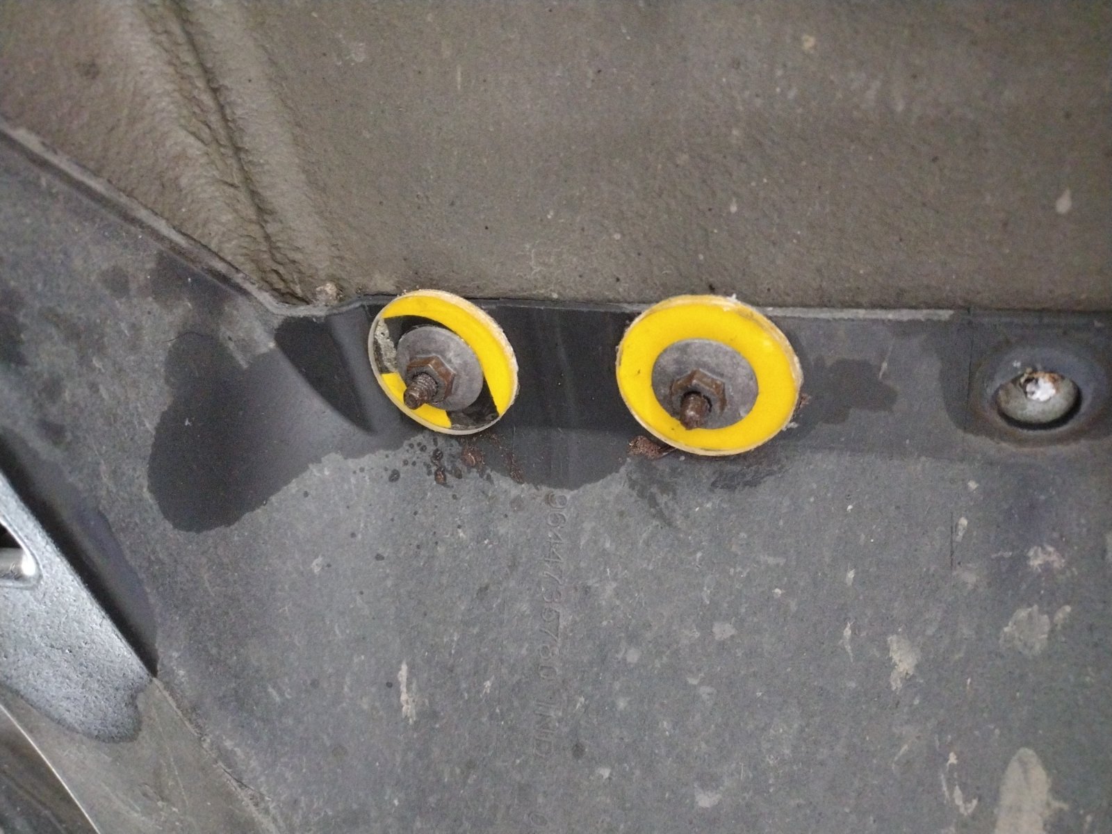

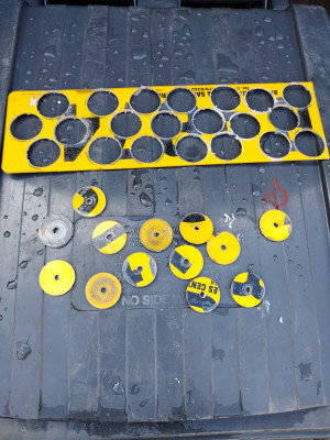

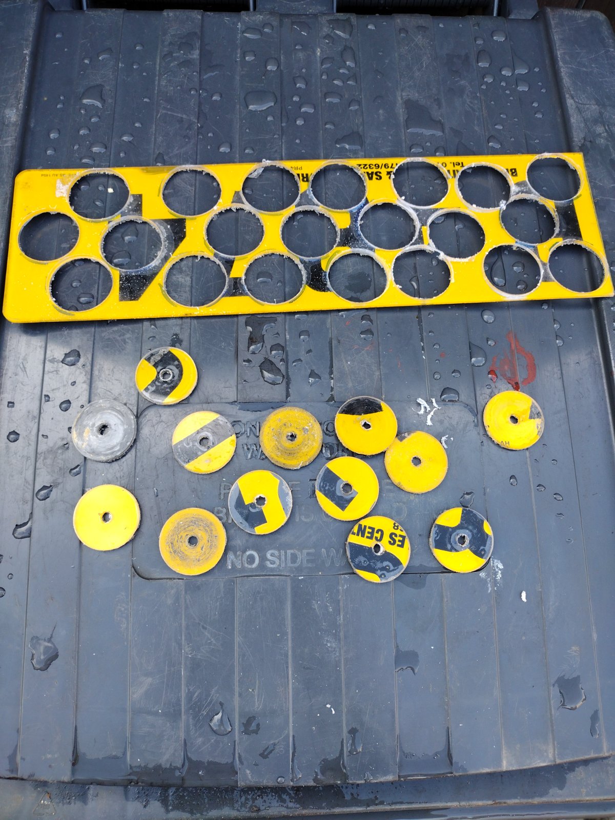

Hello, I'd like some low strength but non-rusting penny washers and I don't care what they look like, can you help?
Yep
Yep
- Spoiler: show
- Posts: 21082
- x 8091
A handy bunch of washers there Matt but what are you going to put on the back of the trailer now?

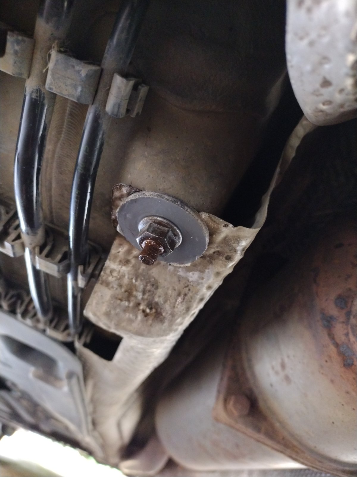

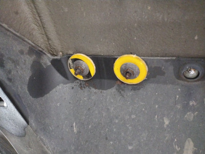

Here they are, installed in "worried the MOT man might laugh at me" orientation
Heat shield fretting holes in itself

In contrast these are in "I don't care what you think" / function over form orientation!

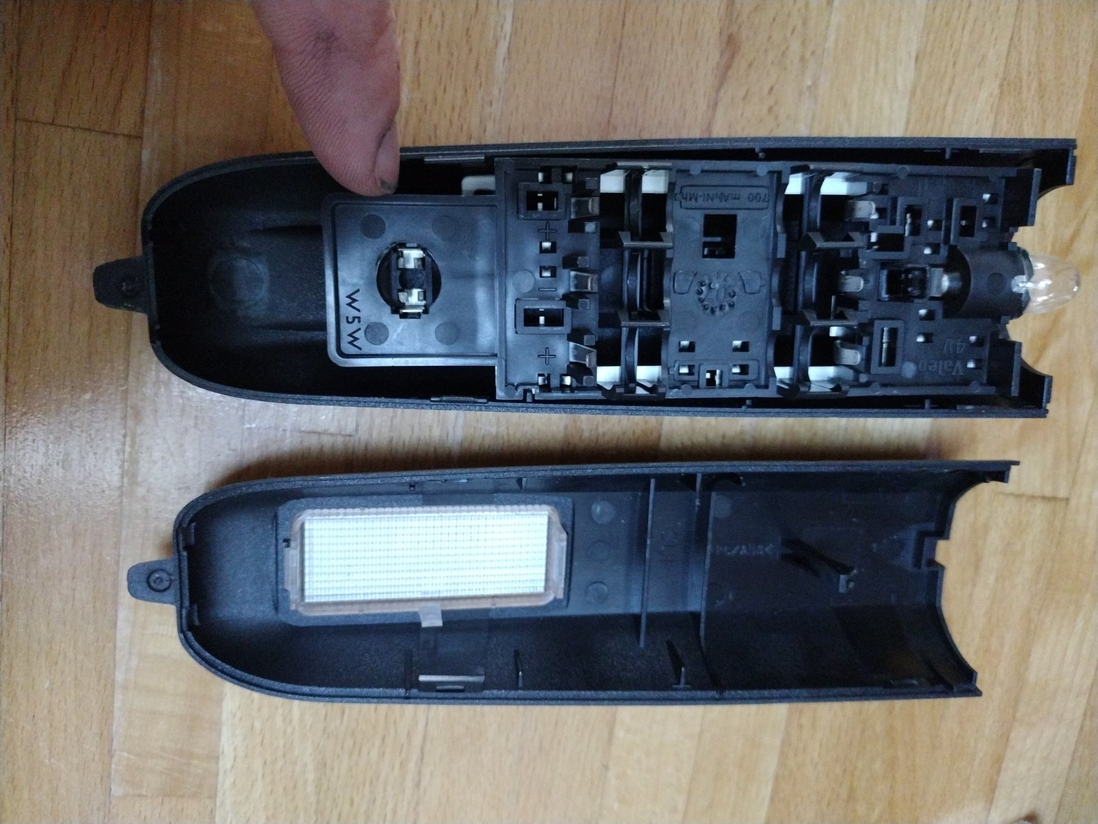

On with the boot torch modifications, this is my guide:
http://c4owners.org/plugins/forum/forum ... php?204390

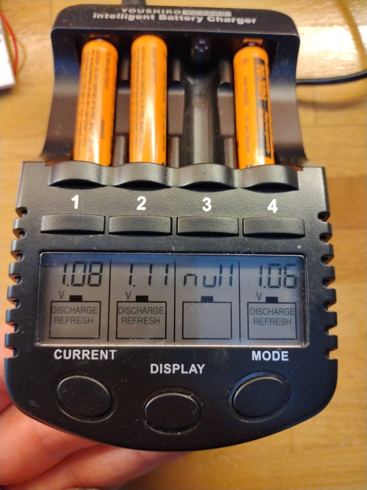

Boot light on the side is W5W / T10 type. Piddling output further hindered by glorious mat black "reflector" Batteries are Ni-mh, Panasonic, stated "minimum 700mAh" AAA x3. Currently undergoing a bit of "discharge refresh" treatment in my fairly fancy charger. Were all reading 1.35 volts when first put in, charger is discharging at 250 mA and dropping quite quickly in the short time it has taken me to type this: Have an eBay LED for the torch end and an LED panel for the W5W
