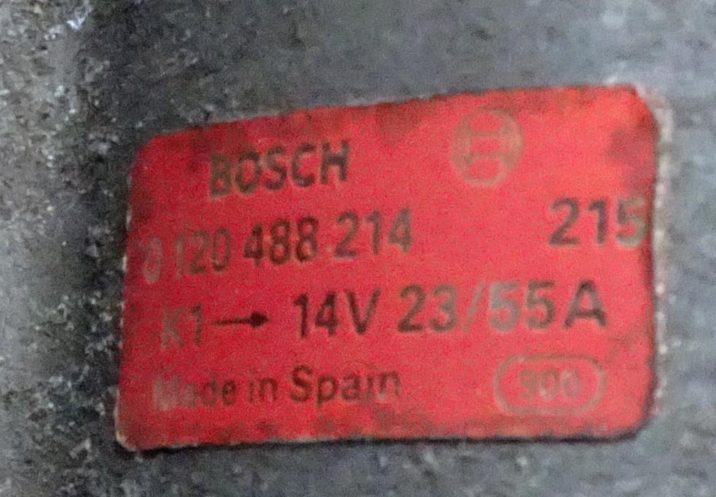

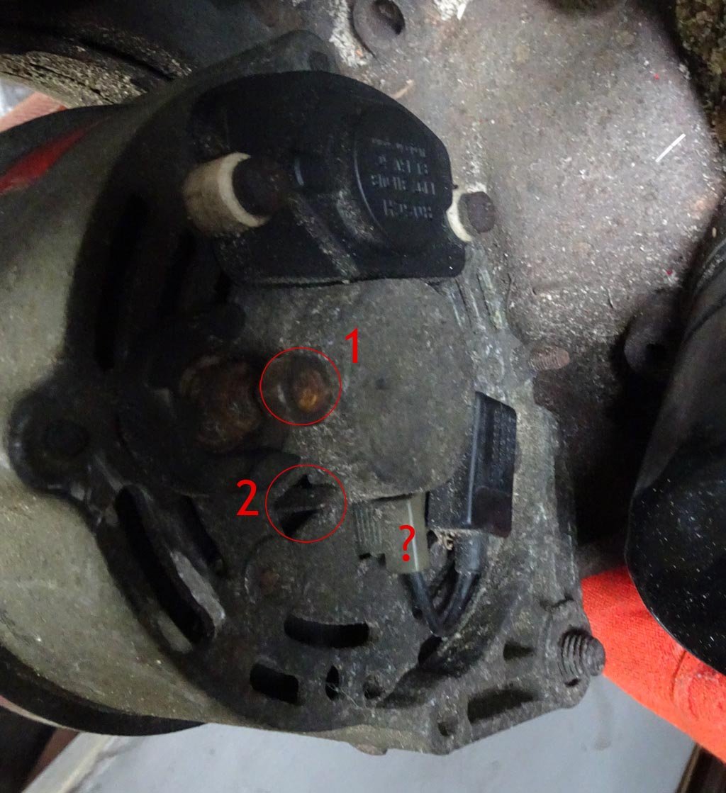

My alternator appears to have just two connections, 1, the charge and 2, wire to the battery light. There is that other thing that connects back into the unit again, I don't know what that is. I did a search for how to drive a tachometer from an alternator and found this video:-sparksie wrote: 21 Jul 2019, 21:16 This is my day-to-day job and I wouldn't advise using the inductive pickup for the tacho.
Much more reliable and, therefore, more commonly used in the hostile marine environment, is the alternator driven tacho.
Many alternators have a "W" terminal as standard, but if yours hasn't, it's a simple thing to add one.

I decided to have a go at adding a W output to my alternator, following the instructions in that VW link I posted above, how hard can it be?
Had a hell of a job getting the thing apart. One of the 4 long screws absolutely would not be moved, the other 3 were relatively easy.
Knackered the head trying, so that was going nowhere, but this one unlike the others proruded out the other side and had a nut on it for some reason (yes, I removed the nut). So I had to try moving it from that end.
Mole grips, no. A nut against another nut, just shredded the thread off the nut. Nut with thread-lock, no. Nut against a nut with thread-lock, no. Nut welded to the screw, I'm hopeles at welding and failed to do it.
Last resort, cut flush and drill it out, so the replacement will need the nut. But drilling a steel screw in an aluminium case is near impossible, without means to hold it exactly in place. This was Saturday, when nothing was going my way.
Then progress Sunday, last, last resort, take a hacksaw to the exposed mid section, that got it apart, still leaving the threadded end in the rear casing. That did eventually come out by putting the cut end from the middle in the vice and turning the casing round it. Probably eased by the failed drilling attempt taking away part of the casing next to the thread.
Anyway, after getting it apart, I soldered in the new wire to the end of a stator winding and threaded it through the W hole in the back where the terminal was not.
Got it back together, bar the one missing screw that got destroyed, but I found a replacement for that today.

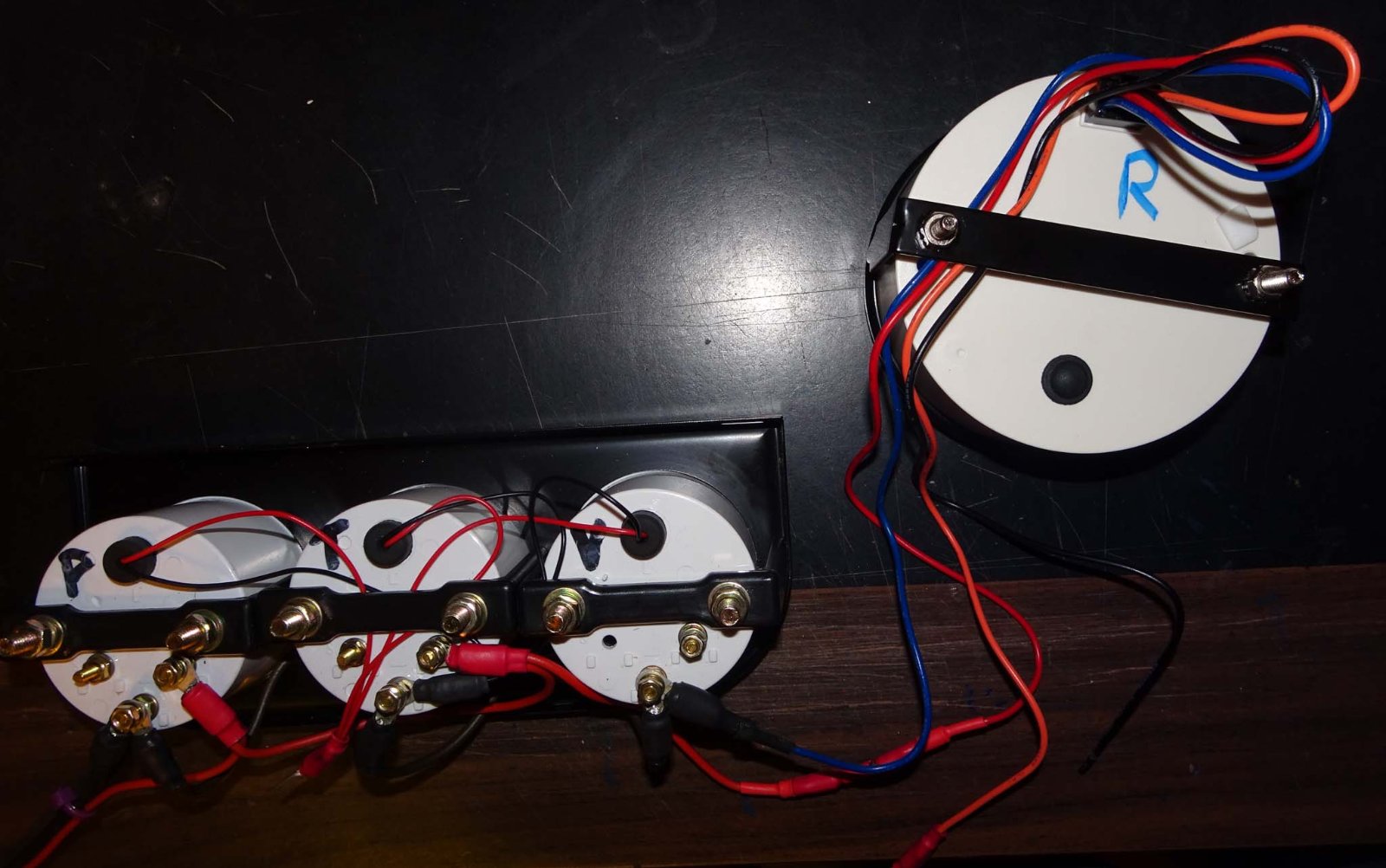

Also made a start at putting a few wires on the gauges, at least the ones I have somewhere to go at this time. These are just power wires so far, linking common sources. Gauge power off the ignition, the lighting on a separate source, probably on a switch with the nav lights (off the Aux batt), a bit like how your car dash lights up when you put your headlights on. The Volt + is not connected as I will probably have a source switch between the engine battery and the aux batt. Sensor wires yet to be connected.
