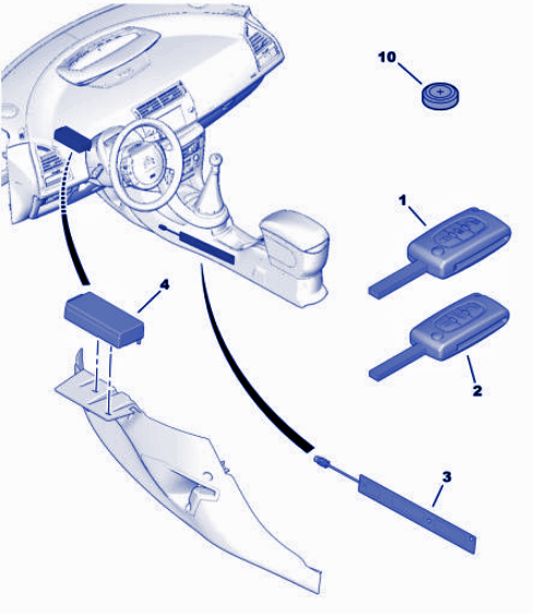

In the diagram below, you can see the Electronic receiver unit (4), and the High Frequency Antenna (3). When one of the fob buttons is pressed, it sends out the high frequency encrypted code, which is picked up by the Aerial (3) and transmitted to the electronic receiver which then talks to the BSI. If the encrypted code is correct, the BSI authorises the doors to be unlocked / locked.
Re-synchronising only resets the offsets when the maximum number are reached (circa 250+) caused by operating the remote at long distances / interference etc. This procedure cannot programme a fob.

The ID46 chip is an identifier - once the BSI has written the code to it - that's it. This code now stored in the ID46 chip is used by the BSI to handshake - but not just the code - it is encrypted and 2 way handshaking takes place.
The use of the remote control functions also necessitates matching with the vehicle.
The coded message sent to the receiver (the box I referred to in the diagram (4)) by each remote control is composed of the following codes:
- A fixed code linked to the key
- A rolling code matched with the vehicle’s receiver
- A code corresponding to the action to be performed (Lock, Unlock, Switch Headlights on, Open Motorised Boot, Close all Windows etc.)
- A code corresponding to the condition of charge of the batteries in the remote fob
