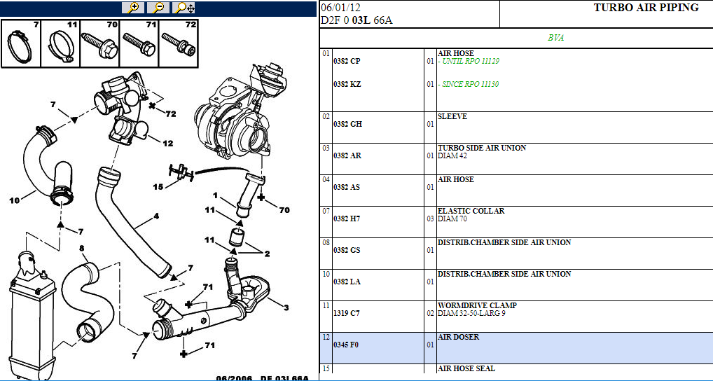

Thanks Elis, just realised my post above is talking cobblers, obviously typing whilst being excited about the possible fix. Yes I agree, but I shall leave it with the repaired pipework and see if it does it again. If it does, I'll stop, that should put the butterflies back to their natural position and clamp them.
Regarding my cobblers.....The top butterfly comes from the top of the IC and is normally open (ignition off) the bottom one (oily beast) disappears into the depths and is normally closed (ignition off). Has anyone got a pictorial view of where all these pipes come from and go to please. (Just to improve my understanding)

This should help:
So your bottom butterfly valve will only open when the intercooler is being bypassed. It is oily as all of the EGR filth from the inlet mnifold will seep downhill towards the lower butterfly valve.

Thank you very much Elis now I can see where the hoses bypass. I have seen how much crap there is in the plenum on the 2.1td, and on your topic, was quite scary. So when it goes into regen it closes the top one to isolate the IC but (hopefully) because of the poor connection to the vacuum solenoid didn't manage to open the bottom one. Makes absolute logical sense. If not, block the pipes and run it like a C5.
Thanks again, I'll let you know how it goes. I'll know within a week
