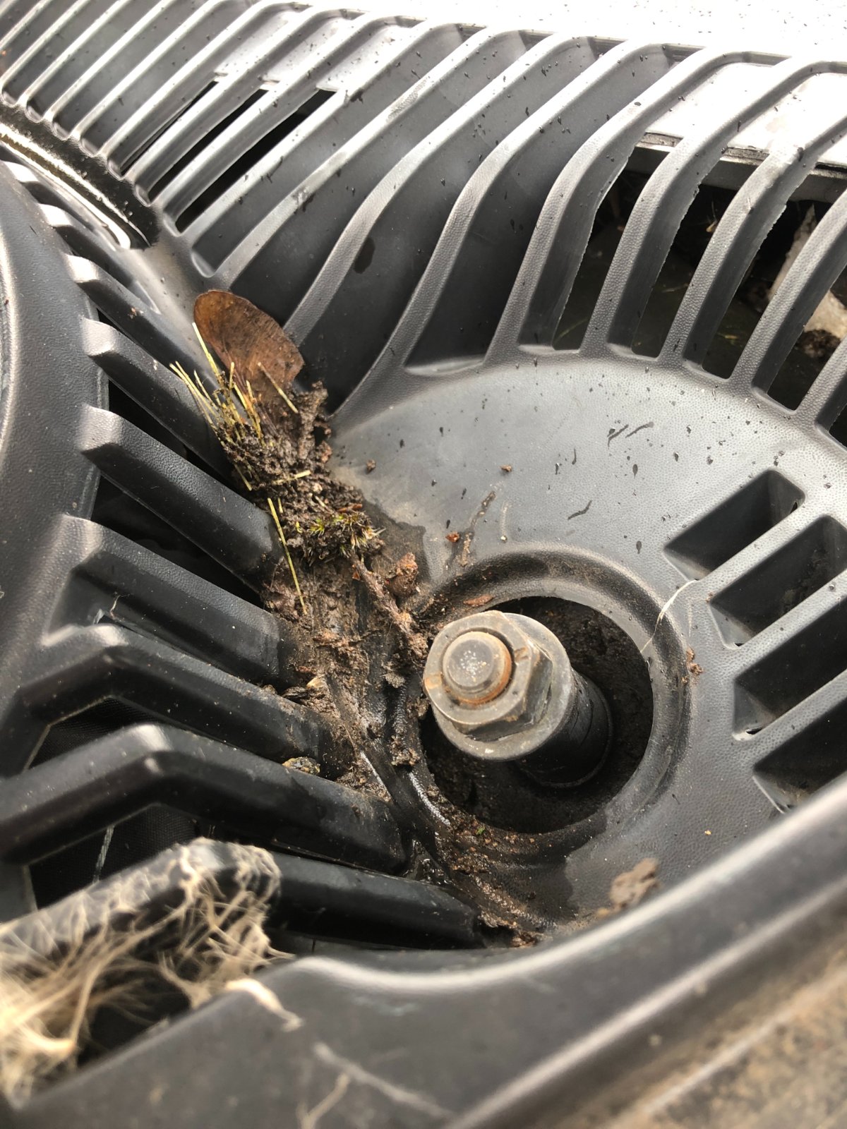

You should send those photo's and your description of your remedy to Valeo and Citroen.
Won't help you but may improve their construction methods and quality management.
Well done with it, seems to be a far too common problem, frustrating and expensive for most to fix.

Thanks for posting that detailed information. It really shows how vulnerable these motors are to the elements.

You're welcome!GiveMeABreak wrote: 22 Feb 2022, 11:30 Thanks for posting that detailed information. It really shows how vulnerable these motors are to the elements.

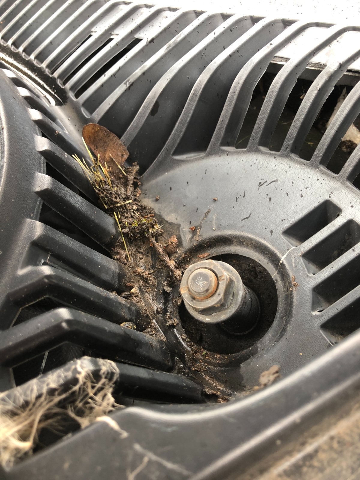

Just had the passenger side wiper begin to twitch and not wipe with each sweep of the driver's wiper and was interested to read of other people'e postings and especiallly the pictures.
In particular the post by ASK_dj 24 Jan 2021 where the magnet on the drive of the passenger side motor is in a different position to the driver's side and moving and glueing got things going again. Mine appears even further down the shaft.
Could I ask if moving the magnet was the real repair or does anyone think that it was the disturbance etc that brought the motor back to correct operation.
Could it be that the magnet interacts with a component on the PCB when in the "moved" position so starting the passenger wiper?
The reason I ask is that mine is tight on the shaft and appears to be as manufactured.
Before further dismantling, any thoughts?
Andy.

OK, bit the bullet and used a pair of long nosed pliers to grip and slide the magnet back down the shaft per ASK_dj's photo. Placed and plugged the electrics into both motors and am really pleased to say they began to operate.
It was stiff to move and actually plastic, so I suppose the magnets are encased in the plastic. Not sure of the cause of the movement but when the passenger side stopped the wipers were going as fast as I have ever seen them go in a very heavy rain storm.
Plastic is dished on the side that you cannot see so I did my best to get some thread lock onto it and the shaft, left it so set before adding some grease to the worm drive and gear wheel before re sealing the case.
Took the plastic covers off both motors and cleaned and re greased all the moving parts. Re installed the motors and put the wiper arms and blades back on and pleased to say still working at all speeds.
So thanks to the forum and ASK_dj.
Andy.

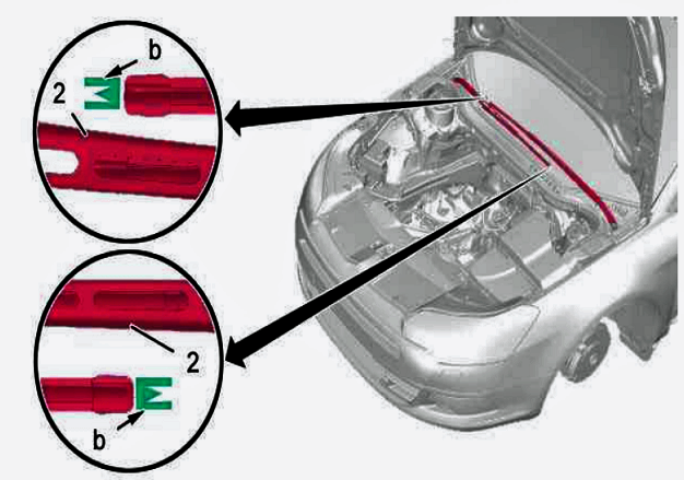

Can someone advise me about the alignment marks for the wipers, on the windscreen please. There are 3 lines of 2 curved markings. These are not the same as the manual shows. A video on YouTube refers to them, but does not show precisely where the blades are supposed to sit.
- x 6955
Re: Citroen C5 X7 Windscreen Wipers
The markers will be something like this:
Align the wiper at the marks shown at 'b'. There will be similar marks for after-market windscreens.
If you're still confused, pop a photo up of the marks in question, using the Full Post Editor option button when replying to the post to upload files.
- Posts: 9268
- x 1930
Presumably there will be different marks for RHD and LHD vehicles printed on the windscreen. Given the position of the topmost wiper blade in the drawing I would say that it is showing a LHD vehicle. Not an unusual situation to be in with RHD cars.
