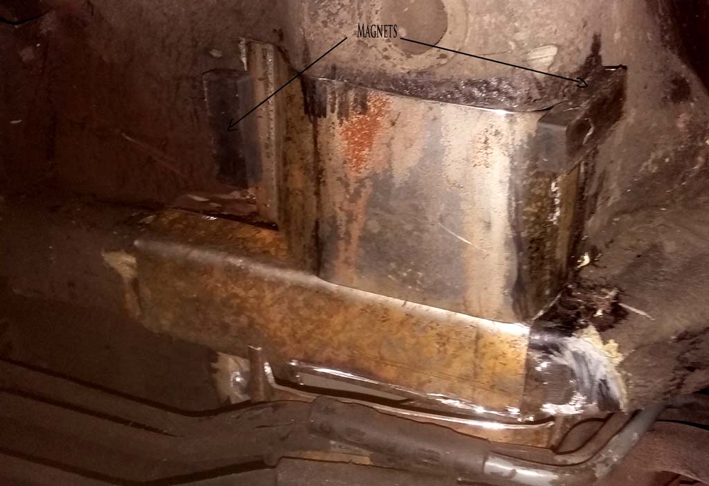

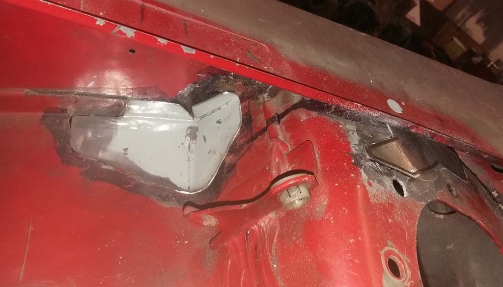

Repair parts formed in sheet steel
Thin Steel for the body work
Hammering the shape for the box section in the thick steel was hard work to get an accurate fit. Now the box section is fitted I will trim the rail U section to be a better fit/look better when welded in.

Re: ZX Volcane Sold - getting fixed up
exactly the same areas as my 'Spares' ZX was rotten in (it probably had rot elsewhere too, but I never bothered to investigate)
That's looking very good Alasdair
Just need to apply a bit of metallic glue now
Naaa, going to use expanding foam and a bit of filler then Shultz the bugger, then flog it to a sucker
Yes, my friend up the hill is lending me his MIG set up, better than struggling with a Stick Welder
Stickyfinger wrote: 20 Jan 2018, 09:18 Yes, my friend up the hill is lending me his MIG set up, better than struggling with a Stick Welder
Definitely a MIG job; a stick welder will jut blow holes in it!
