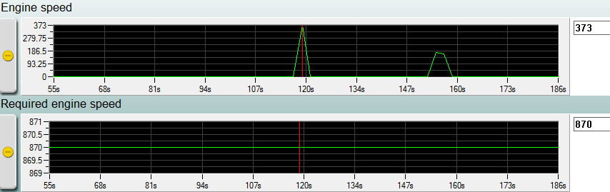

darbuck wrote: 16 Sep 2017, 19:52 thanks Mike on the mend now so not so bad. This car of Max's is a real conundrum. Does the car turn over and try to fire or just constantly crank.
I popped over to max for another diag session the other day and although the battery was flat, we did attempt to see if the crank sensor was showing a signal while cranking. This is what it recorded with two short attempts.
We also heard it trying to catch though it's very likely the fuel-air ratio was way off anyway.
Just to add to the confusion, the diagnostic session threw us a curve-ball...

That graph looks like there is a problem with synch there is too much time lapsed between rotations detected it just doesn't look right to me, the that looks like the cam signal is being detected but the crank is not.
I think.
If you look at a video it will show what to look for as good, scanner danner probably explains it in this one.
Int3erestingly this is the exact symptoms of my car that is giving me trouble so I think I can rule out the ECU [-o<
As for the codes it is better to leave them sometimes because it allows the computer to compensate for them to allow a start condition,as for the bsi codes they could have cleared because of the draw on power from cranking essentially disabling the bsi temporarily. I hope this helps.

I put the slow cranking down to a flat battery. I just wanted to see an RPM signal foremost.
Is a scope graph a useful comparison to Diagbox on a Windows Netbook?
