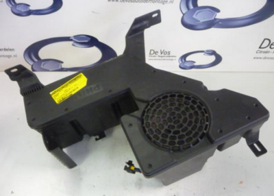

The official sub that comes with the Philips HiFi option is this:
It would go in the rear right compartment.
As for the left - that panel is not easily sourced second hand as it would only of been fitted on models with the CD changer / HiFi Amp (there were 2 locations it was fitted depending on other options - boot or glovebox)
So that part 11 you have your eye on is an eye watering £57. Ex. or £68.48 Inc. VAT new!
